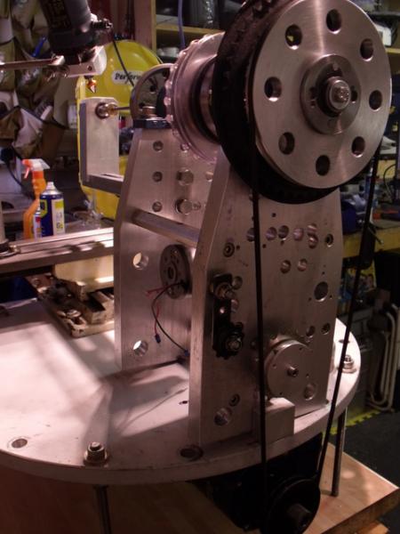

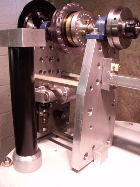

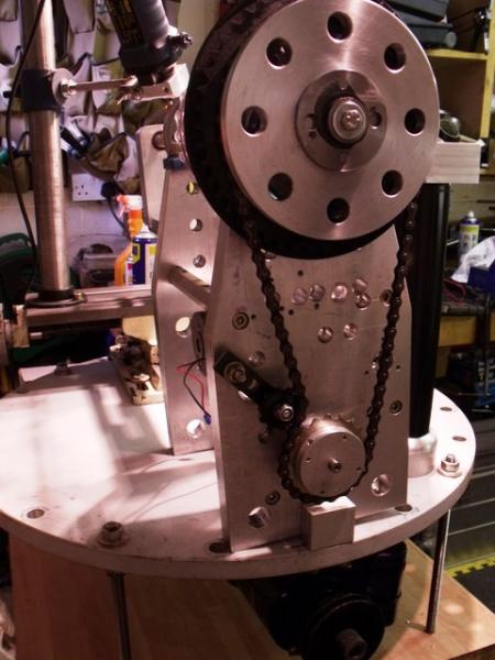

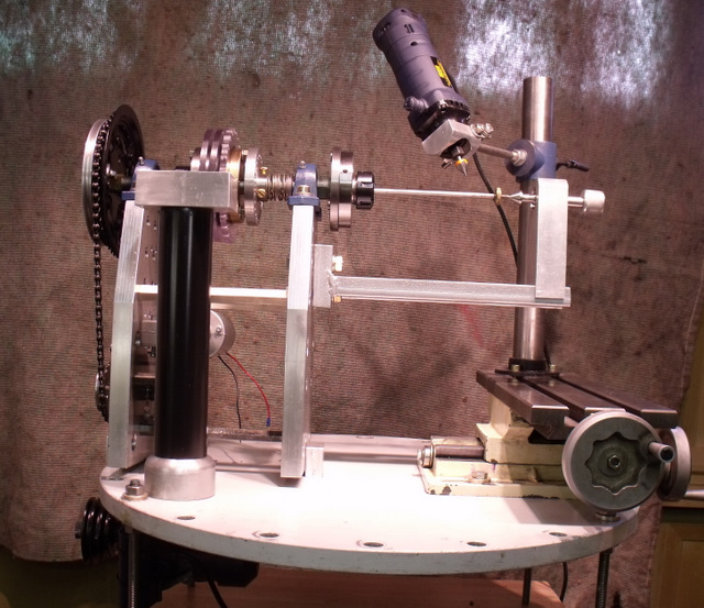

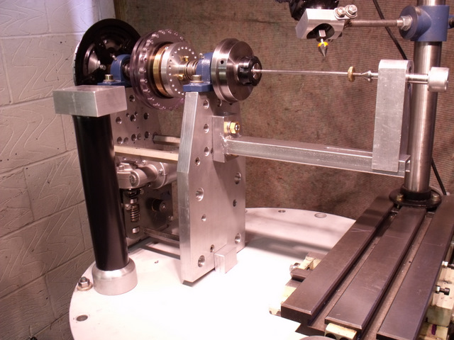

Wasn't sure where to put this....here or the tool forum, but as I made it I guess it can go here:wink:
Just over 4 years ago this month I joined IAP and while cruising through the library I came across some really cool vids by Ed Davidson ( YoYoSpin )
In one of his videos he was using a weird contraption that I found out was called a Rose Engine Lathe. I had never seen anything like it, but promised that it would be on my lengthy 'to-do' list.
So over the last few months I've been building this monstrosity:biggrin: from 99% scrap parts or tools I had already like the router and compound table.
This beast has two speeds from two motors. Under the table there is an old drill press motor that drives it at 1450 rpm. Between the sides of the machine is a small DC motor that drives a double worm gear arrangement to turn the spindle at a whopping 1 rpm :eek:( yep, one rev per minute! )
In these pics it is shown with my tailstock with a homemade spring loaded live centre. I threaded the spindle so it takes other chucks.
Still work to do making the 'rubbers'
The only parts I bought are the two collet chucks and the plumber block bearings. The rest comes from old electrical switchgear and even bits from an old bicycle.
I haven't actually used it yet, cos I'm having too much fun making the attachments for it. :rolleyes:
So thanks Mr Davidson!!!!:biggrin:

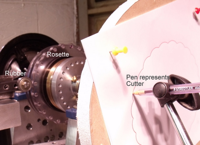

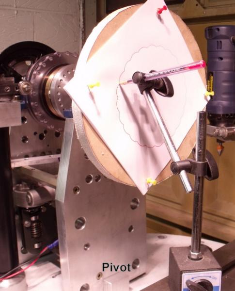

Many thanks for the comments and particularly for the 'welcome backs':wink:
I'm just wondering how much head scratching and swearing went into that. :biggrin: Any chance we can get some pics of it in action to get a better idea of how it works?
LOL, lots of swearing:biggrin:
The theory behind them is actually fairly simple. It gets EXTREMELY complicated, but the basics are straight forward. I honestly haven't even scratched the surface yet.
Like any lathe, it has a headstock. Instead of the headstock being solidly fixed to a bed, it has a pivot point at it's base.
The spindle is traditionally rotated slowly by hand or treadle. Many modern ones have motors with gearboxes to turn it slowly.
The spindle not only carries the workpiece in a chuck but it also has 'Rosettes' with specifically designed lumps and bumps around it's circumferance.
There is a solid pillar next to the headstock that has a 'rubber' mounted on it. It's called a rubber because it 'rubs' against the rosette.
As the spindle rotates with the rosette and the rubber touching, the headstock is forced to rock back and forth about the pivot point. Either a spring or a counterweight keeps it against the rubber.
Next, a cutter ( which is mounted on the compound table) is advanced into the workpiece in increments until the desired depth is attained.
From here on it can get infinitely complex, but a common feature is 'pumping'. Here the spindle not only rotates, but also moves in and out along it's own axis. Most often a rosette with bumps on it's side does this, but there are other methods. Mine will bump off a standard rosette.
The bumps on the rosette will push the spindle forward and a spring will push it back. You can see the springs on mine behind the rhs bearing block.

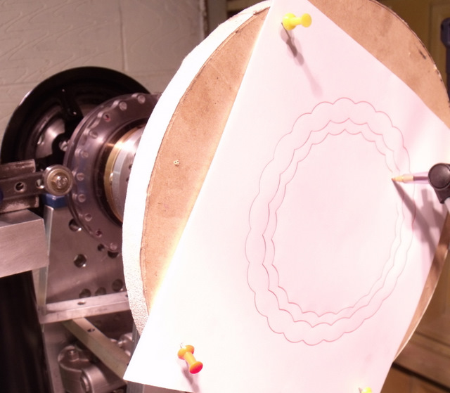

Sometimes when a pattern is being explored, before possibly ruining an expensive workpiece, a trial run is done on a piece of paper.
This actually needs some imagination as the line produced by the pen really only shows the very point of the cutter being used and of course doesn't show any depth. It gives you only a 2D image of what will be a 3D cut.
I clamped a roller bearing ( rubber) on my pillar just to show the principle.
Clear as mud?:confused::biggrin:
Edit in; I just added the third pic to show how the pattern reverses simply by moving the pen ( cutter ) to the opposite side of the workpiece. So what ever the movement caused by the rubber - rosette, that pattern will be inversed. I think this is the single biggest change that can be done without changing the shape of either the rubber or the rosette.
I'm only using a simple 24 bump rosette, but I believe that even this settup can give thousands and thousands of different patterns.:tongue:

Thanks to the pics and explanations I see how most everything goes together and works. One question about the little drive motor on the inside what does that one do? compared to the motor with the step pulley?
Phil, the little motor is the primary motor. This is the one that drives the spindle at about 1 rev/minute.
The big motor underneath ( you can see the step pulley ) will rarely be used and is used as a conventional lathe motor. The headstock is simply prevented from rocking while this motor runs. It will be used to 'true-up' the work piece prior to decoration using the smaller motor.
It really just allows me not to lose any accuracy by transferring the work from another lathe to this one.
The small DC motor spins at around 1250 rpm ( at 24Vdc), but has two worm gear reduction gears that give an output of 3 rpm. The ratio between the small cog and big cog is around 3:1 thus a final drive of 1 rpm. The torque is phenomenal !!! So to take advantage of this I used the bike chain and cogs. I found that using round rubber belts, to ovecome slipage and 'springyness' I needed to make the belt so tight that it refused to 'pump'. With the chain, I only need to take up the slack gently and it still pumps beautifully.
Of course, to stop the chain de-railing while pumping, I hand to keep the cogs as far apart as possible. They are about 350mm between centres now. This is why there are more holes in that side of the frame than in a Swiss cheese. :redface: No planned engineering in my shop!!! Everything is done by trial, error, blue air and coffee:biggrin:
If the cutter ( so far only a router in my case ) tends to dwell on the workpiece too long then of course it may just burn a finished cut, so I will put a variable resistor in with the motor and up the supply volts to 48Vdc and then I will have variable speed range of between 1 and 3 rpm.
