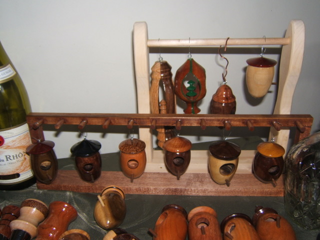

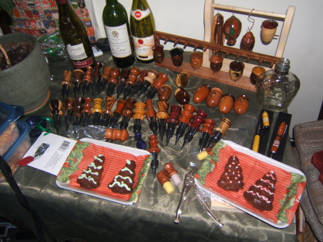

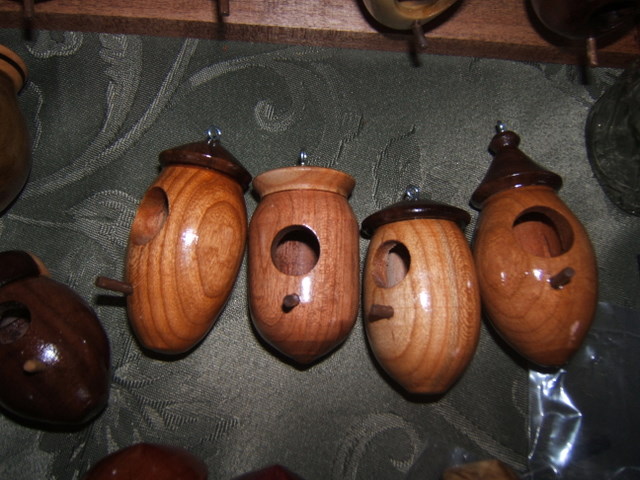

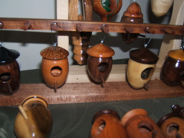

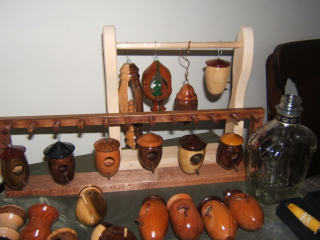

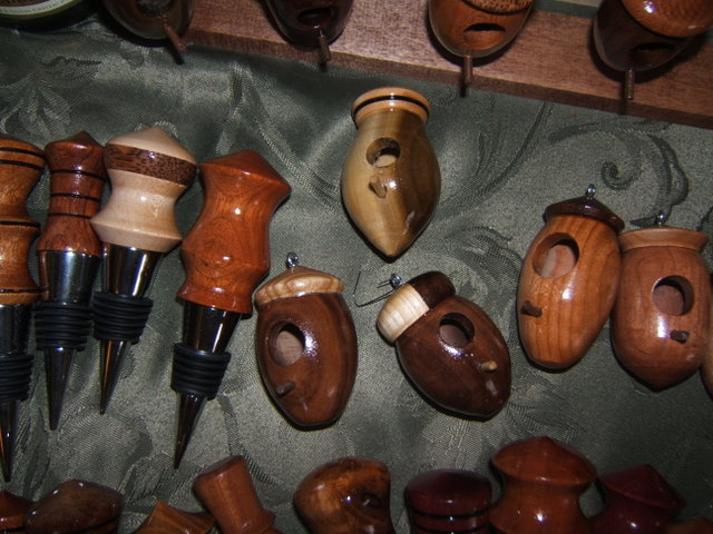

Since Kludge had posted a couple of acorns, I decided to try my hand at 'em too...I quite like them, and they weren't so bad to make one I figured out a process that doesn't require removing anything from the lathe...

Sweet Freaking Mercy!! You went on a binge! :) I especially like the Cherry and Walnut ones! Very slick!
So, do tell. What's your methodology? I love saving steps!

Drill chuck and forstner bits, Peter - I can't believe i tried to hollow out the first one with a bowl gouge... :)
Once it's hollow, the rest is easy! I found that a sharp forstner to make the bird-entry-hole is important too - a few wanderers resulted in a lot of extra work!
