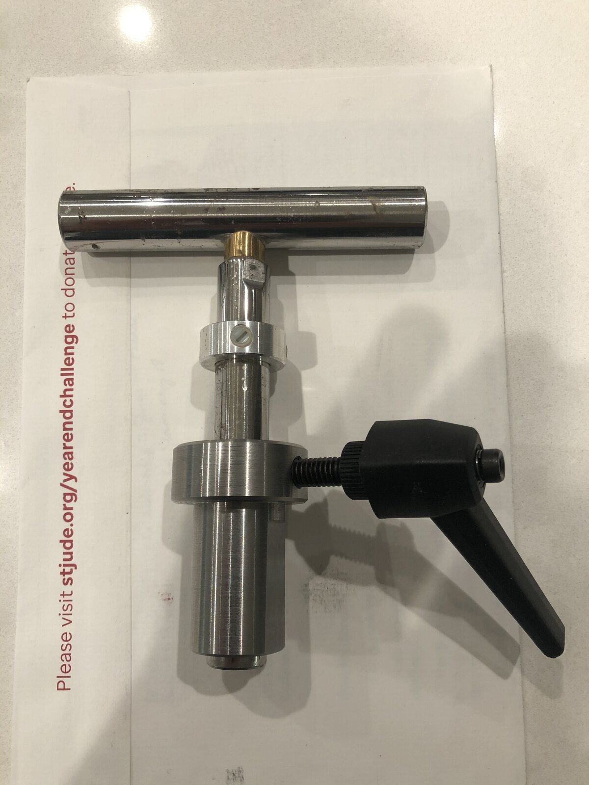

I'm working with Rick Herrell on a possible adapter that would work with the PM 2014 and a 5/8 tool post. I'll let you know how it works out if you still have your 5/8 tool posts.

@SteveG sound advice and makes sense when you are turning heavy stuff. I did order new 1" tool posts and matching rest for the beefier turning I plan on doing.
Additionally in my case I have quite a few custom tool rests specifically for pen turning and kitless projects. So I wanted a cost effective way to continue to use them.

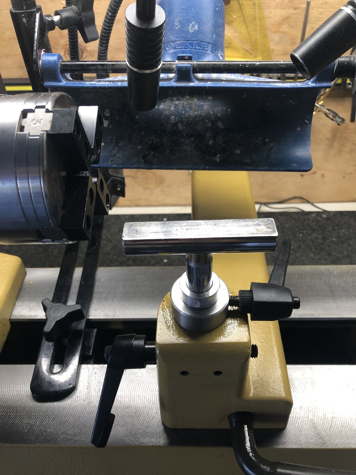

New 5/8" to 1" adapter arrived.

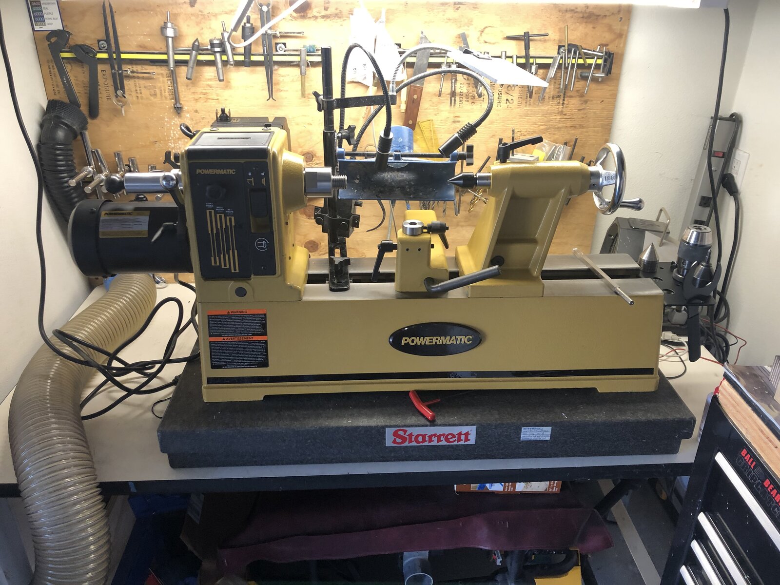

The new powermattic pm 2014 arrived.

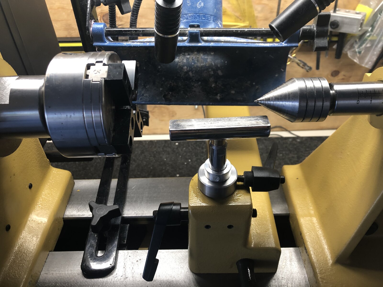

I dropped in the adapter I designed built by @rherrell and look at that perfect fit. Thanks so much Rick!!!!!!

Rob, I have been looking at the PM 2014 for my next lathe. Please let us know what you think about it. Could you please measure the footprint (just the base on your machinist surface) the description said 52" total, I assume that counts the motor. I may not need to make a new turning station. Thanks!
base depth ~11.5"
base width ~32.5" + motor overhang on left side 8.5" (you can slide it to the right, but that will decrease your center point distance)
height from base to center line is ~ 14.5"
