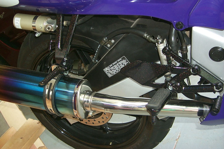

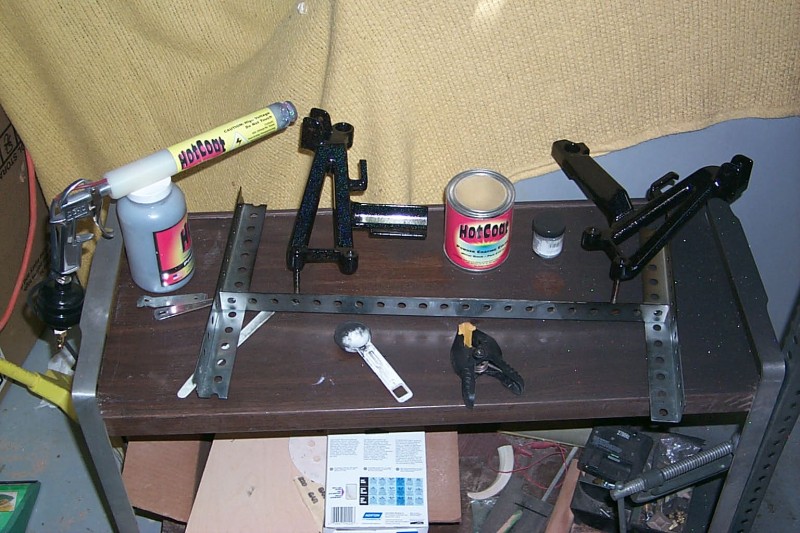

I have my own powder coating setup, entry level from Eastwood. I have coated hundreds of metal things, in many colors including clear, gold, red, black, maroon...
For metal coating you need 300-350 degrees. I have heard about powders that can be used on woods, obviously need to be cooked at lower temps.
Sorry, I guess I am not much help...
Attaching pics of the gun, and some black w/prismatic additive.
Warning: Powder coating is as addictive as pen making.
