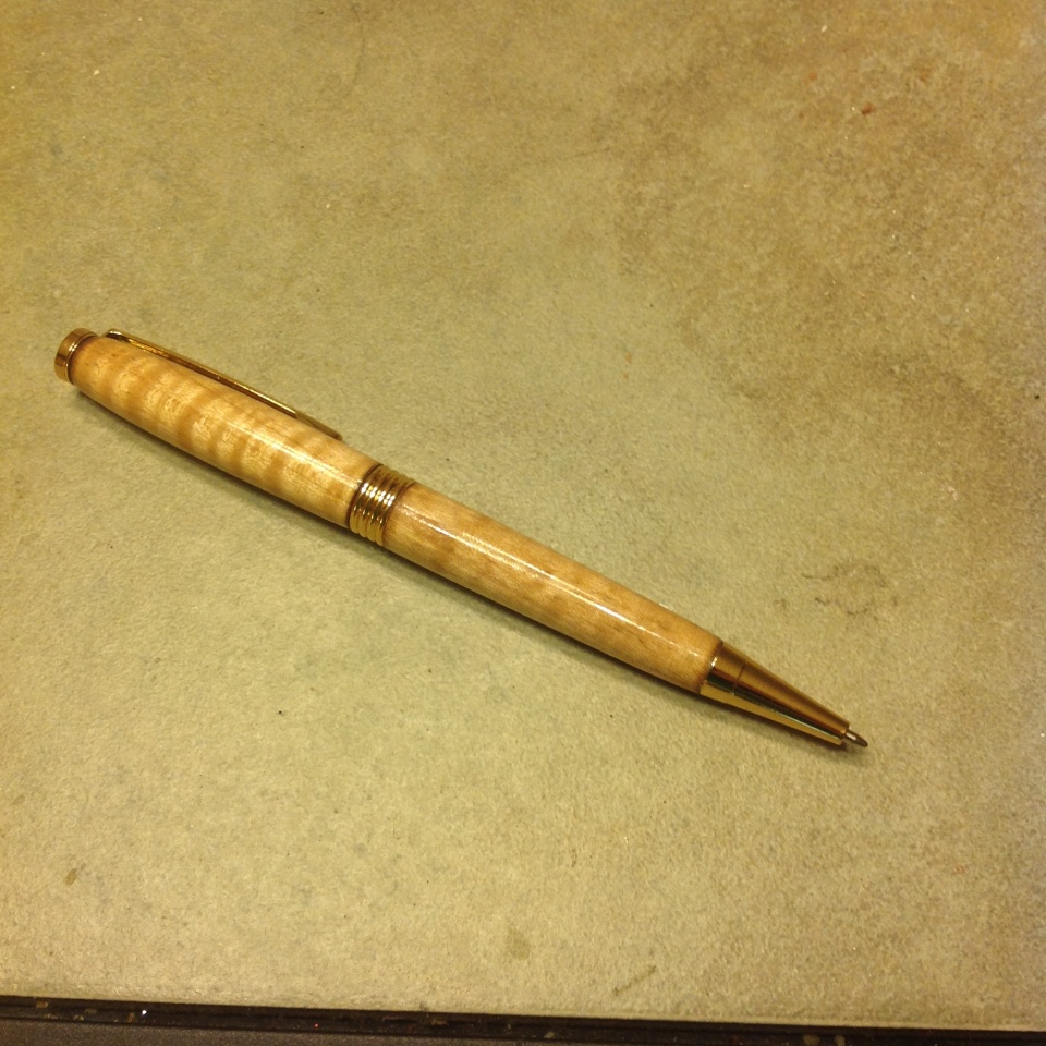

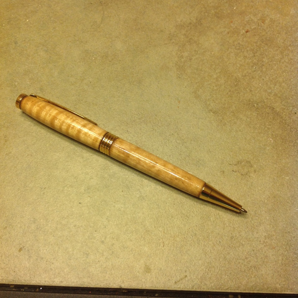

Still confused as to the best method for noticeable "pop"....and I think the all over colored dyes are just not for me. I want the classic curl to be dark and the rest natural. What I'm showing here went through several phases and I essentially got it back down to a little BLO and some transtint vintage maple dye. Its ok. I know the end grain soaks up so much that you get a dark "ring around the collar" look.
Any suggestions? I just would rather the pen be darker I think?

Aniline dye in a medium brown (like a honey maple) and lightly sanding to increase the contrast works. Film coatings will bring out the light reflection for apparent depth.
If you want a little darker look, apply walnut stain and than wipe off as much as you can. This will give you a deep honey color and pop the grain. Jim S
Richard, I used to make muzzleloaders and made the stocks from curly and tiger maple. The "old time" way of getting a warm, reddish-brown finish that makes the curl/tiger stripes pop out, is a solution called "Aquafortis." One of the sources is a place called "Muzzleloader Builder's Supply (Muzzleloader Builder's Supply Home Page).
I first saw this used in the gunsmith's shop at Williamsburg, VA and it will just blow you away. If you need more info or want to discuss, please PM me.
