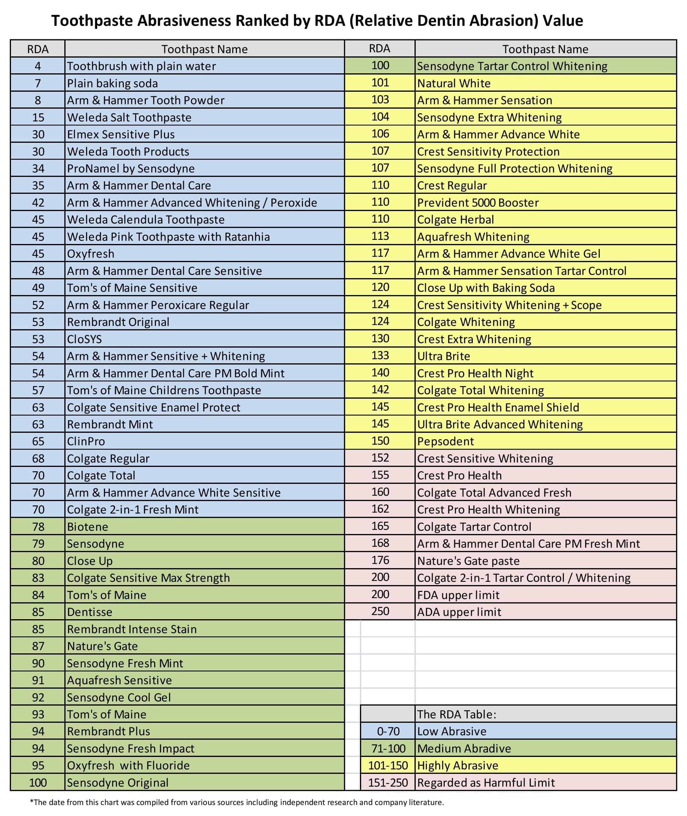

Anyone ever tried it? Seems the pumice is very fine but not sure how it measures to MM grits or the polishes on the market. Thanks.
Somewhere there's a dental chart with the relative "grit" per toothpaste brand.
Not to rock the boat....but why toothpaste?....the plastic polishes have to be cheaper.
