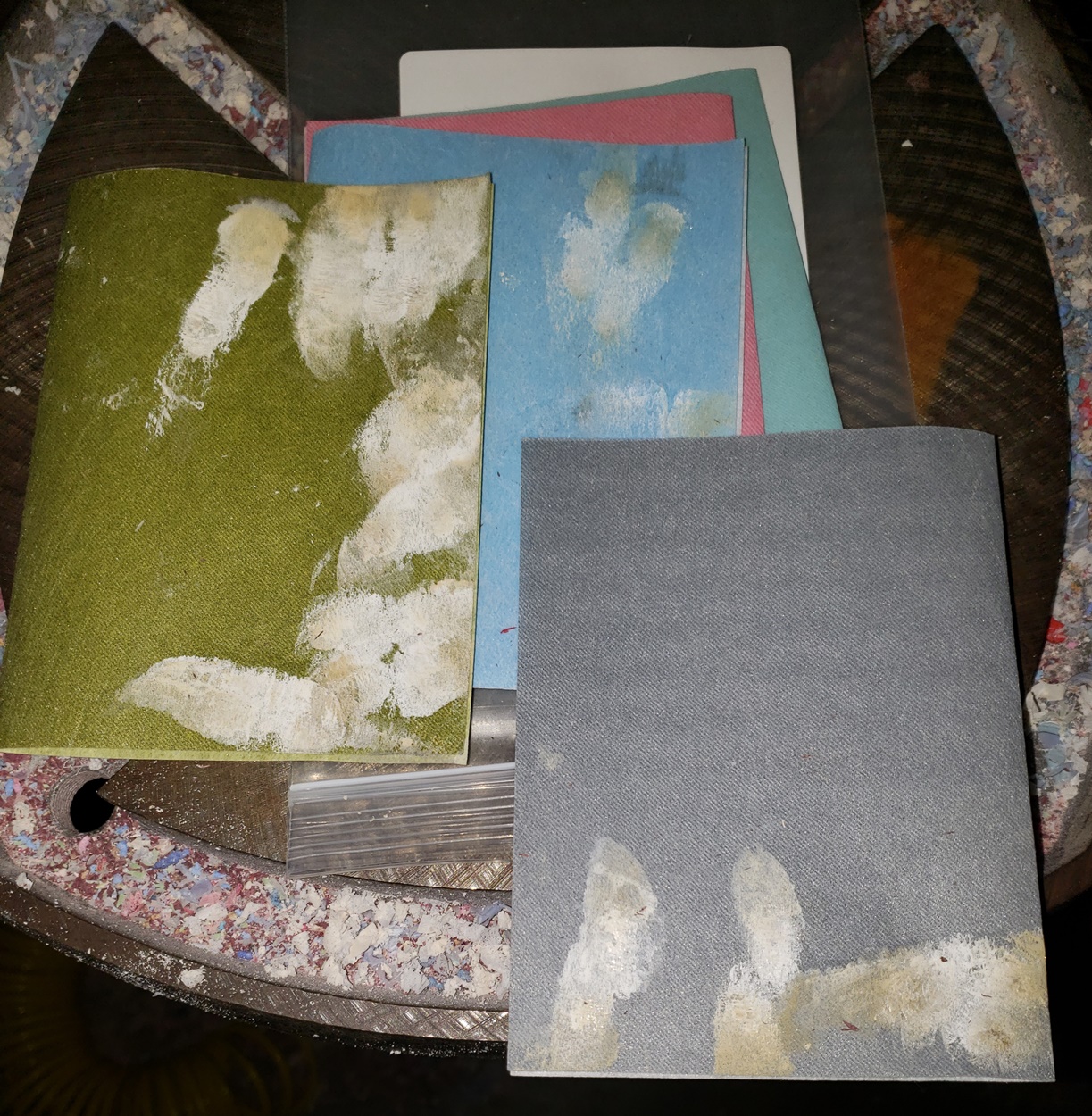

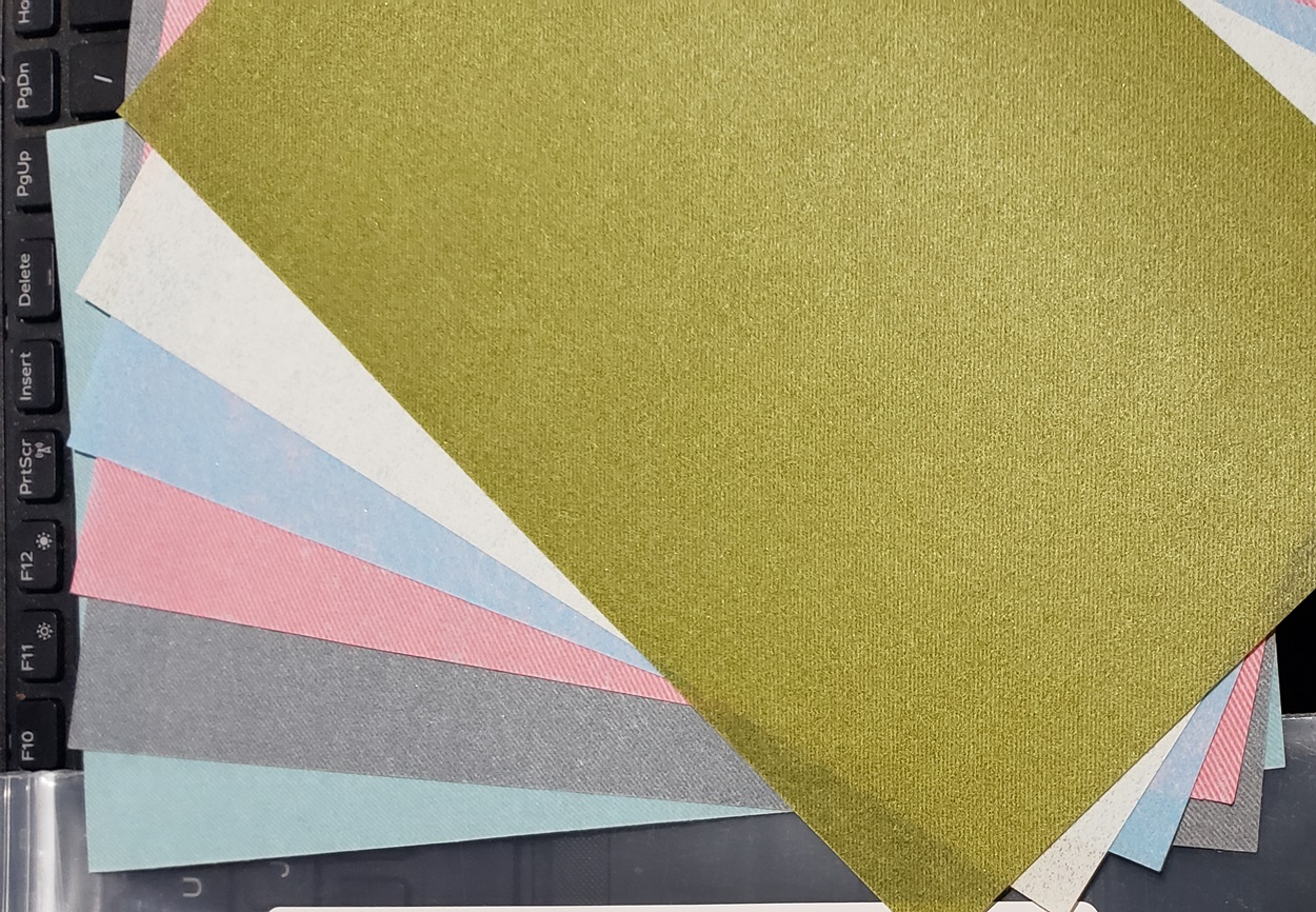

My pack of 6 grades arrived yesterday; it has a label stating the grits are 400 / 600 / 1,200 / 4,000 / 6,000 / 8,000 but doesn't say which measuring system they use. (Micromesh finest grit claims to be 12,000 - but could be on a totally different scale.)
I might get to take some for a test drive this weekend.
qquake
Feb 8, 2004
5,014
Northern California

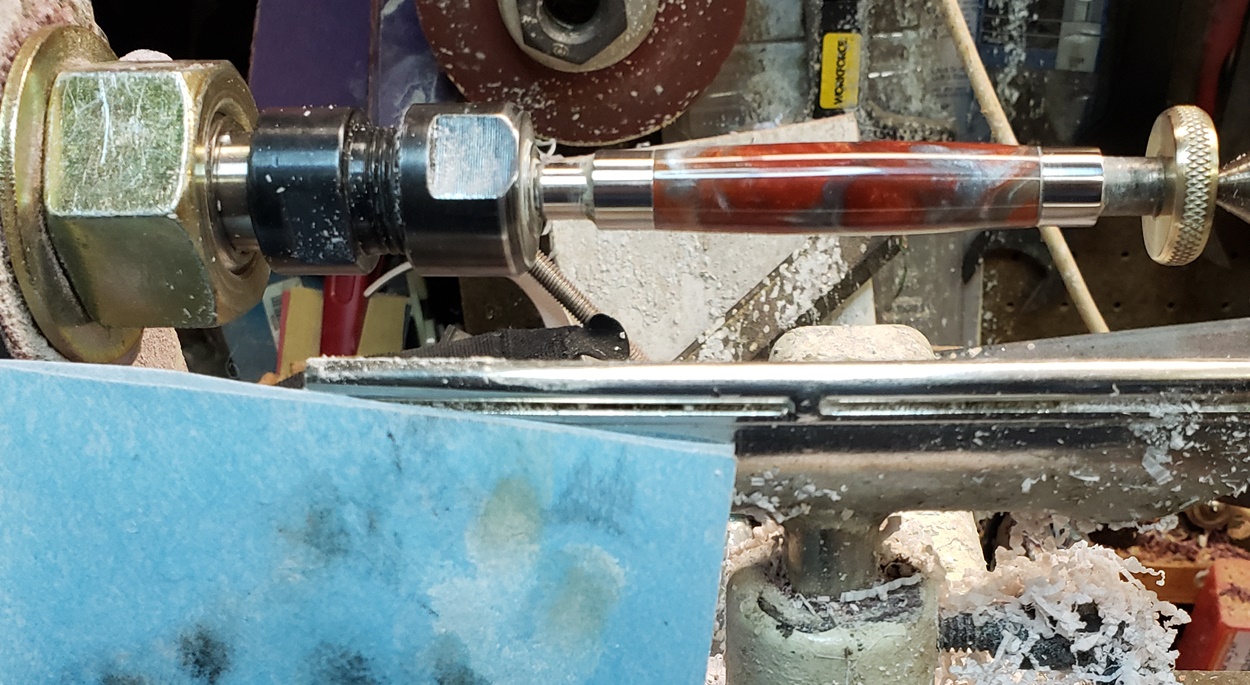

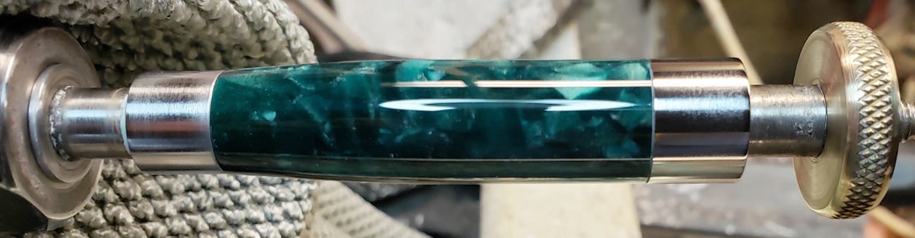

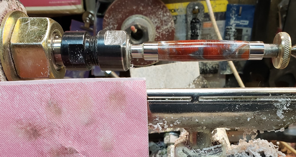

I got mine today, but the colors don't seem to match up. I can't tell which is which, at least not the finer grades.

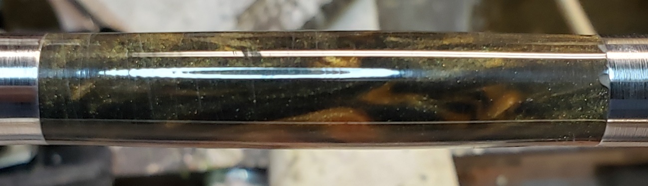

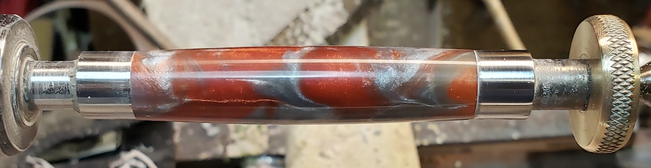

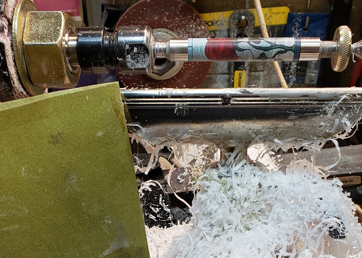

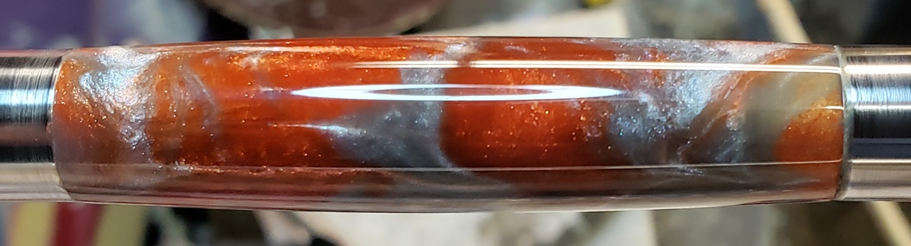

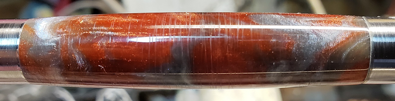

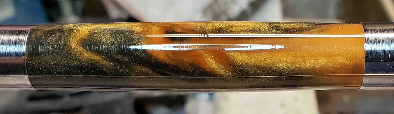

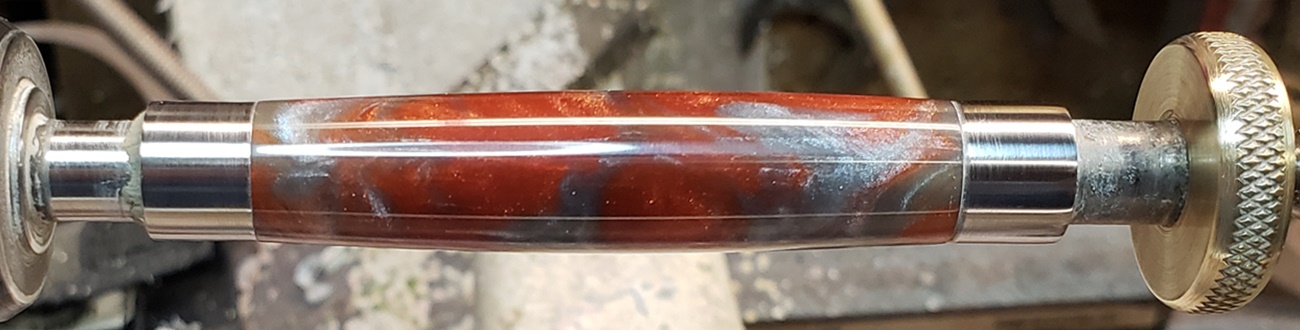

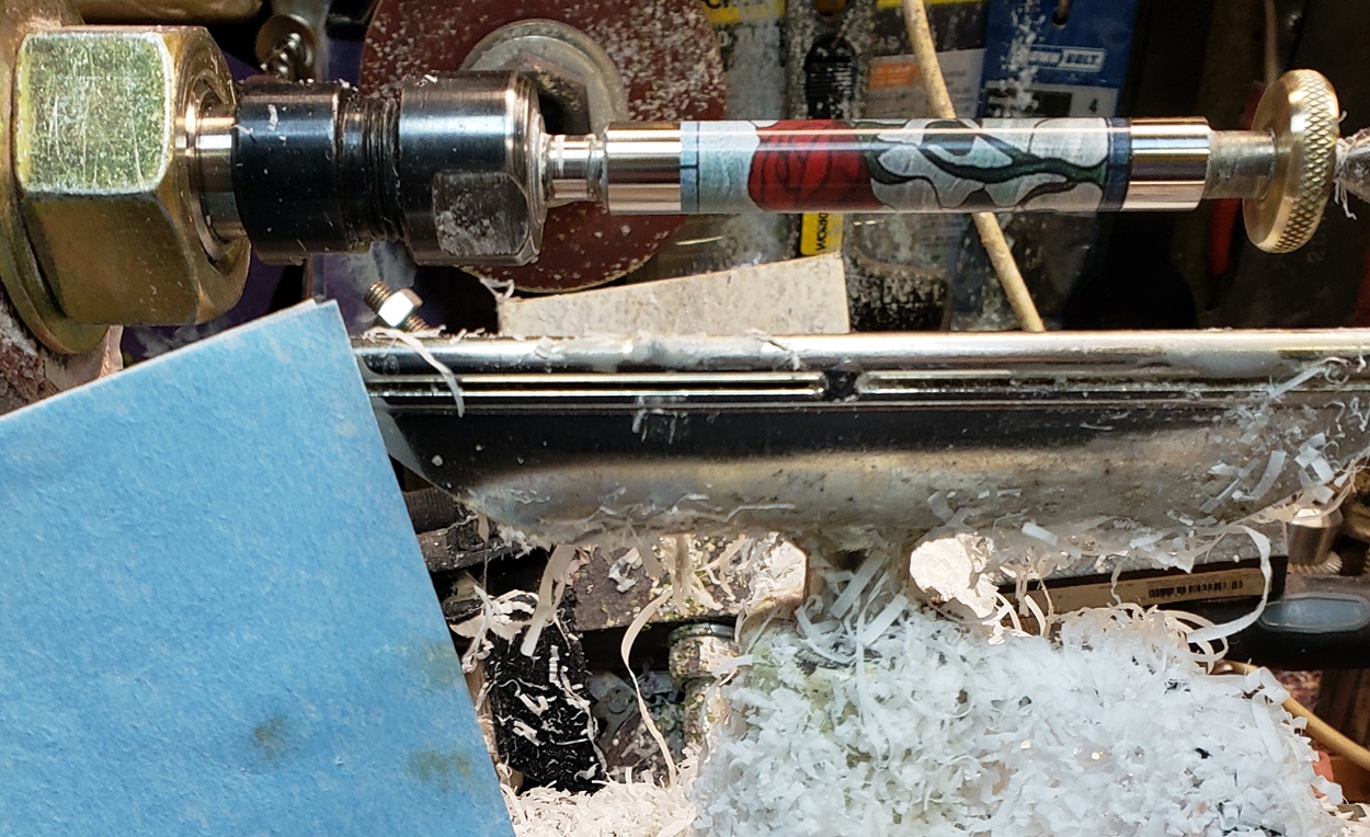

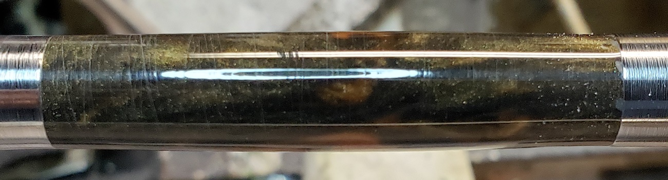

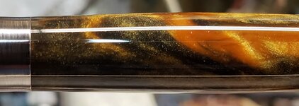

I did a quick test with the Tri-M-Ite. I sanded the body with 150 grit dry, then used all six grades of the polishing paper wet. It actually worked better than I expected. I realize I didn't get some of the bad scratches out, I was in a hurry. I just wanted to see if it has promise. I'll try again with Micro-Mesh later to compare.
TonyL
Mar 9, 2014
8,915
Georgia
Much better. Watch the ends (near the bushings). I find that I have to pay particular attention to the ends because of their curve away from the sand paper. Many times the body of the pen appears scratch-free, but when focus my loupe on the ends, I can kick myself for not doing a better sanding job.

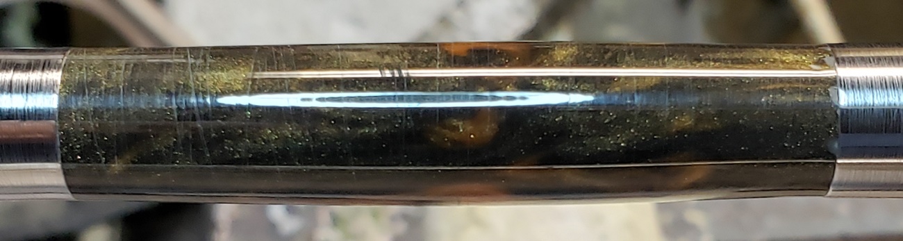

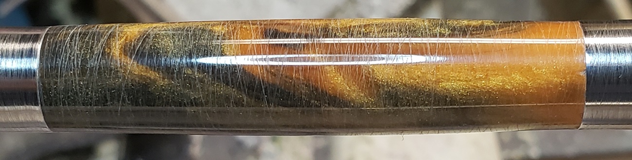

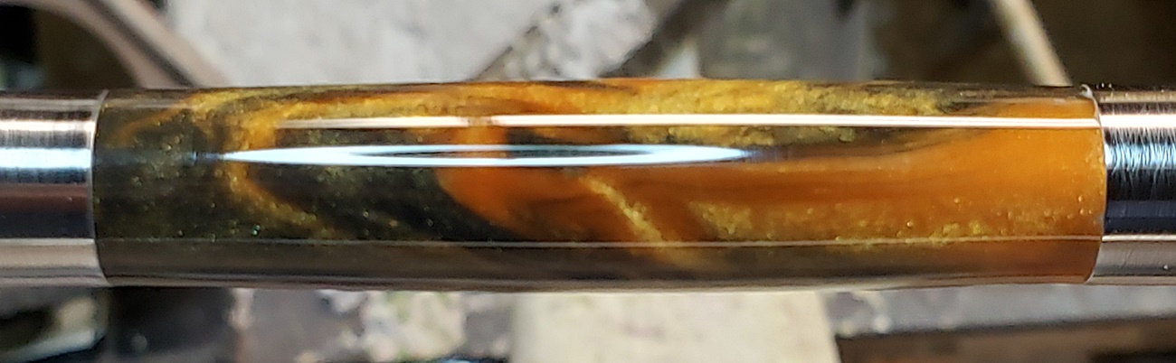

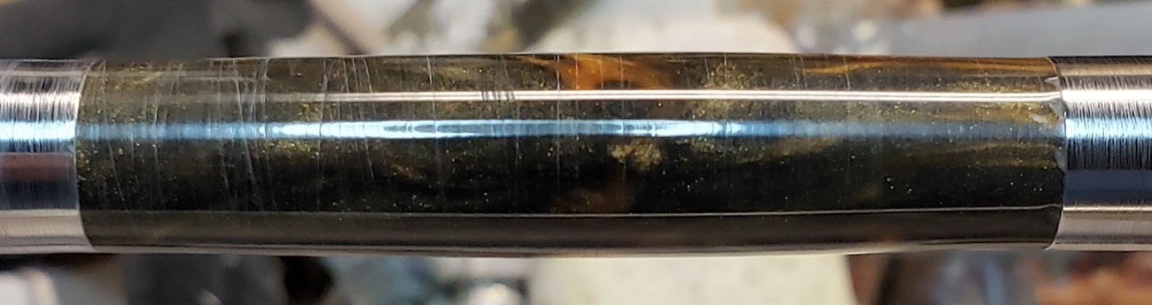

Looks like I need new Micro Mesh. This is after all 9 grades.

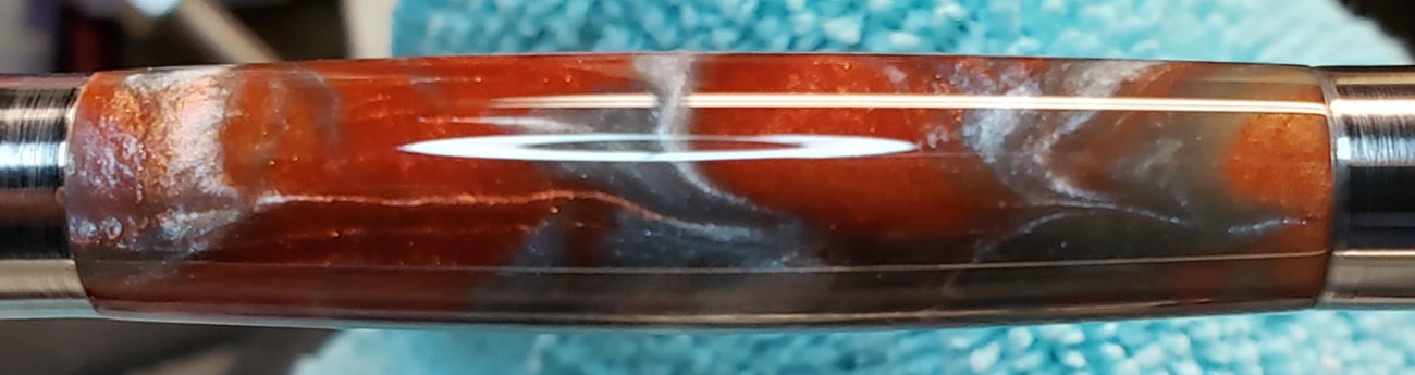

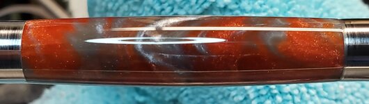

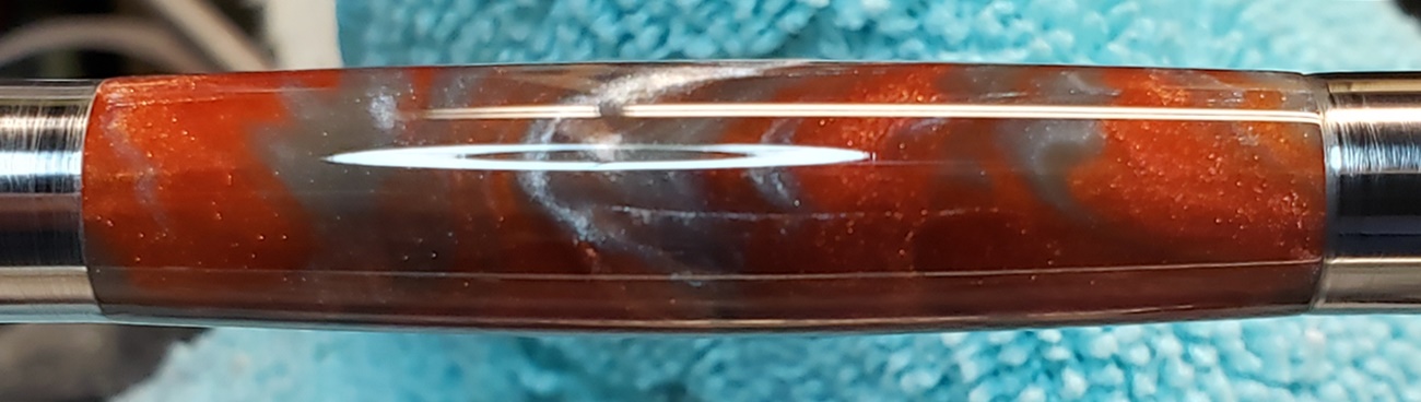

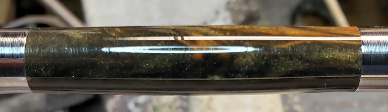

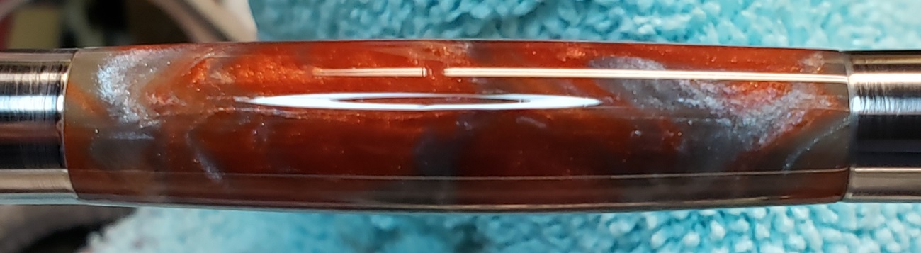

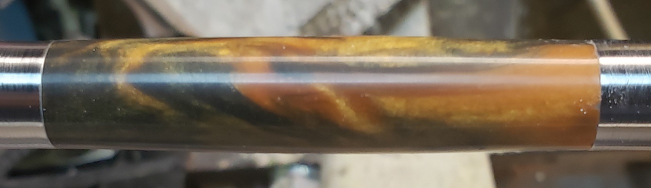

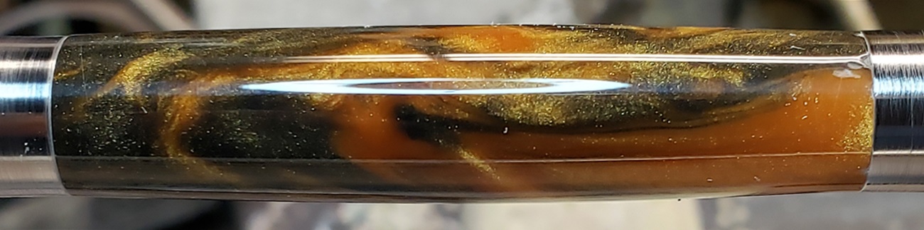

So I decided to try all 6 grades of the polishing paper. Worked pretty good. I just realized there are only five photos. I obviously missed one.

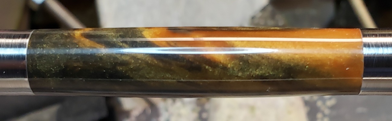

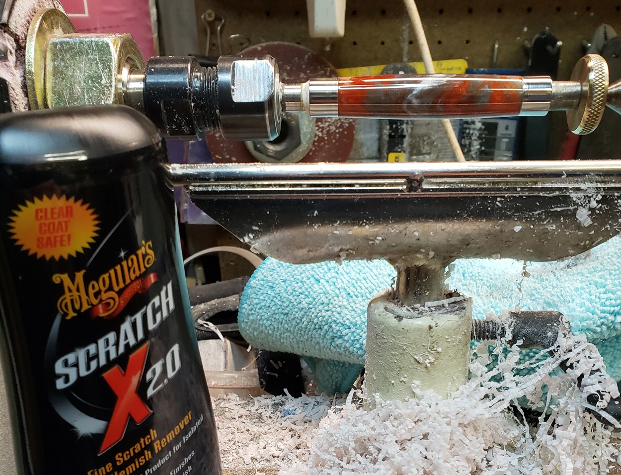

I was more careful with the ends this time. This is after ScratchX.

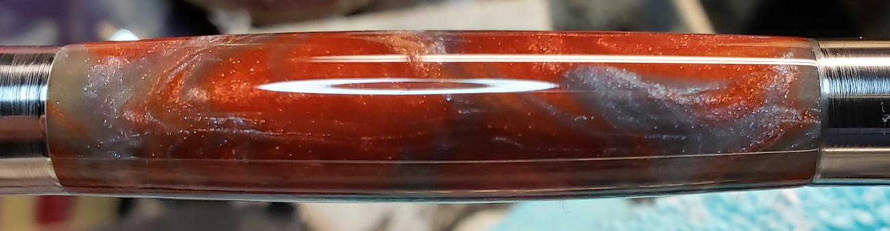

I tried again with some new Micro Mesh. The polishing paper obviously did a better job at removing the heavy scratches.

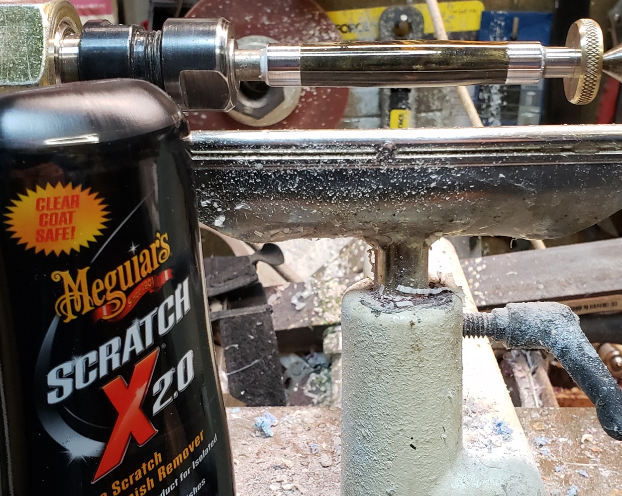

And just out of curiosity, I tried the ScratchX. It made it a little better, but didn't take out the heavy scratches. I didn't think it would, but it was worth a shot.

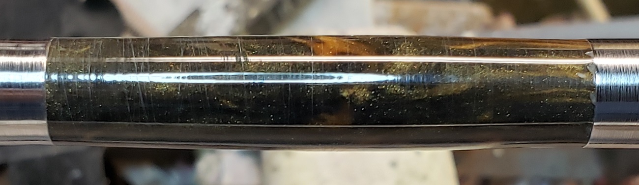

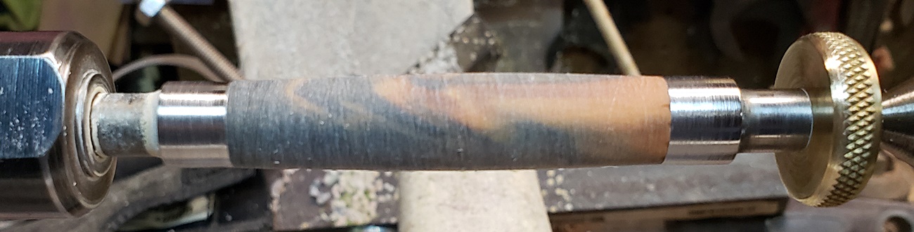

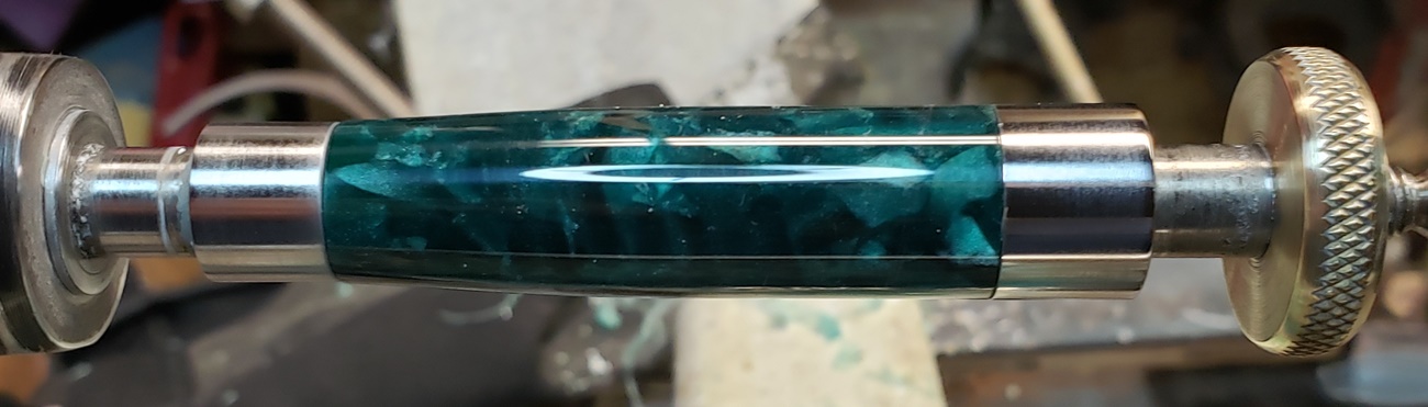

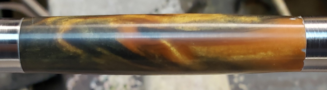

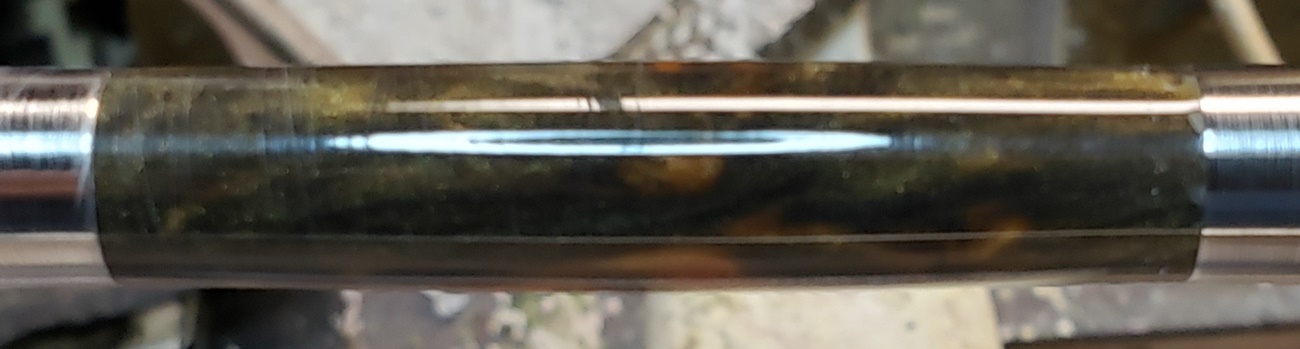

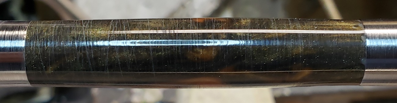

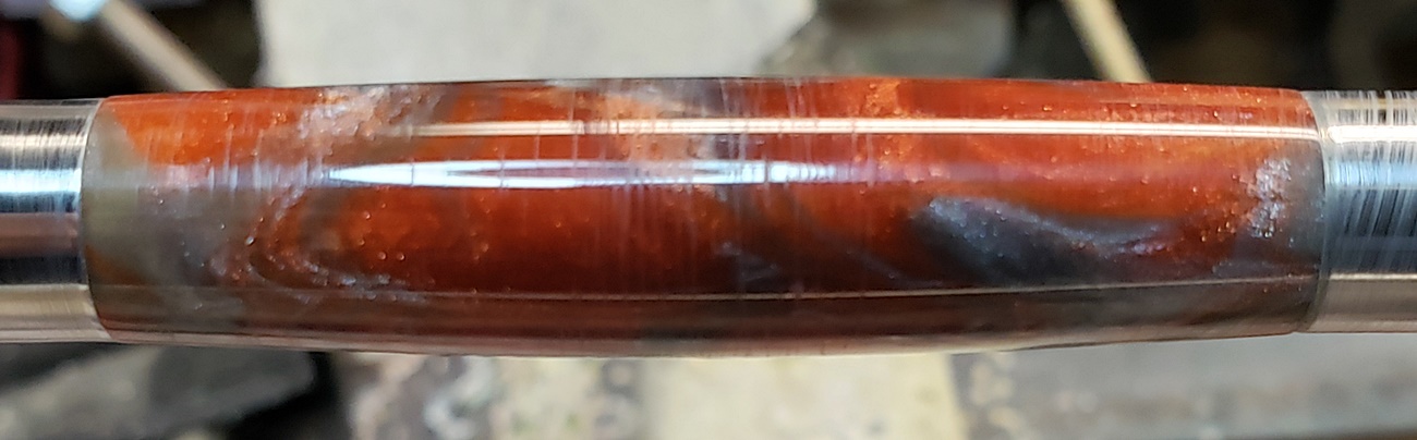

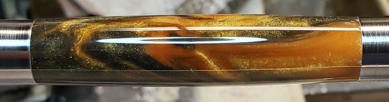

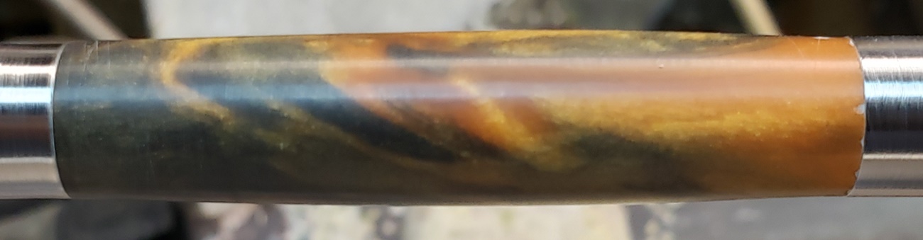

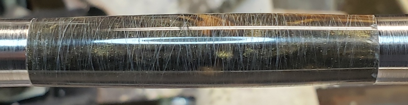

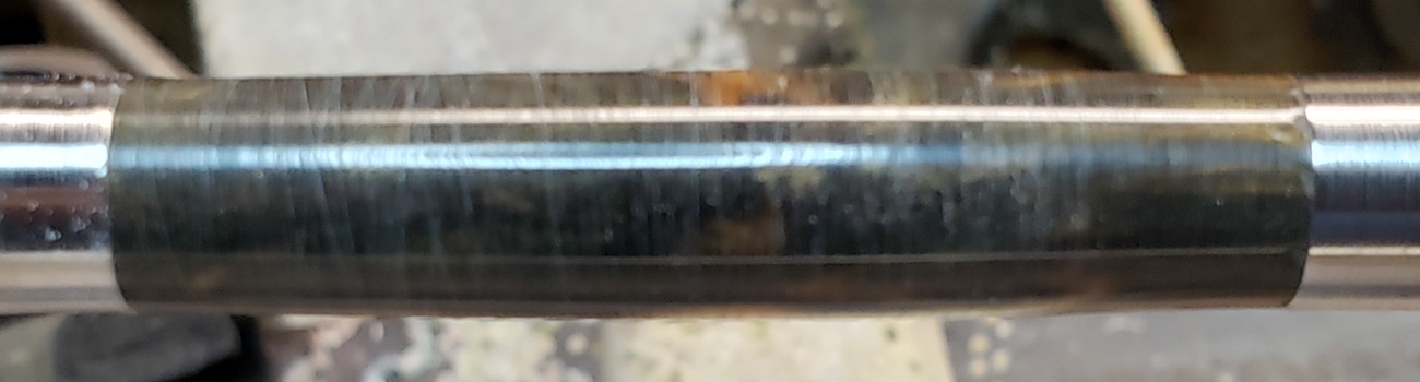

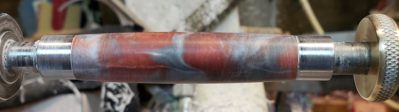

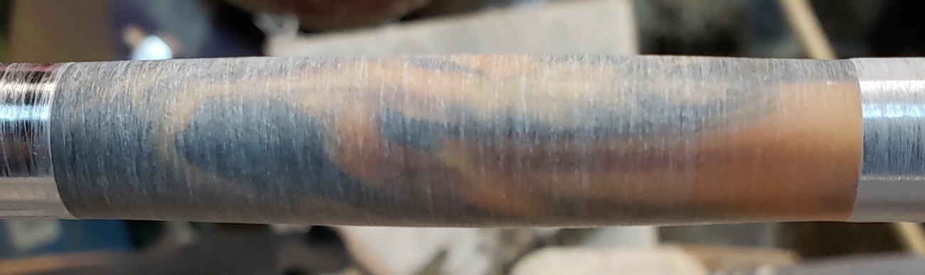

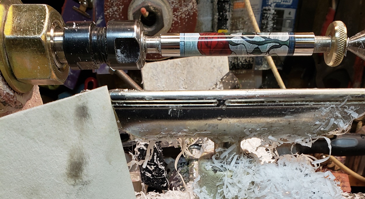

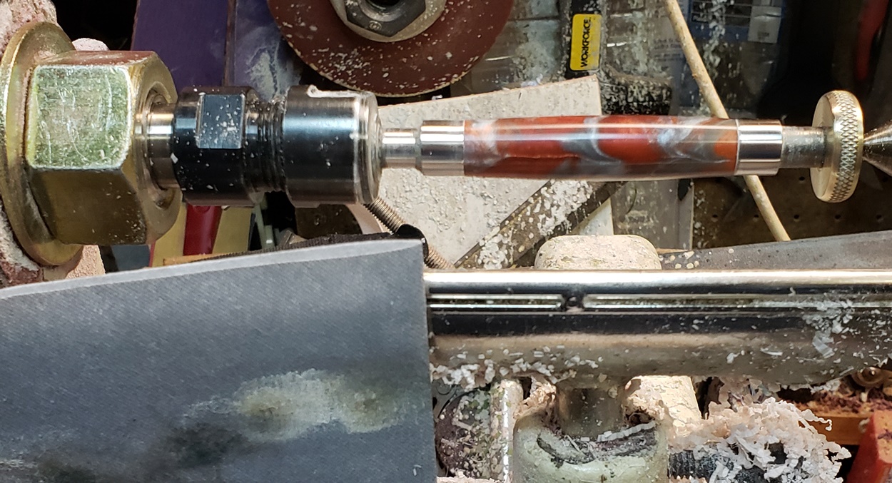

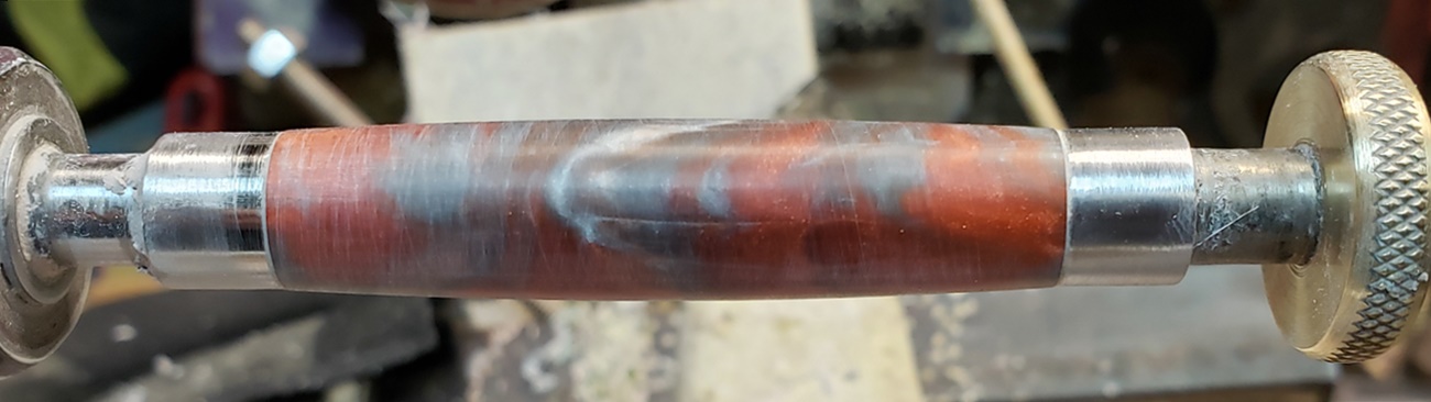

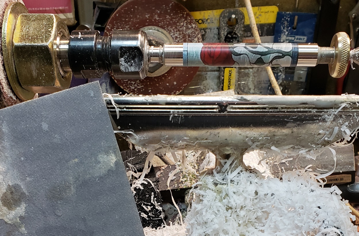

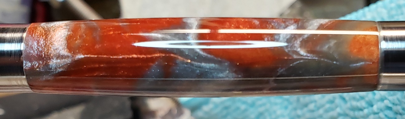

I don't know what happened. This is a blank from Classic Nib. Everything was looking good, until I got to the pink. These aren't scratches, it's something on the surface. I used water, but maybe not enough? Anybody ever seen this before?
duncsuss
Jun 29, 2012
2,160
Wilmington, MA
My best guess is it overheated and the fine powder that the paper was taking off the blank melted and fused back onto it. Slower and wetter would be my recommendation.
I got a similar thing once when I was buffing a Cebloplast pen barrel, fortunately there was enough wall thickness that I could get rid of the streaks by going all the way back to 120 grit and doing the whole process over.
TonyL
Mar 9, 2014
8,915
Georgia
I have done the same. When i experience this, i kick it back a few grits (the bck to the finer grits), slow the rpms to 600 to 800 (my usual settings) and make sure i am letting the sp do the work. excellent progress.

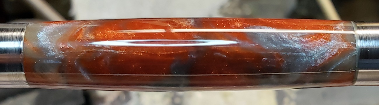

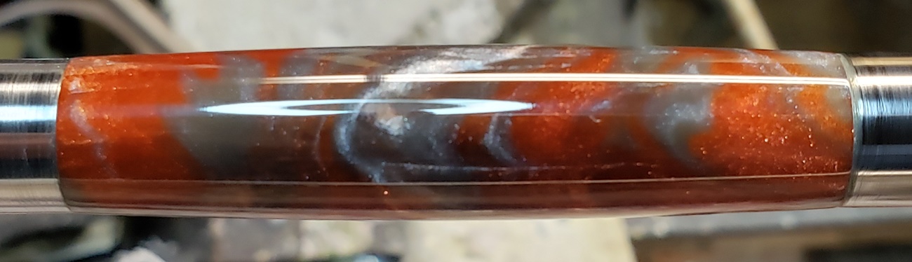

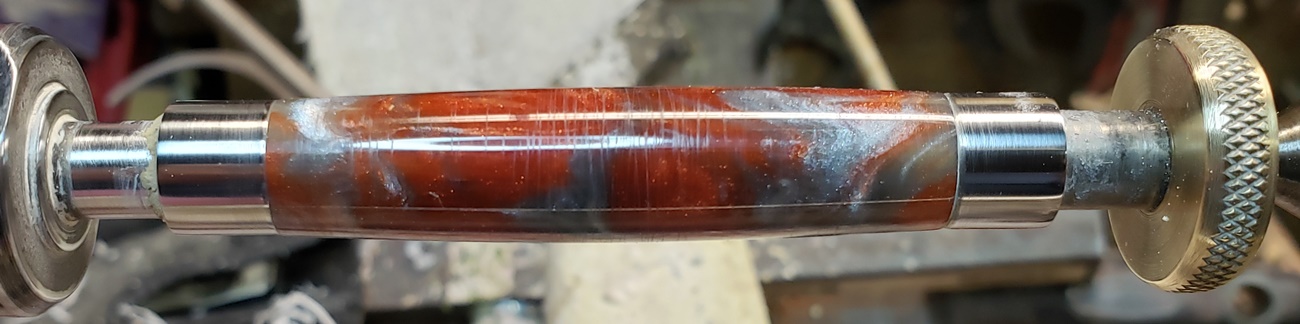

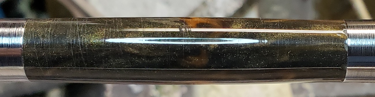

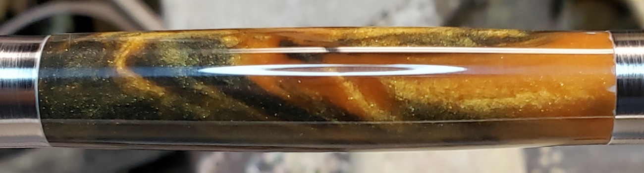

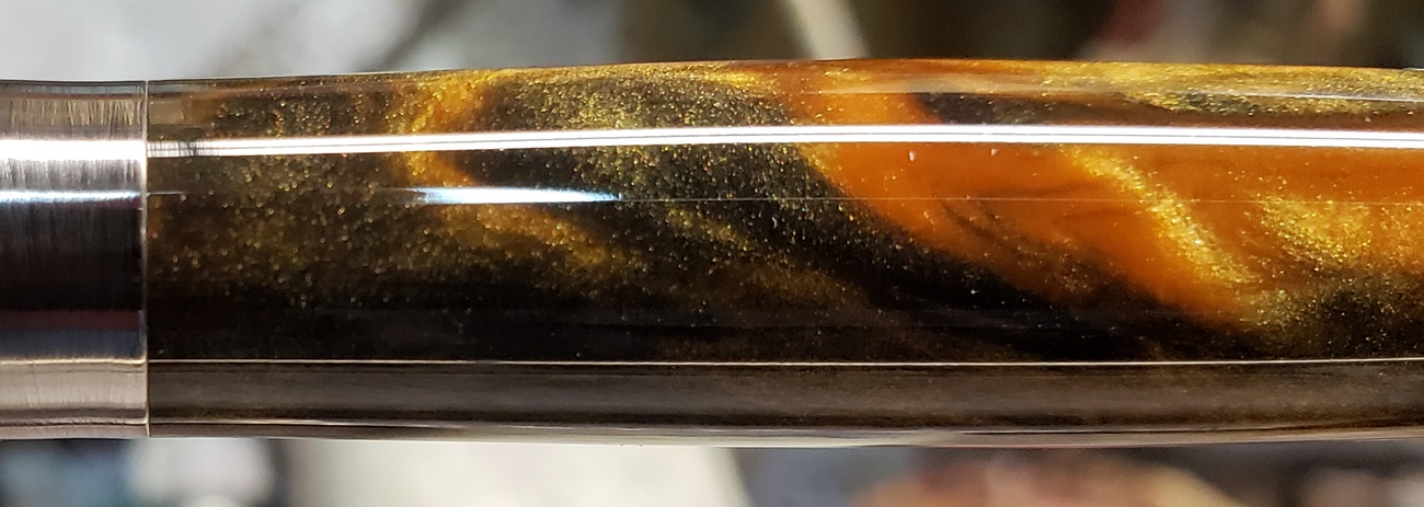

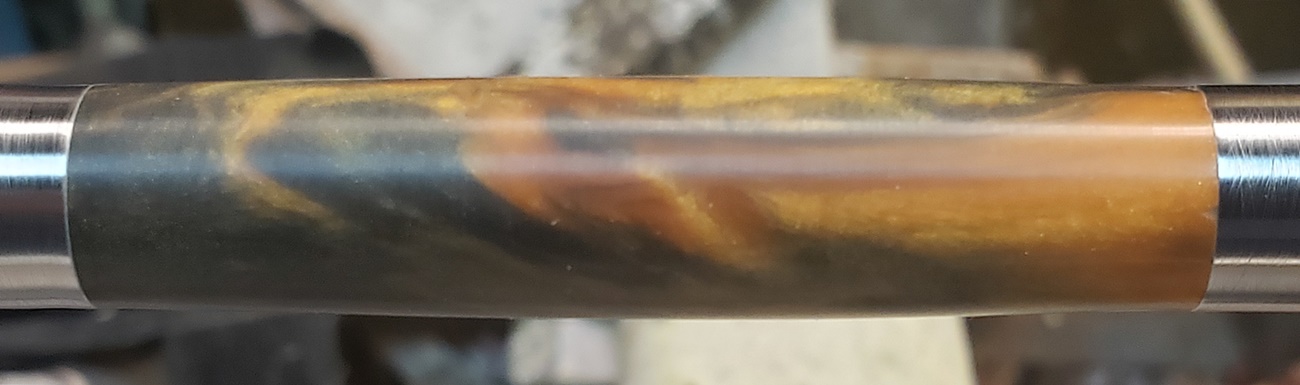

I ran through all six grades again, this time making sure it was plenty wet. What a difference! I really do think this is better than Micro Mesh.

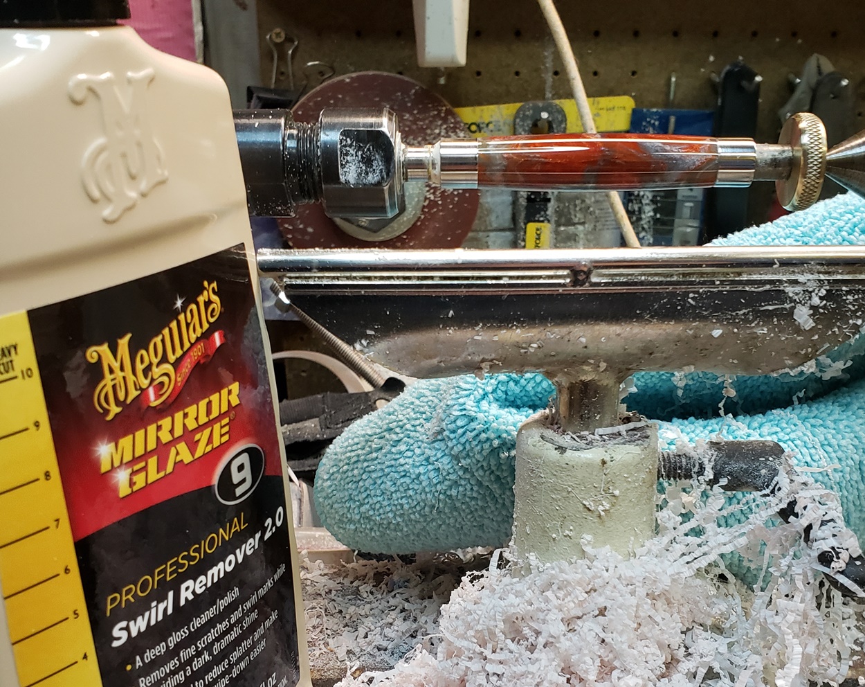

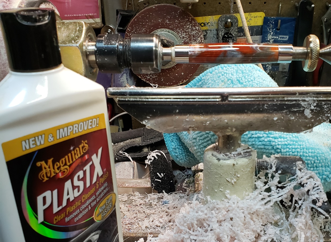

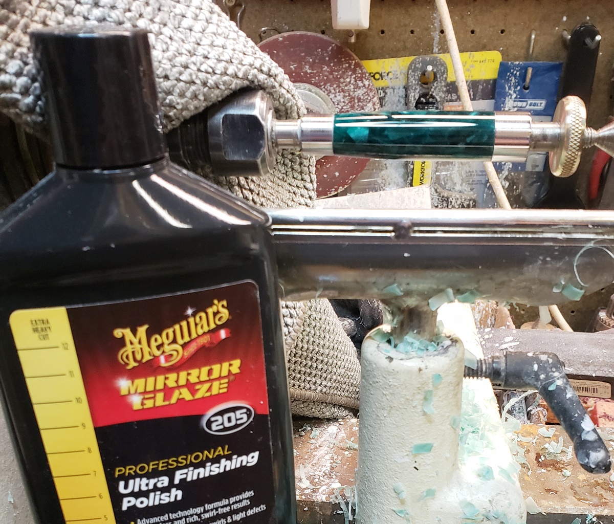

I polished it with Meguiar's 105, Swirl Remover, ScratchX, PlastX, and 205. I don't think I can see a difference. I think I agree with TonyL, 105 and 205 would have been enough.

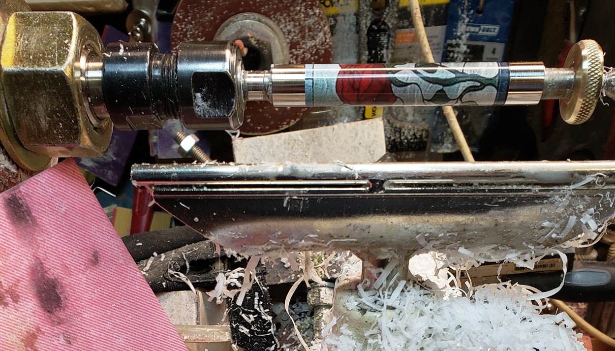

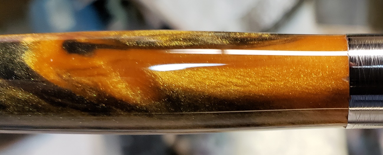

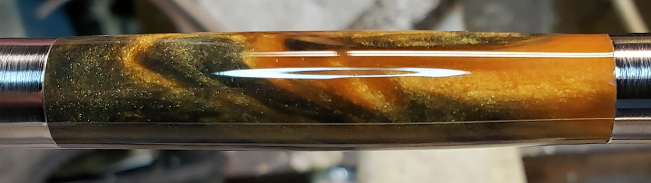

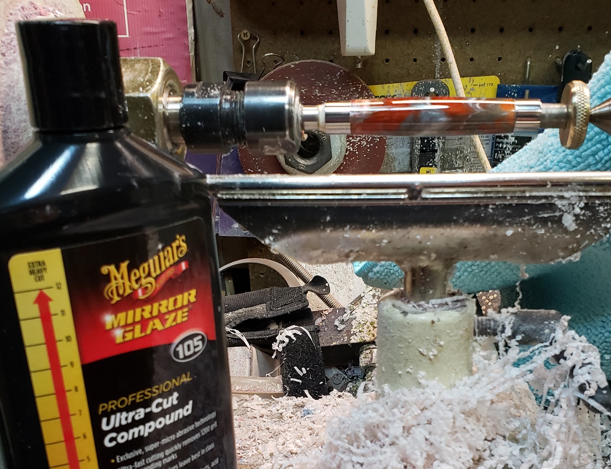

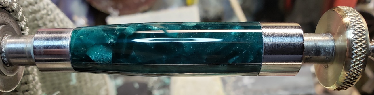

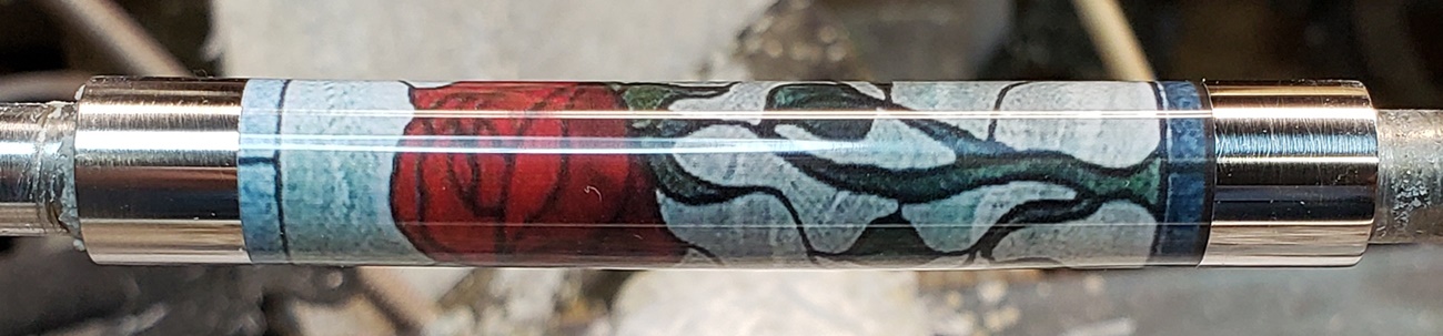

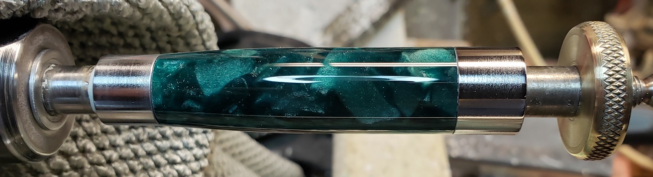

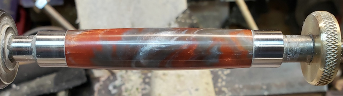

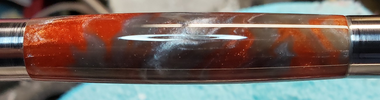

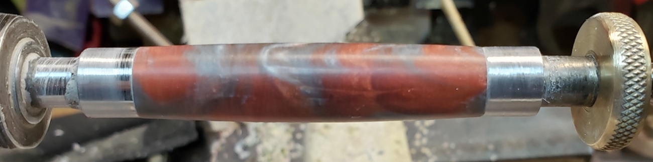

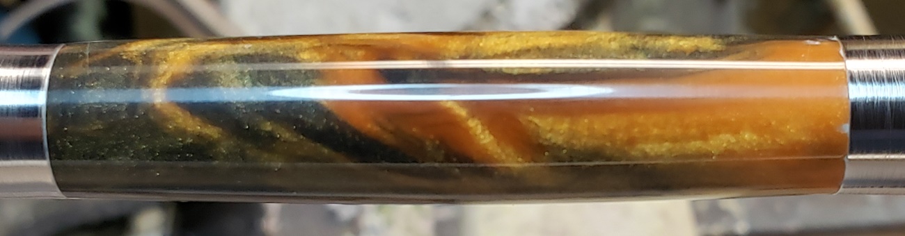

I tried the paper on a different blank. Very happy with the results.

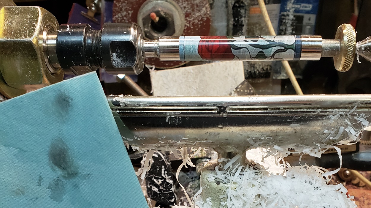

duncsuss
Jun 29, 2012
2,160
Wilmington, MA
Hi Duncan. What do you think of it?

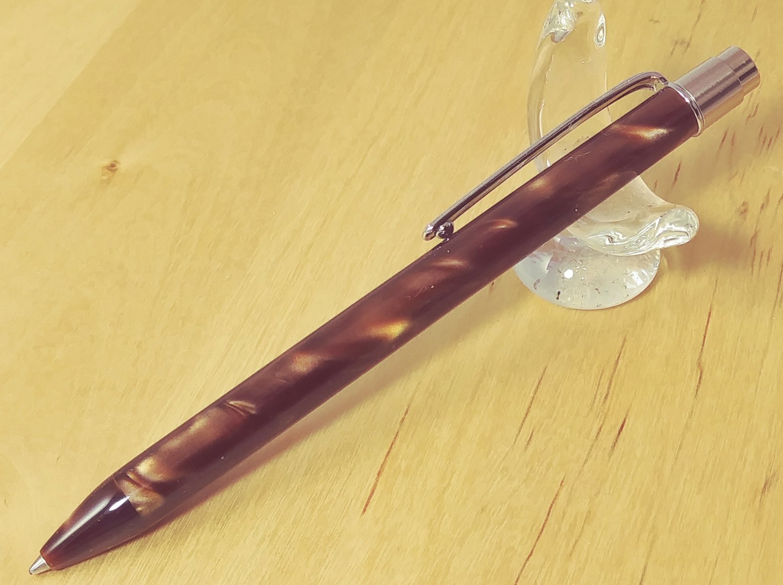

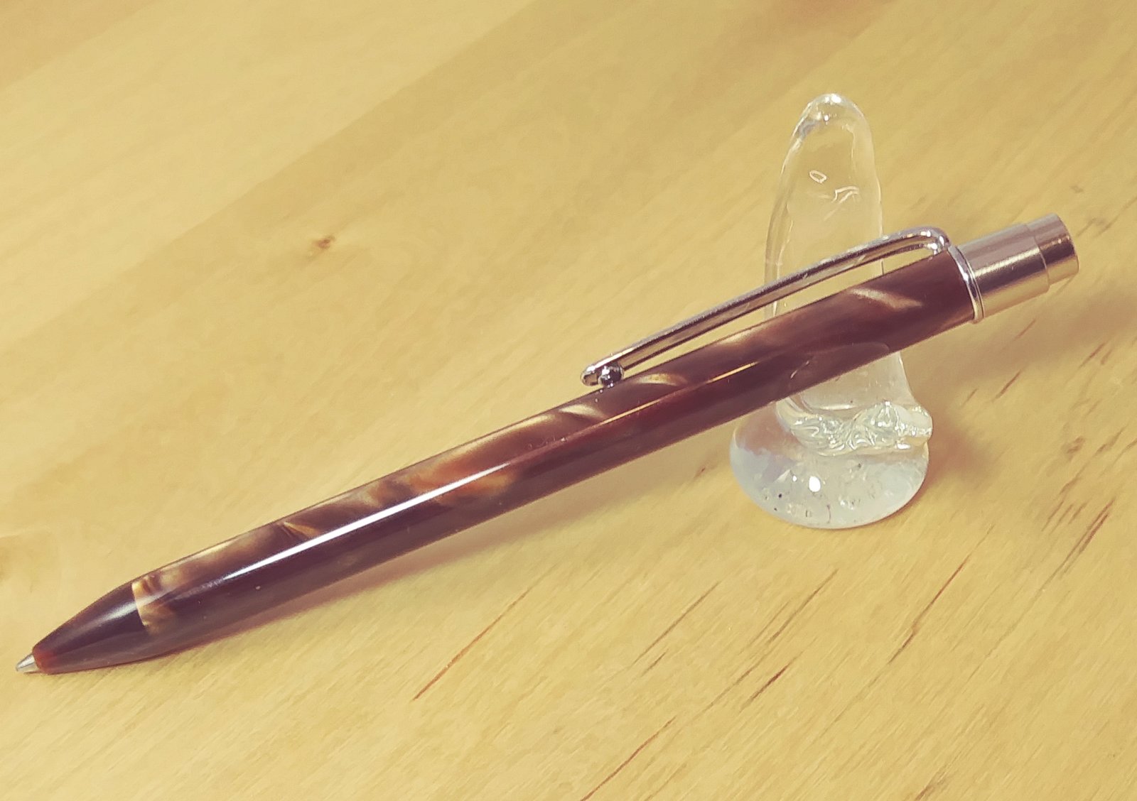

I used this for the first time today on a piece of vintage celluloid; I like it a lot.

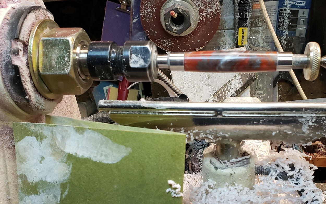

First I sanded with 320 grit using my regular method -- Vince's WoodNwonders blue sanding disks on a hard backing mandrel, with lots of water from a misting squirt bottle. I find it the easiest way to get rid of any bumps in the barrel.
Then I used each of the 6 "papers" - I cut a strip off each and quartered it, so I had a piece about 7/8" x 2" to work with. In between each one I stopped the lathe and sanded up and down the length of the barrel, being very careful to get rid of any circular scratches before moving on to the next grade. I didn't use a backing block with these, just finger pressure and again plenty of water.
Normally I'd go through Micromesh then use Plast-X (or buff), I'm not sure I have to do either to this pen.

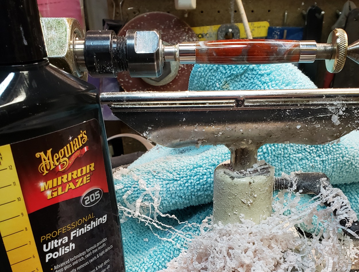

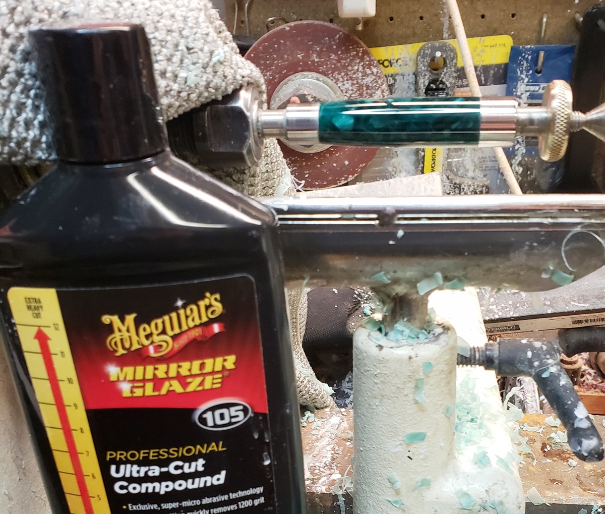

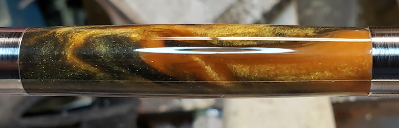

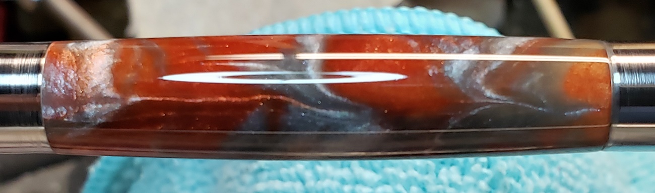

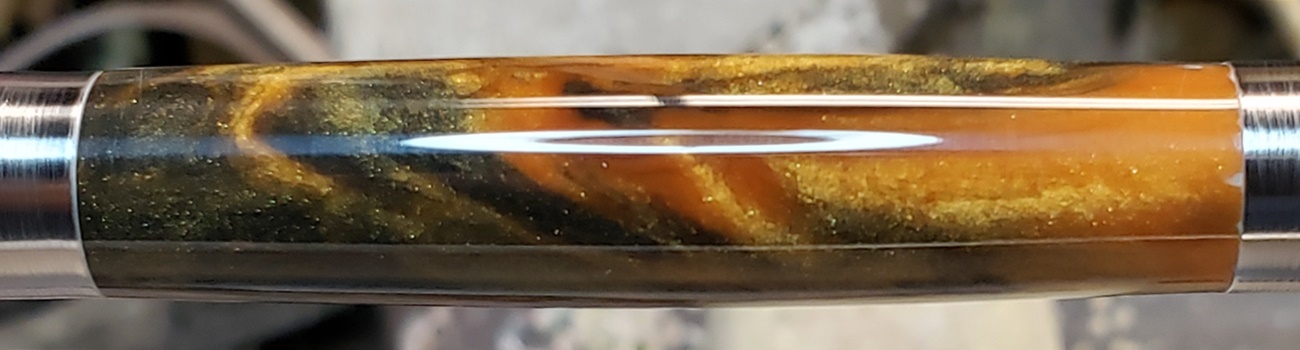

I'm getting really good results with the Tri-M-Ite followed by Meguiar's 105 and 205.
TonyL
Mar 9, 2014
8,915
Georgia
So far, this has been among the best that I have seen - especially with a dark/unforgiving blank.
I did see fine radial scratches on one of your earlier posts. If you are not using a loupe, you may gain much from getting one (10x is plenty).

I do have a loupe, but don't use it much. Most of the time when fine scratches show up in the photos, I can't see them with my naked eyes, so it's all good.
