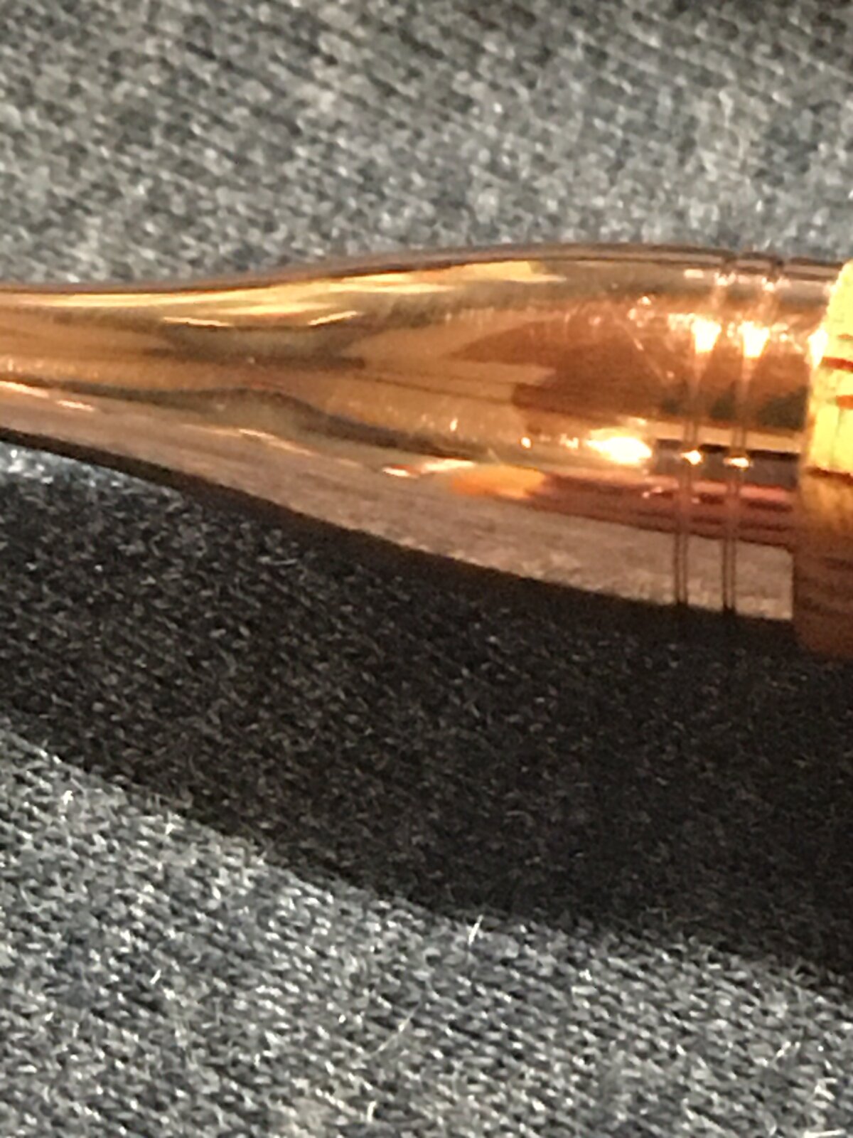

Here's the result. The first pic is before using the Craftics 20/20 Plastic Polish. Obviously some marring on the nib that's undesirable.

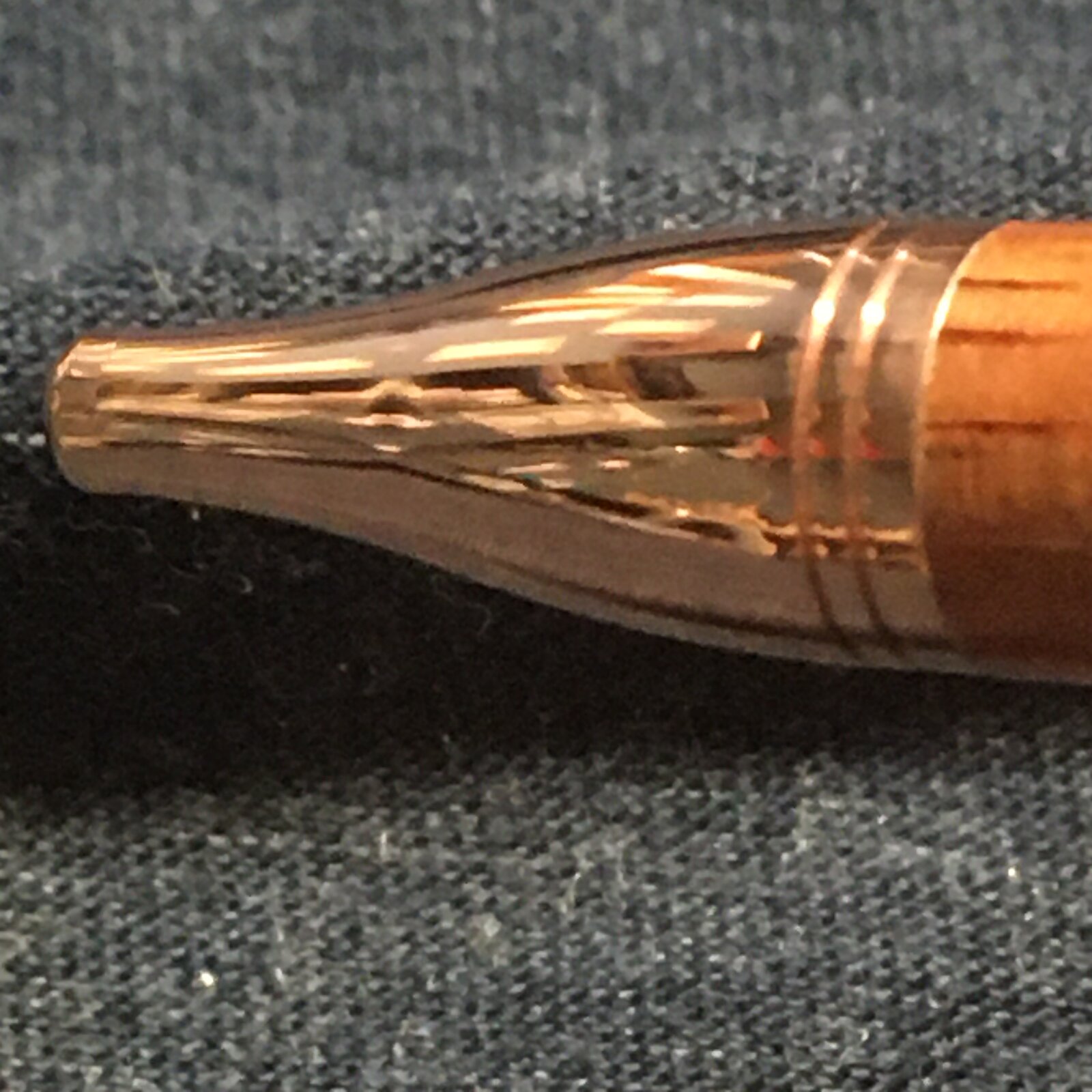

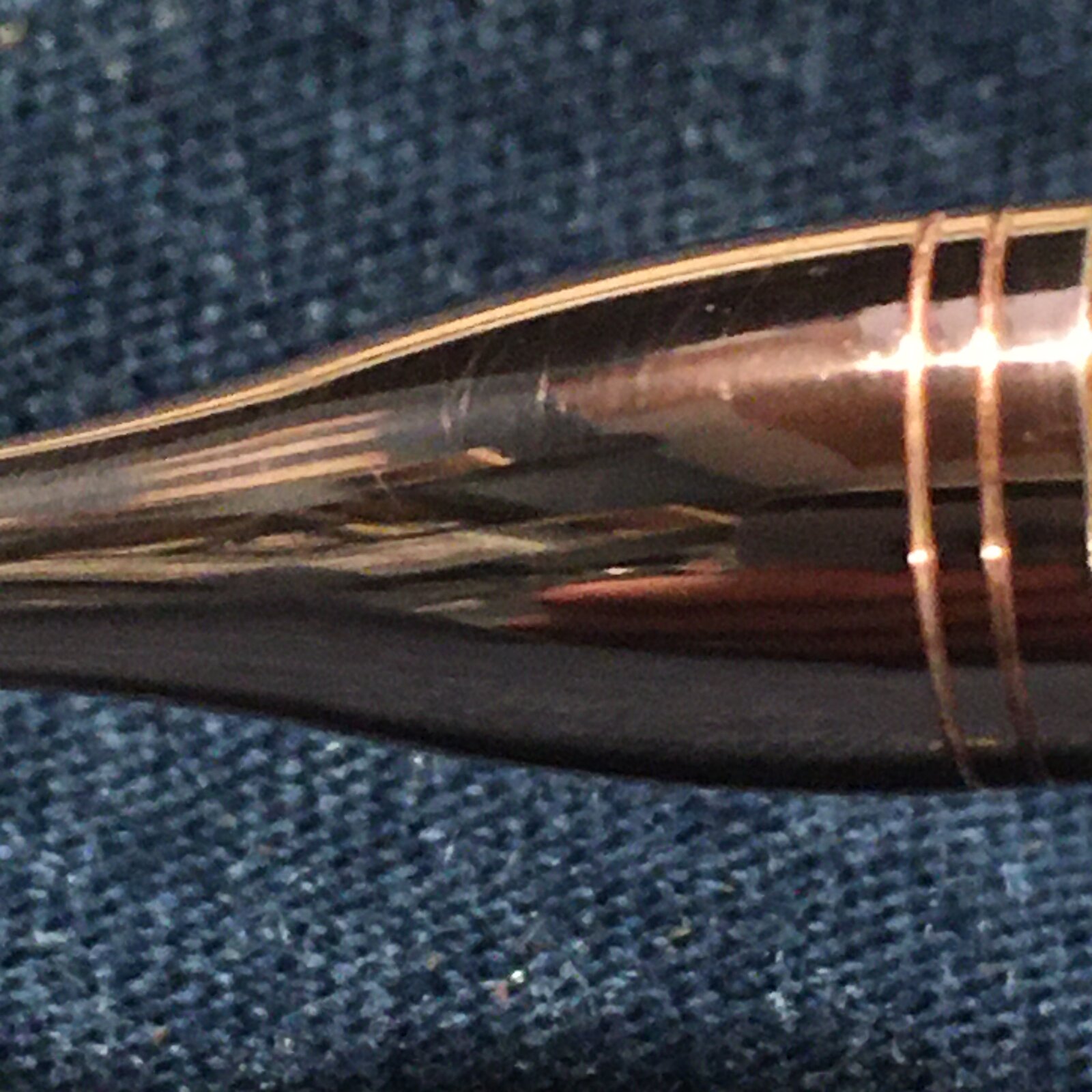

Second pic is after using the plastic polish. I put a dab on a clean cotton cloth and spun the pen so the nib rotated around in the polish. Did it three times. Definitely better and probably hard to notice without magnification. Although, the polish made some concentric scratches around the nib I didn't like. Pic three is using the plastic polish again, but wiping longitudinally along the nib instead of around in circles. Big improvement! (insert happy face here)
