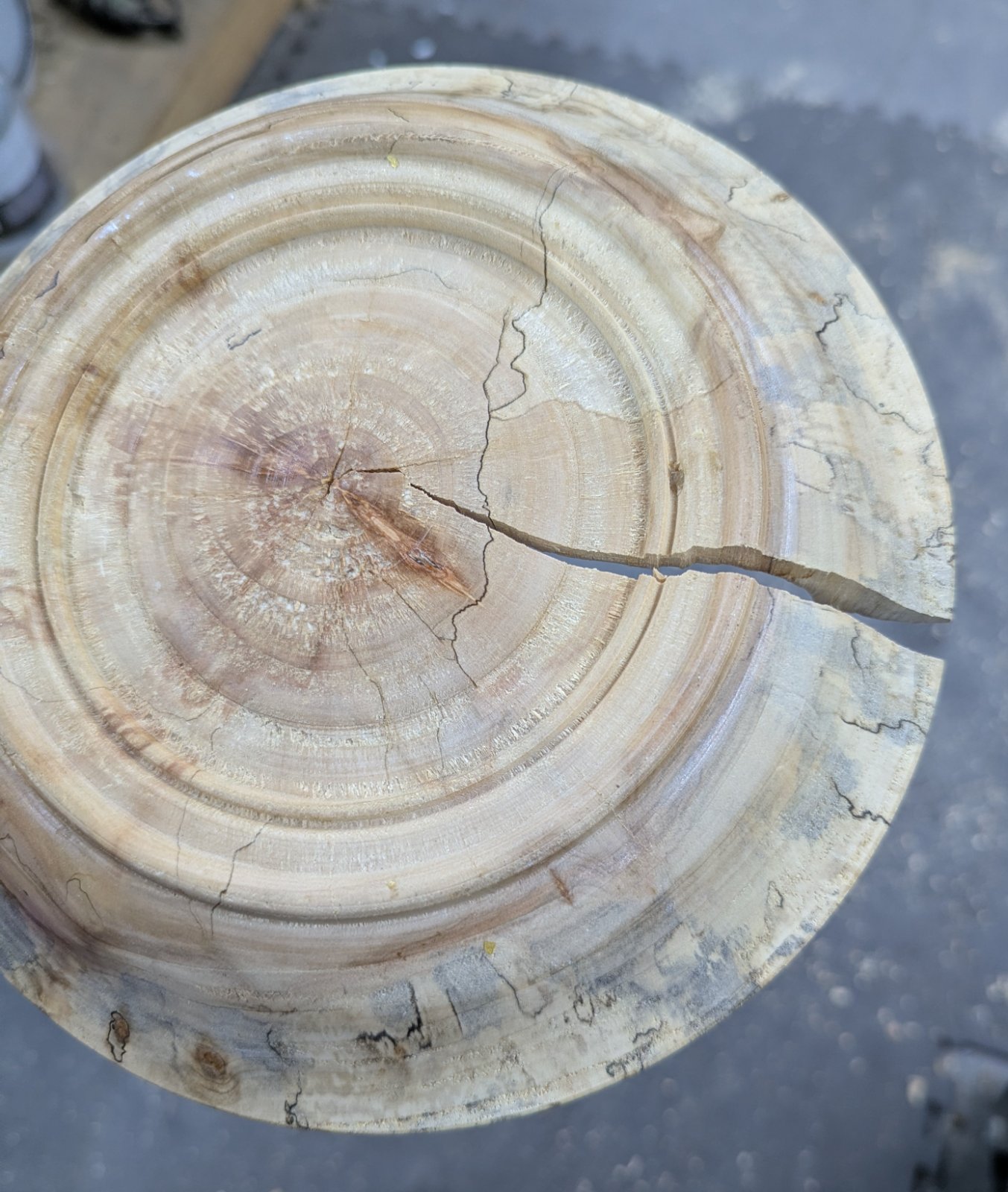

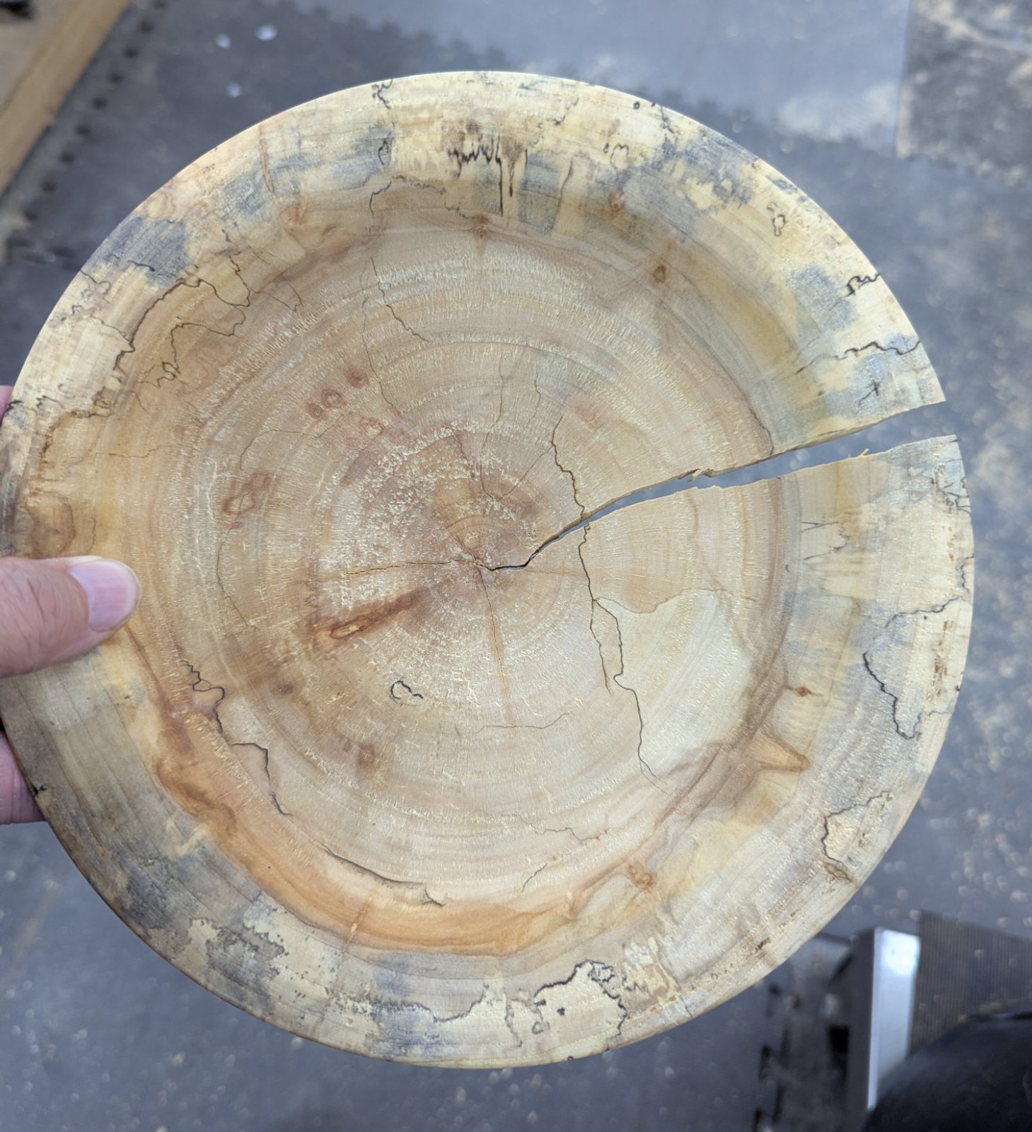

I found out why there is a lack of examples of turners that turn the log cutoffs (I call pucks). I got it turned and it looked ok. Had some grain pullout and tried to use some Shellac to help stabilize that.
I picked it up to look at it and all of a sudden while I was holding it......
Bang, Pop!

Yup, outside shrinks faster than the inside. Stress gotta go somewhere. The shape that stands the best chance of surviving is a deep conical shape with a small base. Then you are leaving space for shrinkage to happen.
