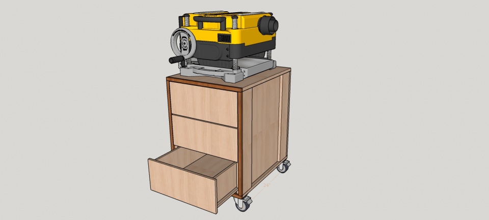

It's in production!
I'll photos when it's done! Maybe a video too?

Yes, but I don't have a specific tool to go underneath right now. And storage right now is at a premium, so I needed the drawers.
If (When) I eventually get a mitre saw, I'll do a flip top for that and the planer, with folding arm extensions that service both tools.

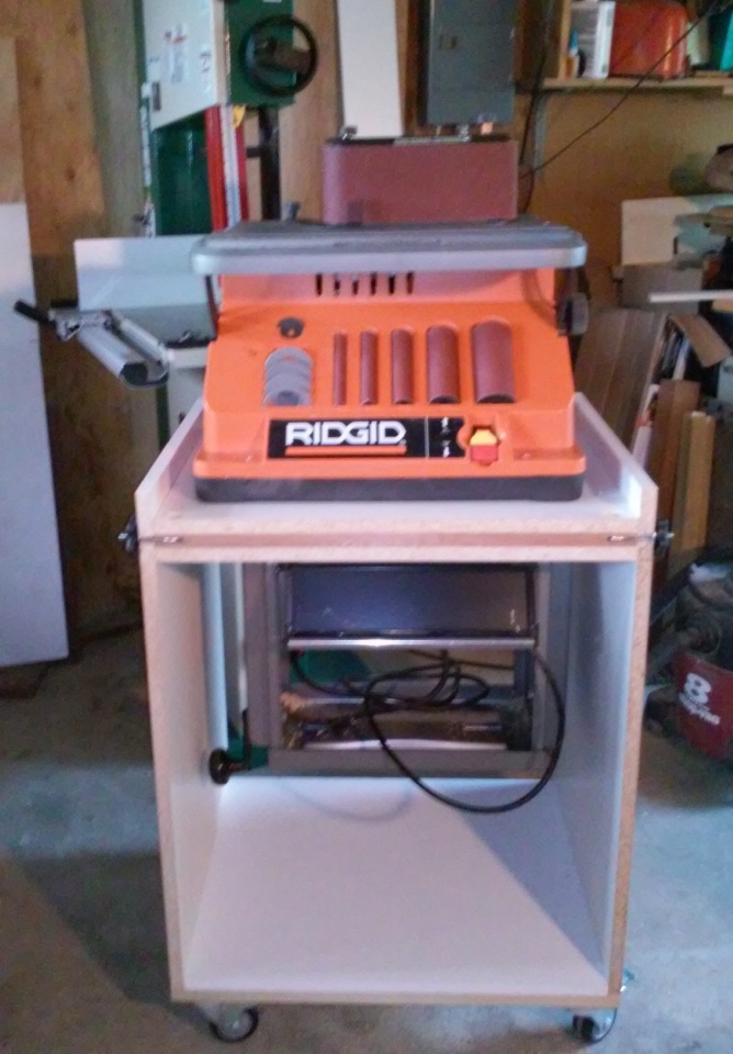

I'm thinking a flip top for my HCM and 4" jointer, as they are about the same length. I gotta refurb the jointer first though.
I made this one but allowed extra space for upgrading to a slightly larger planer in the future. The result was the sander is a little too high (for me). I do le having the mobility with the locking casters.

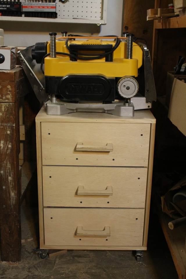

Finished it a couple weeks ago, but just now got it tucked away. Added some handles to the drawers. Need to learn to make proper drawers, these didn't come out right.

Nice little planer stand. 1 thing you should consider is adding some sort of extended support, minimally on the outfeed side so if you are planning a long plank, the weight of it coming out doesn't tip your cabinet over when the center of gravity moves back. Even some sort of fold-out leg that can be stowed away when not in use. It would be a shame to have that shiny new planer tip over while planning a board.
I use the portable roller stands for anything that require length and extra hand. I can set the height to whatever tool and all I need is a couple of them. They work very well because I am a one man shop.
