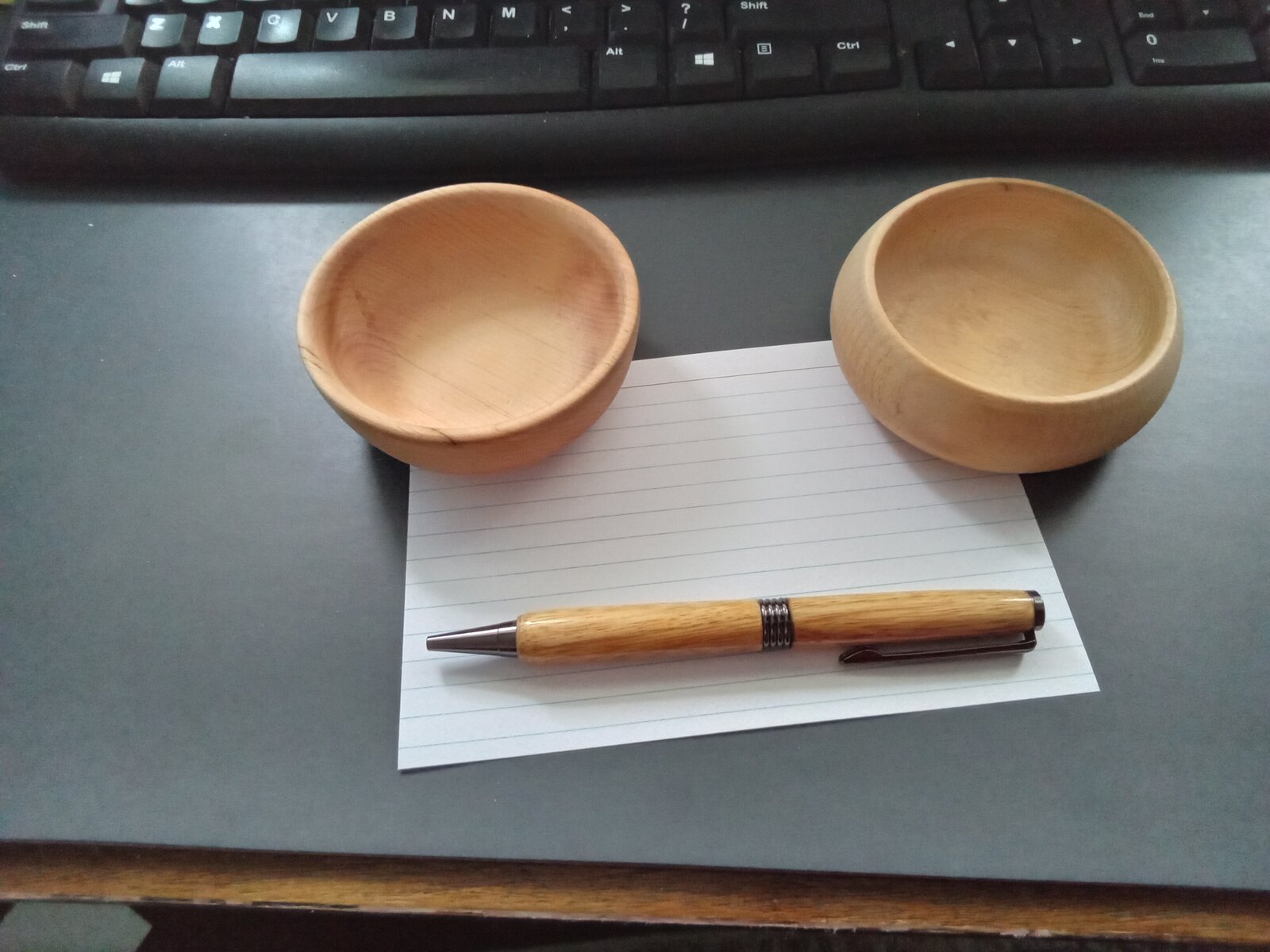

Pine can be a real snot, but this was special. A few years ago my brother was cleaning out my dad's garage and found a sawhorse from our great-grandfather. Most of the wood had been rotted away or been chewed up by saws, but we remembered it from our days as kids and playing around behind his workshop (he was born in 1898, retired in the late 1950s, and passed in 1978). He saved a few pieces that he could and gave them to me to do something with so I ended up making six small bowls (one for each of my brother and my kids so the great-great-grandchildren) and a pen for each of us. Soaked the pen blanks in wood hardener several times, but finally got them done.

I cut the wood to 3/4 in blanks and soaked in wood hardener for a couple days and let dry. Then I cut and drilled the blanks and soaked them again so the hardener was on the inside, too. Don't have a vacuum chamber and cactus juice so this was the best I could think of. Still had one split during turning, but found the piece and CA'd it back on while it was on the mandrel. Made sure to use a lot of CA in the finish, too. Also broke a couple of the bowls but still had enough wood to get out the 6 I needed. I forgot to take pix earlier and I took my brother his pen and kids' bowls Sunday (and sent one bowl to my son in Texas), but still have these around here until Christmas when my other two kid's get theirs.
