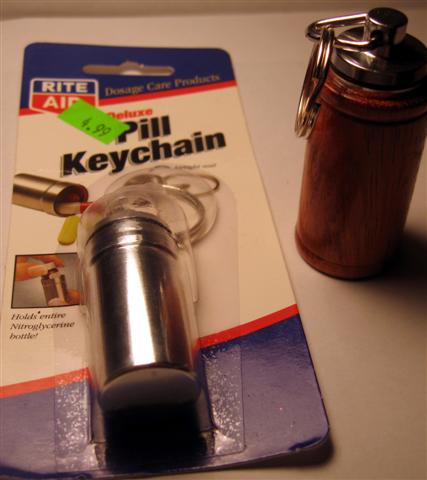

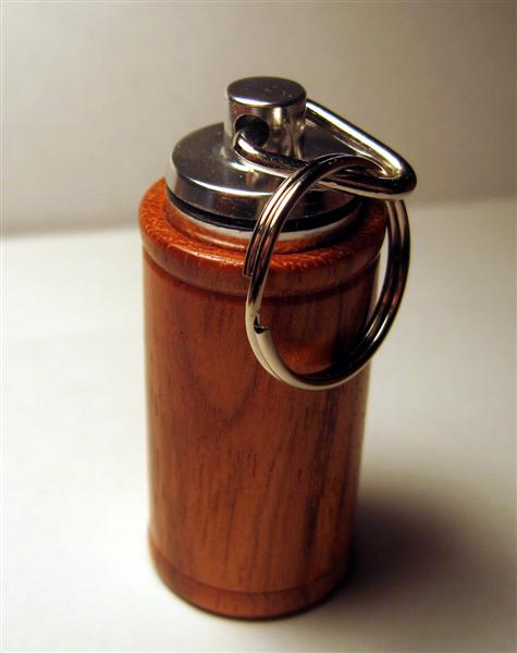

I have had some luck selling these and they are inexpensive and easy to make.
I recently found several of these at a local store for 90 % off so the cost was only 49 cents each
Harbor Freight also sells them for a couple bucks so its still cheaper than buying a kit
I just hold it in a chuck to drill it on the lathe, then make a jam chuck to finish the bottom
They hold 10 asprin or a normal size bottle of nitroglycerine

Hiltopper46 They all very..This one was 7/8, I have some that are 5/8 and some 1 inch
I bought the Harbor Freight digital caliper that also measures in fractions..makes life alot easier.
I glue them in with harbor freight 87 cent epoxy
