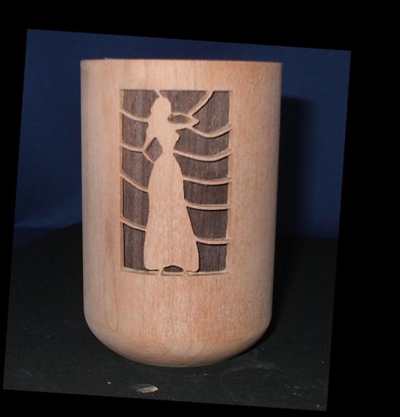

Needed a short break from pens and have wanted to try piercing for a while.

Looks great Bruce. It's an ice cup right? Don't lie!
On a more serious note though. Are you designing the pattern? There is some software that people use just for creating these fret patterns. The software does almost all the work for you. I don't recall the name of it, but it's advertised on the scrolling sites and magazines all the time. It would add some more detail, like a face, some waves in the dress etc, without compromising the structure.

The pattern is a blend of a picture I found and my design. For this one I was really just trying out the concept and I definitely need more practice turning thin walled vessels. I do intend to get more detail in the future as well as multiple related scenes all around. I junked 3 before I got one even close and there are still many flaws. Would love to look into the software if you can find a name. Thanks.

I never used software to construct fretwork patterns. I just freehand my own, but they are very simple ones for pens that I do. I couldn't freehand a decent sized pattern. Far as I can tell, most people are using GIMP. Seems that it is a freeware program as well. Another popular program is Coyote Stencil. Somehow you scan your image then alter it with the software. Then you use a color fill to test the pattern. The color fill will show you if there is anything loose in your pattern, such as an eye..the eye has to be connected to something, otherwise it would fall out when cut obviously. If there is a fallout section or piece, you then manually repair it by stringing it to the main structure. there are cd's and video tutorials available on the web. Knowing you, and you abilities with software and machinery, I have total confidence you will figure it out.
