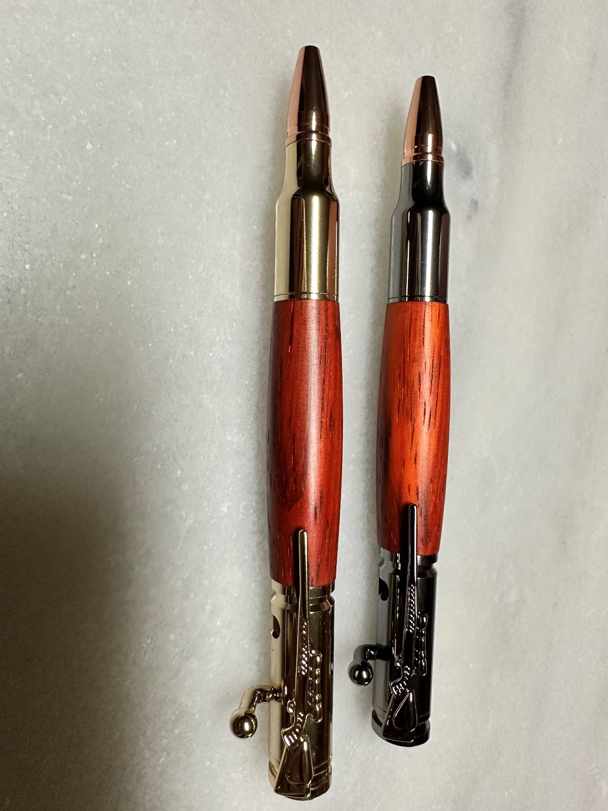

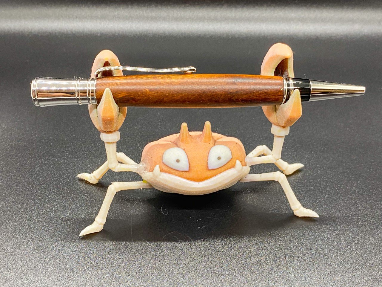

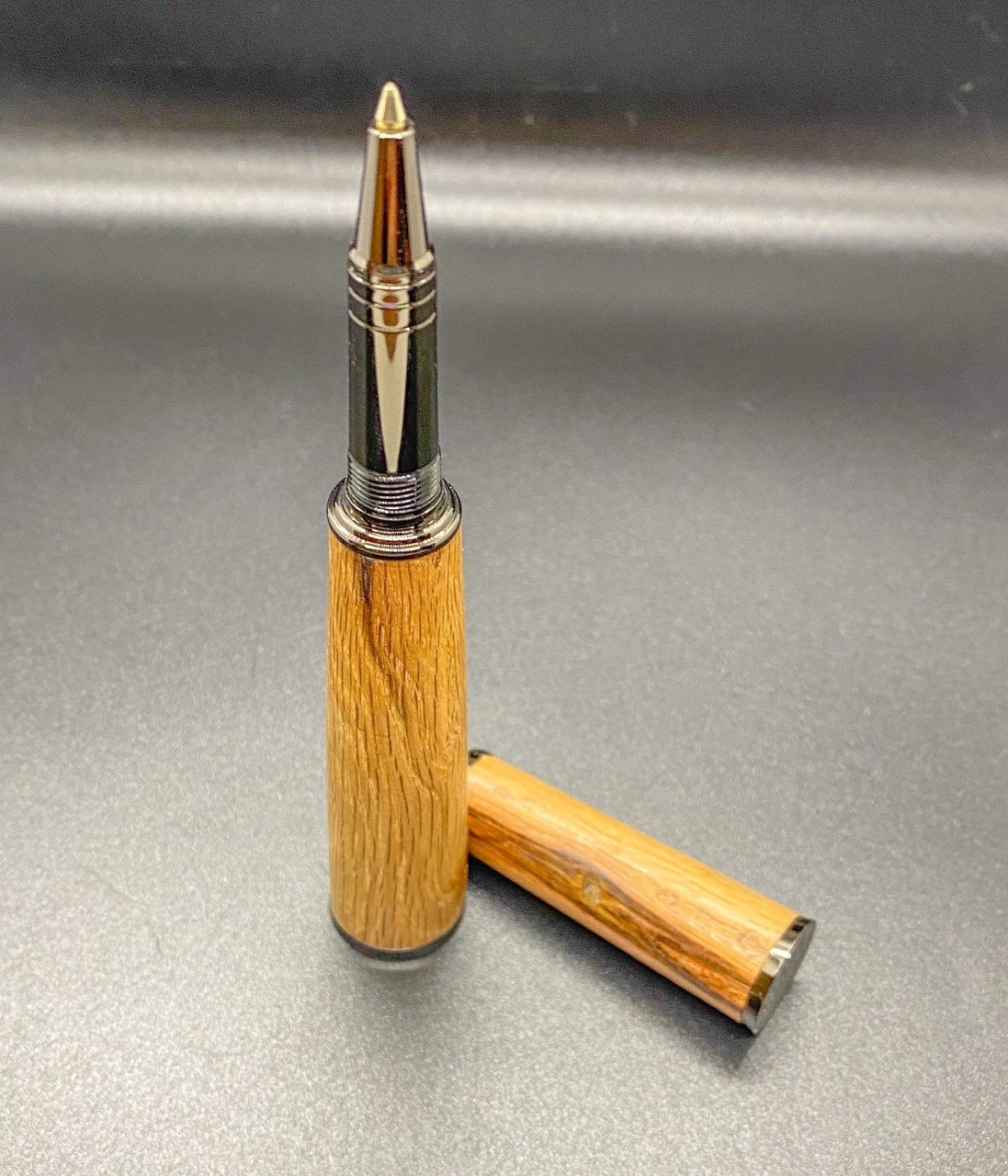

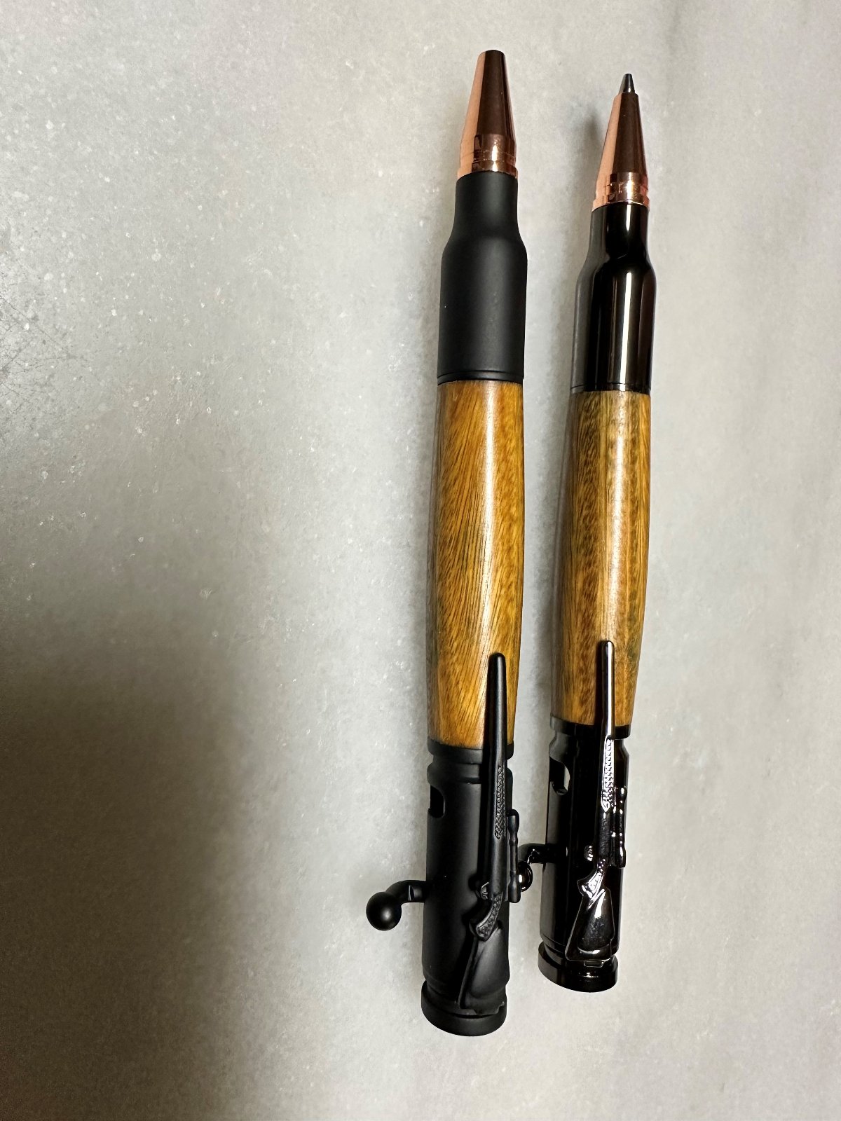

Below are a few wooden pens with Pens Plus. Hope this answers your questions. Unfortunately, the daily use wooden pen I had grew legs and walked away so I cannot get you photos of it and the one I grabbed to replace it was a resin one.
Have you used it with any kind of sealer? I ask because the lignum vitae ones seem noticeably glossier than the others. That could be explained by grain size or density compared to redheart or oak, but surprises me a bit that the ironwood is also noticeably less glossy than the lignum vitae. They do look very nice though, thanks for helping satisfy my curiosity!
No, I do not use sanding sealer. I do use the Doctor's Woodshop walnut oil with friction to create a hard base before applying Pen's Plus but that is not required.
