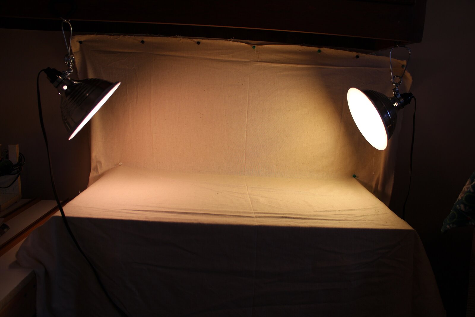

I have a setup using Harbor Freight clamp on lights and curly Q bulbs. I clamp the lights to doors and frames to get the best lighting to eliminate shadows. Wife made covers from thin gauze cloth as diffusers.

John that is sort of the same method I use today except that I did away with the tent. The light deflection you get with a tent in my opinion was not worth the effort. I use similar clip on lights with photographers bulbs that are diffused already with the coating that is on them. I use various backdrops in the past and still play around with that. I am far from a good photographer but think I put up some decent photos of my pens. Always looking for an easier and better way. Thanks for the replys.
