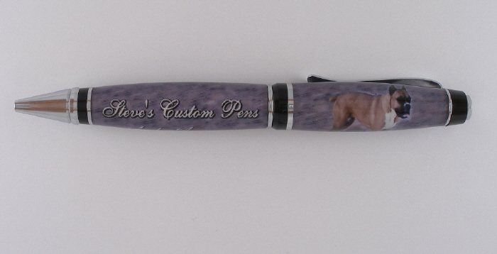

Avery 82xx labels. print onto them. stick the label onto the tube. Cast the tube in clear PR. Works great.
Sample from Stevers:

I used 8255's on that piece and all sense then. The better quality label holds up much better in solution. The PR doesn't seem to saturate the paper "as bad". It still does, just not nearly as bad. White is the toughest by far to work with. The tube will really want to show through the white paper. It becomes ness to paint or powder coat the tube.
The whole process is quite involved for what it is. The paper must be just right and adhered perfectly, the tubes must be sealed just right with the corks sealed perfectly, they need to be weighted down so they don't float up in the PR, if you cast to hot, the label glue softens too much, you have to let the finished tubes cure for a couple of days so the label glue can re-harden. And on and on. It's involved. I only cast special items this way.
