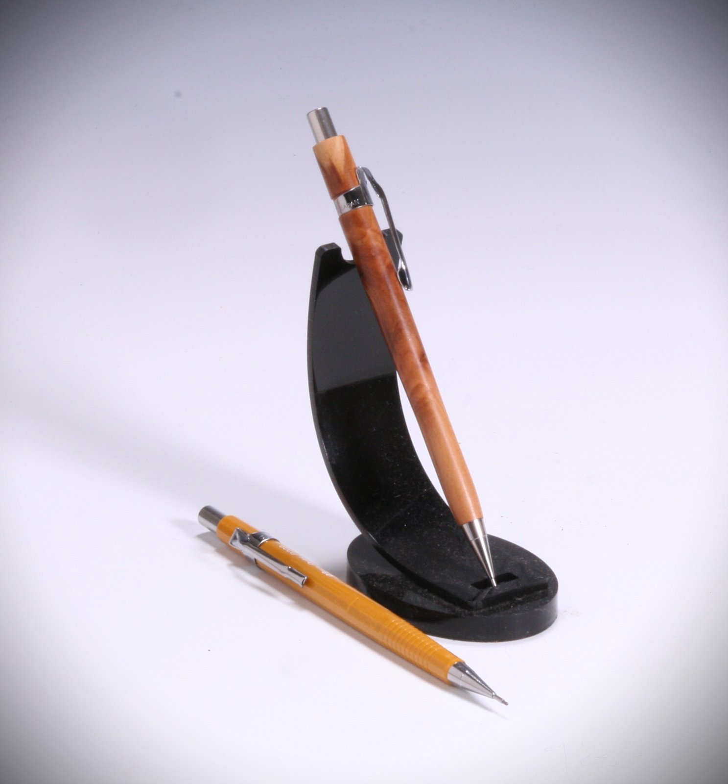

Pentel conversion - apple.JPGI made this conversion using the old step drill method. The wood is apple from a yellow delicious apple tree we had years ago. The quick finish is Yorkshire Grit and Hampshire Shine. I've been asked to demonstrate the step drill method and wonder if http://www.theperfectcollection.com/ is still in business? I can't seem to pull up supplies to order anything from the website and emails have gone unanswered. Thanks for your help.
