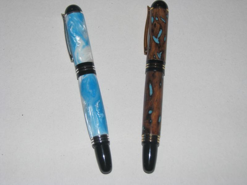

First off thanks to Bob Stoughton for the donation of the kits. The first is a home cast of light blue and pearl white. The second is a wormy persimmon with turquoise. Blank courtesy of Randy Allen aka randywa. The Persimmon and another Ancient Kauri El Grande (no Pic) were donated to a raffle held by the Brain Tumor foundation for Children. $400 was raised to help with the financial needs of children in treatment. Thanks Guys

I hope the gentleman that bought $100 in tickets was a winner. Did you pick out all the worm poop and mix crushed turquois with epoxy? I've still got a bunch of that stuff I need to do something with.

Randy, I turned it down close to the bushings and picked out the worm poop with a dental pick. Filled the voids with crushed turquoise and thin CA. Turned to size and CA finish. If you have some you don't want, send it my way, I like the way they turn out.
