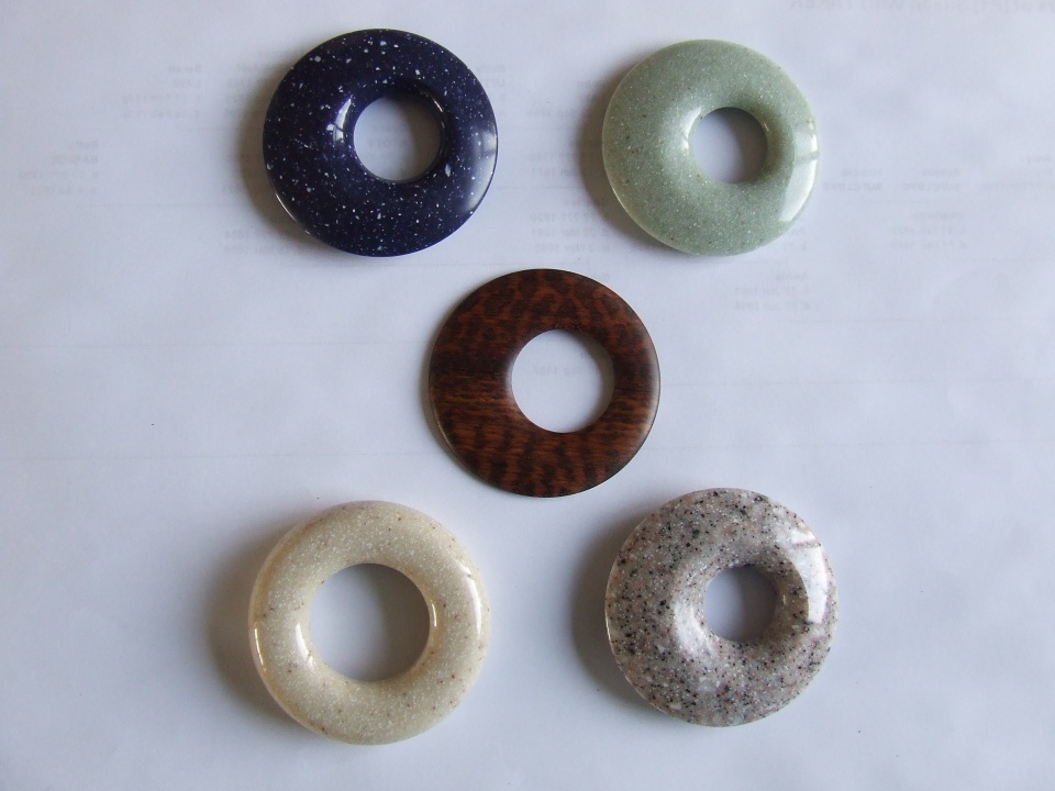

Pendent Size Question
The Corian in this part of the world is about 1/2 inch [12 mm] thick and yes too heavy: I use the Joyner Index Plate, stick to waste block and once round reduce the thickness to app 3/8 inches [6 mm] using ordinary tools eg detail or spindle gouge... attached photo shows the Corian in the bottom row...

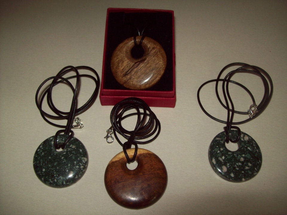

david44
Jul 23, 2013
114
Withernsea, East Yorkshire,UK
I made these a few years ago - perhaps I ought to have another go! The centre one is snakewood of course. The offset pendants were completed on a spare chuck to which I fixed some special jaws made from some nylon which I had at the time.
