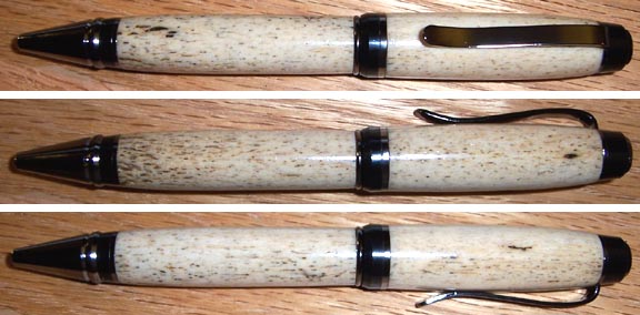

I'm confused. What do you mean by "wood down to the nib"? I started turning pens in 1999. My first was a slimline, and it had a metal nib. When I turned my first cigar pen in 1999, it also had a metal nib. Then you say "kits with metal tips going down to the nib". I'm afraid I don't understand what you're saying.
The attached photos are of an oosik cigar pen I made in 2004. You can see it has a metal nib.

The cigar has wood down to the nib. This one does not, it has metal down to the nib: https://www.exoticblanks.com/emperor-pen-kits/ This has metal between the wood and the nib.
