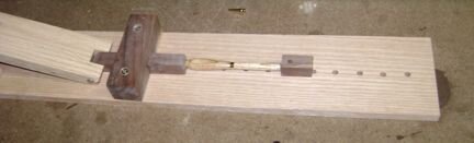

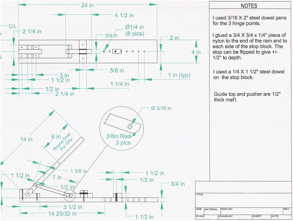

I've been using this home built one since the mid 2000s. Has worked great for me. Matthew Services in the name on the plans. If you need, I can send you or anyone a .doc file of it.
