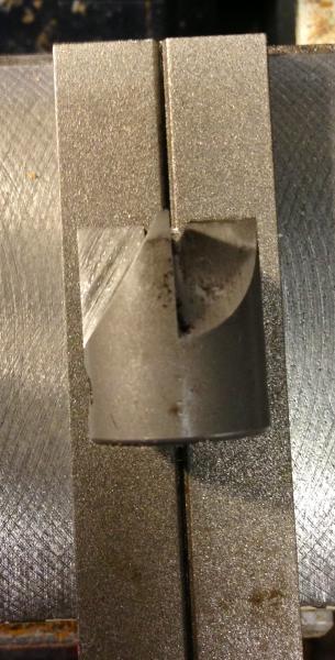

I use a diamond stone with some WD-40 to sharpen mine by hand, keeping the stone flat against the large inner flat surface of the mill (with the pilot removed). Equal passes on each, usually 15-20. Then I set it on some 400 grit sandpaper and gently rotate it counterclockwise to remove any burr that built up. That should get you back on track.

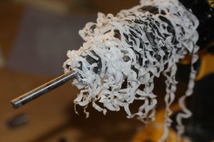

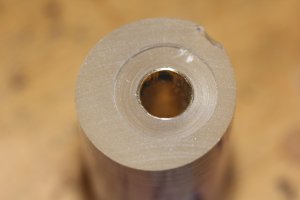

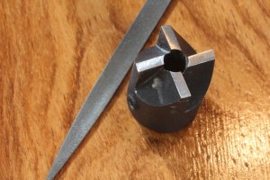

Ok, I am going to voice my opinion, which is contrary to popular recommendations. If there is a nick, then I file the long side, the one that everyone recommends. But this is really just making sure the chisel is flat.
Then I file each short edge (the red one in the pdf). I use a jewelers file, lay the mill on its side. You can criticize me if you wish, but my mill is sharp and effective. I always chuck mine in my Dewalt drill. The drill speed is really slow, and this was after just a few seconds:
