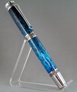

Andy, three of the 4 bushings can be used on the full sized majestic from the full sized Statesman, The full sized Statesman tapers toward the final whereas the full sized Majestic is straight Barrel to Barrel.
Also as has been done by many here the crystal can be changed to match the blank used, or contrasted .
