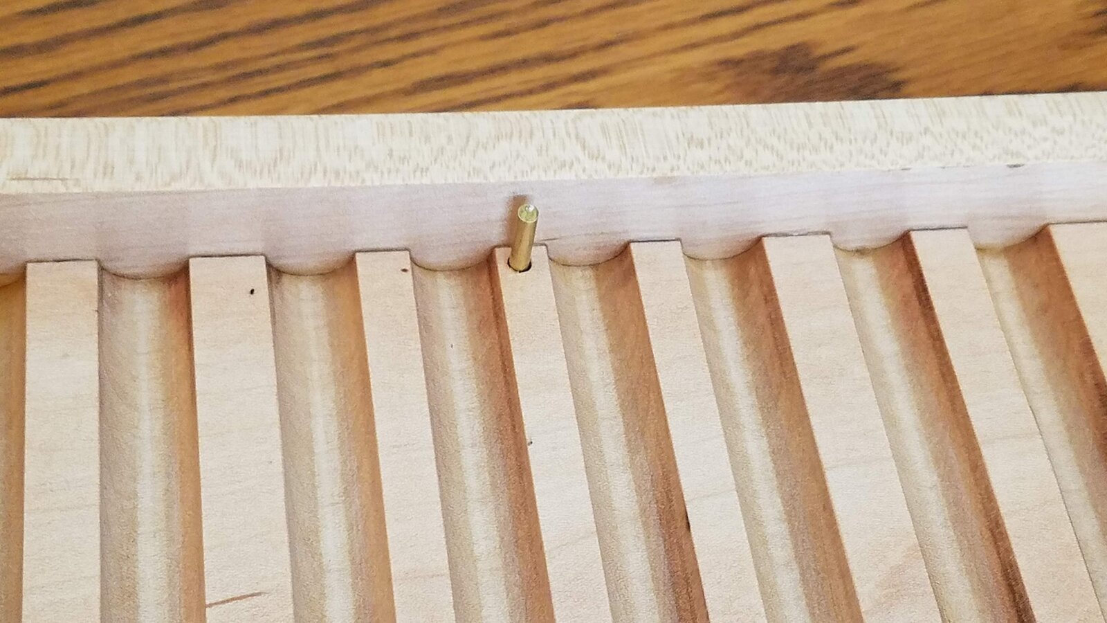

I haven't had a week off since last August 15, but was able to get this week off. I have been slowly working on a pen display box for my son and was able to finish it this week. It is modeled after a Levenger display box my brother gave me a number of years ago. I added a secret drawer to the front which is held closed both with magnets and a pin. The woods are wenge and maple. Not real satisfied with the grooves for the pens - I tried flocking them without success. Like many things it looks real nice from far away but up close I at least notice the flaws.

I've never done flocking before and frankly I made a huge mess of it. I think it was too hot and dry when I tried the flocking so the under coat dried to fast. I also tried the sticky back felt but the grooves that I routed were not wide enough to accept a pen and the felt.
If I do another one I will buy a larger bit and also spend more time learning how to flock. On paper it seems like it should be so easy...

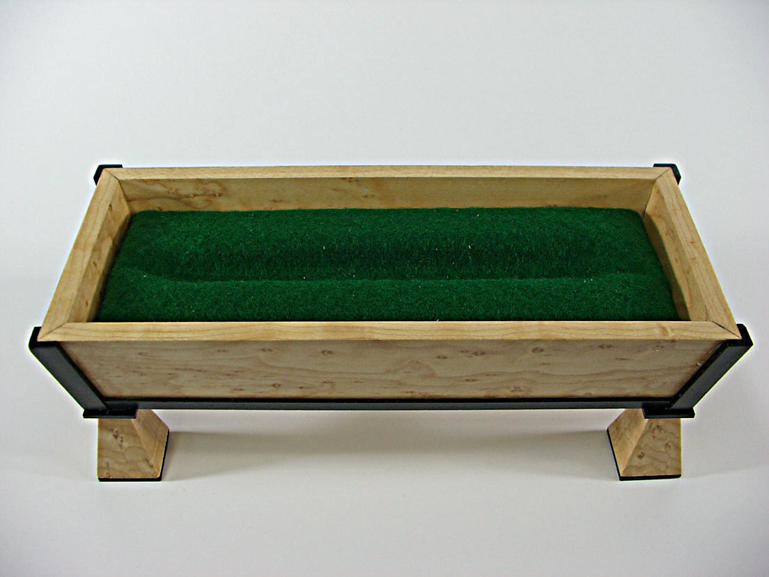

Flocking is very easy and I have shown plenty of examples here when I was making pen boxes and pen stands. There are a few things that need to be done and that is have all materials laid out and ready to go once you put the undercoating on. You need to work fast and keep it wet. Need to put on evenly and when flocking just keep adding more and more. When you think you have enough use some more. Place paper under the project so later when you knock off excess you can capture it and pour it bag in the bag. Need to keep the flocking dry and out of humidity. Maybe just place cut strips of sticky back felt on bottom of slots. It will add some color if anything. anyway still a good looking project.

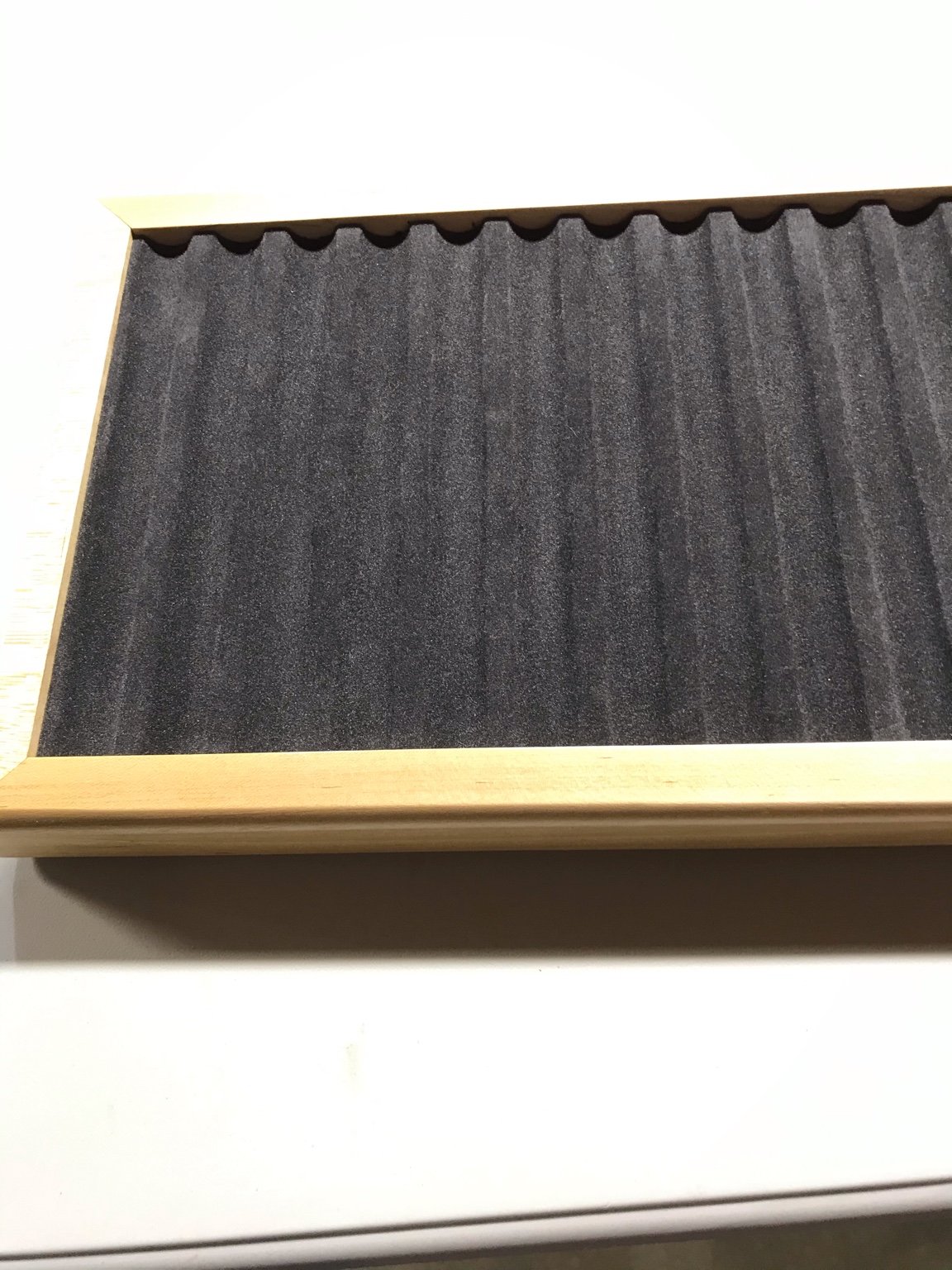

I like it Steve. Something like that has been on my to do list for awhile. I'll attach a picture of my pen trays that I use for shows. They were easy to make. I got some 1 inch thick pine and ran the edges over a 3/4 inch cove bit on my router table, took to my table saw and sliced them off. Ran it over the cove bit again and sliced it off. Then I just cut them to the length I needed and glued them together. Built frames for them to sit in. I just flocked them, I wanted off white, my wife said a gray would look better, she won, so the flocking is a dark gray. Glued them into the frames and they were done. If I get around to making a box, like you did, I'll probably make the inserts the same way.

Just a quick tip. Do not make sharp edges. Soften them by sanding rounded, Flocking does not like to stick to sharp edges. Do not try to do too much at once. Steve you could have done your box in 2 steps easily. Just tape off one half and concentrate on the other half.

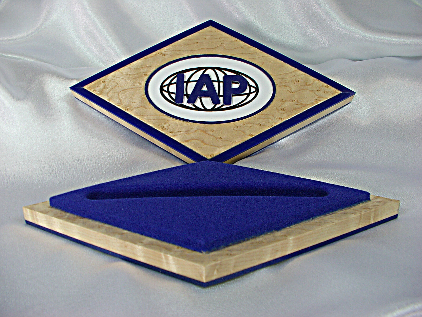

I know you have seen these examples because they were my Bash entries in the past. I still need to make the pens for these pen boxes. Man I sure have alot to do.

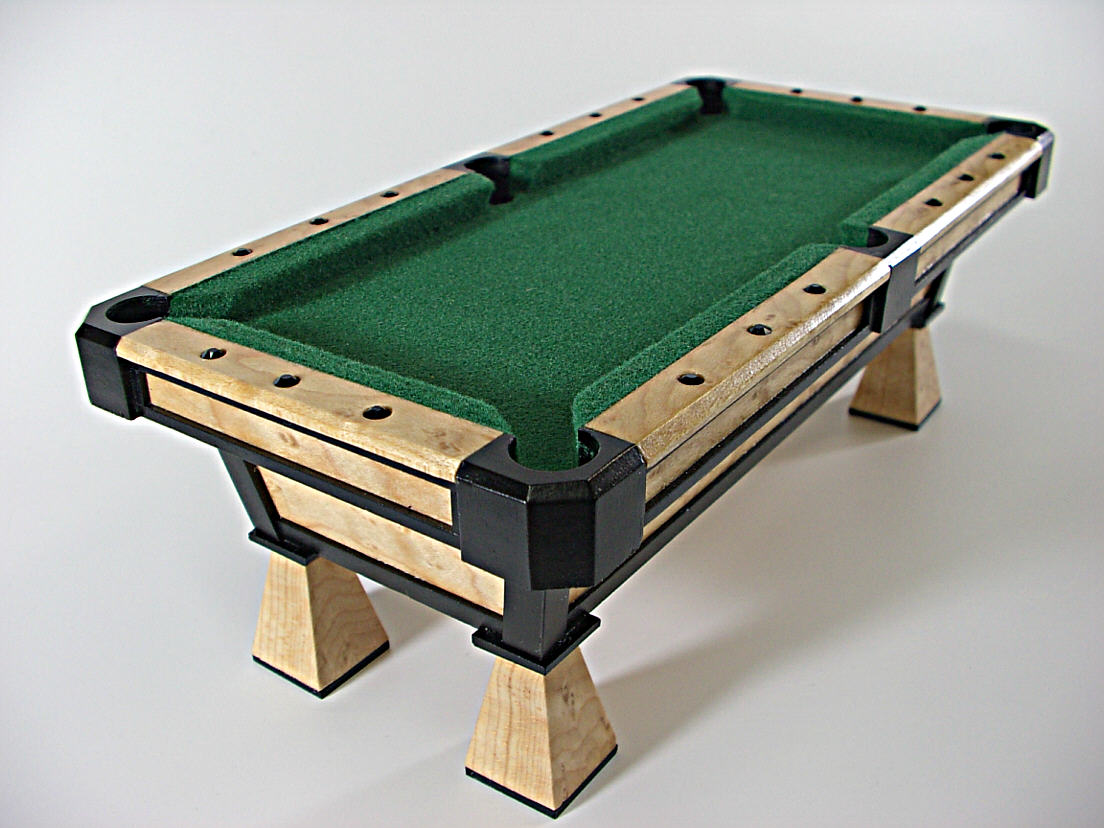

JT, I have really appreciated those projects - thanks for showing them again. If I remember correctly that pool table is actually a pen box isn't it?

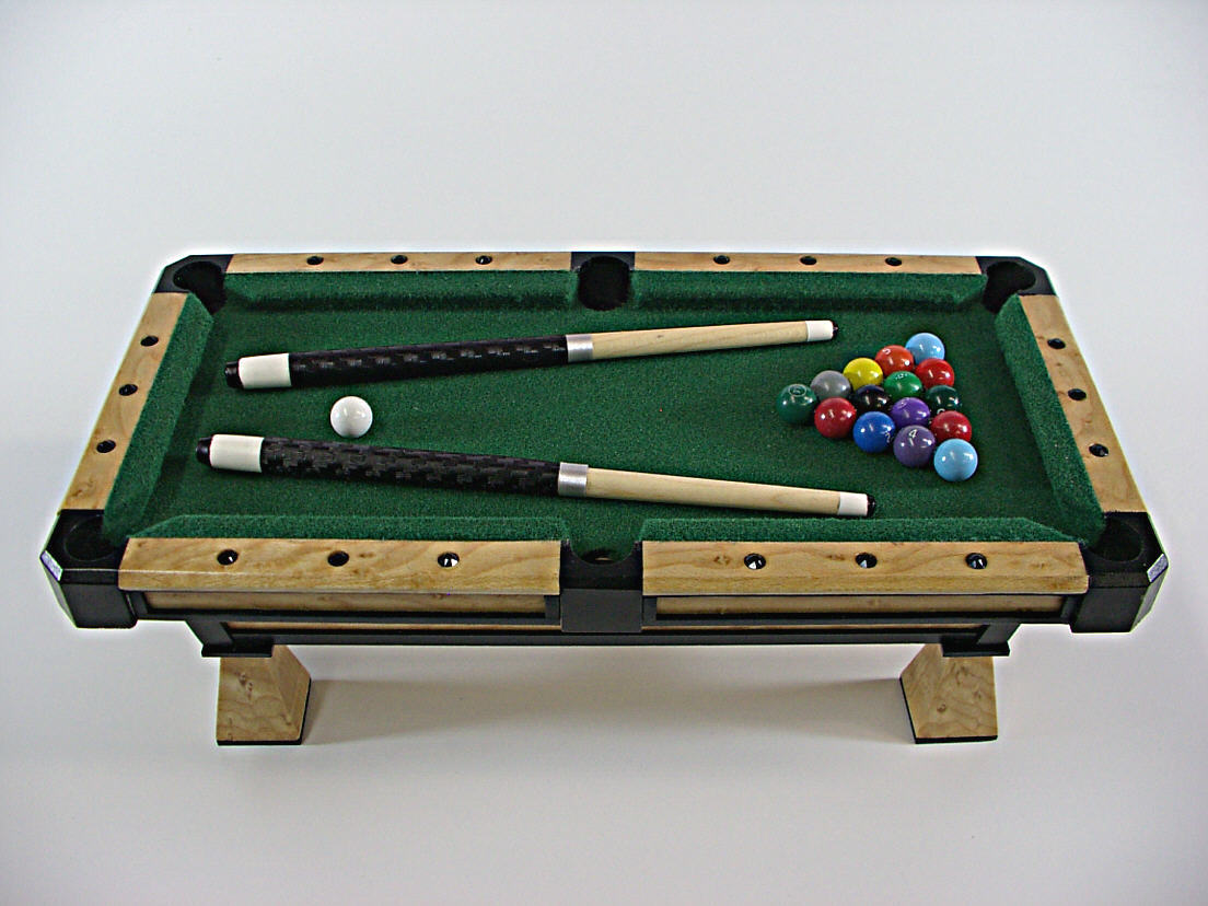

Yes Steve that pool Table is a pen box and here is a few more photos. These can be seen in my album if anyone is interested. I was offered alot of money for this box but turned it down. I still want to make the pen for it. I have the ideas for all 3 boxes but just never got to it yet. Have to say and I will toot my own horn on that project, but it has to be my best work ever. I had this idea for quite awhile and when I finally put wood to blade, every cut and every move I made came out perfect with precision and ease. Every jig I made to make all the cuts weather on a router or a tablesaw were first time perfect. It was like someone with a higher power guided me through this project. I am proud of this one for sure. Sorry could not help patting myself on the back. 👏
