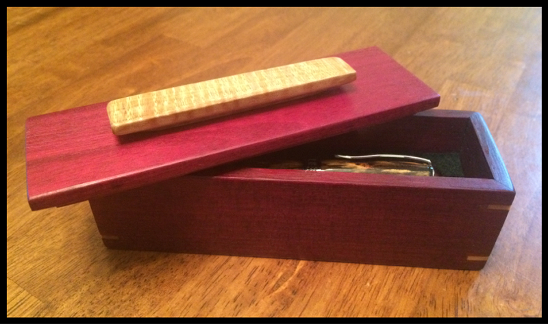

Are you talking about making boxes or resell commercially made ones? I make boxes and sell them for around $35.

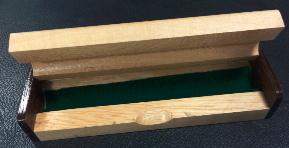

Hi Christian. I have not been turning very long and live on the other side of the world, so you can take what I say with a pinch of salt.
I can echo the sentiments of the other members that when you sell a pen, most people do not want a box due to the fact that they see it as not required, and if it is for themselfs the box will go to waste the moment they start using the pen.
For gifts, normally they want a box, but it must be a cheap compared to the pen (no more than 20%).
As to styles and difficulty to make, there are 100's of options. My personal pref is to make something that is quick and cheap to make. For the body, I cut long strips of a wood that is easy to finish, and route/rebate the pen channel. I then have these strips available when the need arises. Cut 2 pieces, glue on a contrasting end strip, use pin hinges, sand on the sanding disk and finish with a clear aerolac.
The case bellow is made from Jacaranda and PangaPanga. I add some felt to finish. My cost is less than $1 and I sell them for $3 if I convert to US$. A better comparison is that I sell it for the same price as a Big Mac (sandwich only).
