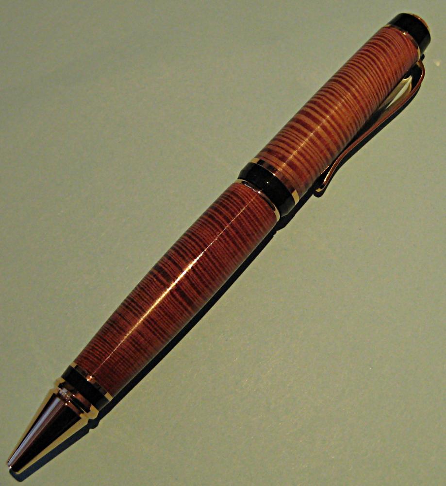

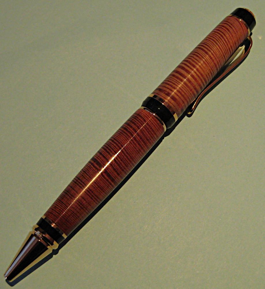

This is what crosscut looks like:
https://www.penturners.org/media/ahp-cigar.3611/
Some woods excel when crosscut:
Heart pine, osage orange, sycamore and bubinga.
If the wood has a very tight set of growth rings, it's a good candidate.
