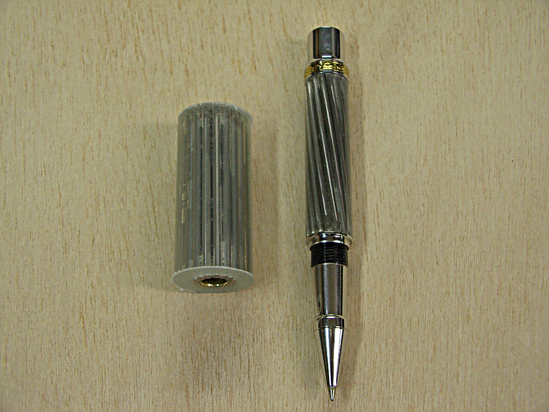

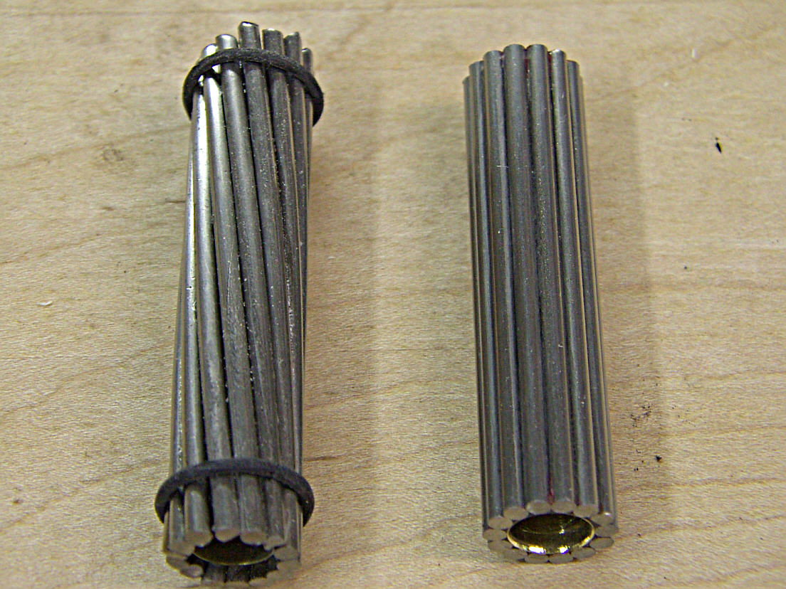

As John said and you even eluded to that all kits are thin blank oriented. Yes if you make a blank more bulbous in the middle you can cast thicker objects. But you also have to take in consideration thickness of tube covering if you are using such. Things like carbon fiber, any braidings either metal or poly, vinyl coverings and so forth. This adds to the amount of all around thickness even on the ends. This is why many times you will see watch part pens without hands on the clock faces. It gets dicey when you apply them. A good way to tell weather a kit will work for you is to check the bushing charts here in the library and they give both the tube size and bushing dimentions and you can subtract the numbers and judge for yourself. One kit and not sure if it is still made that is an all time largest area for casting is the Spring Blossom by Timberbits if they still carry it. But the cap end is one of the thinnest to cast but the lower half is huge with a tiny tube. This was done intentionally. Here is an example of such kit. I was able to cast very easily 1/8" rods in the lower section. I never did finish this pen. I was suppose to use a stainless braiding in the cap section. It is laying around somewhere. Just was not too enamored with outcome. I did one blank with straight rods and one blank with twisted rods. Another way to gauge things is to look through many of the pen photos shown and see what kits others have used and what they are casting. Good luck. Look forward to seeing what you come up with.
