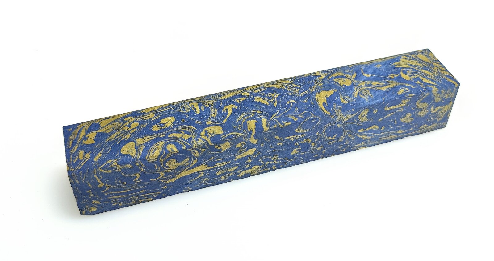

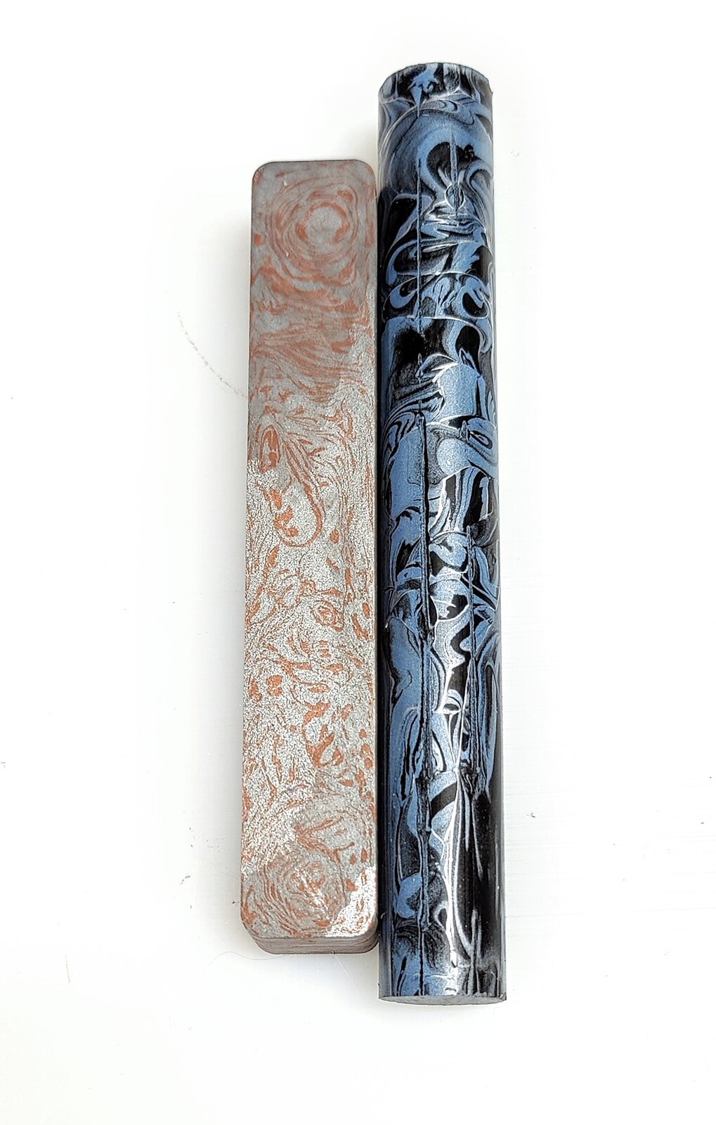

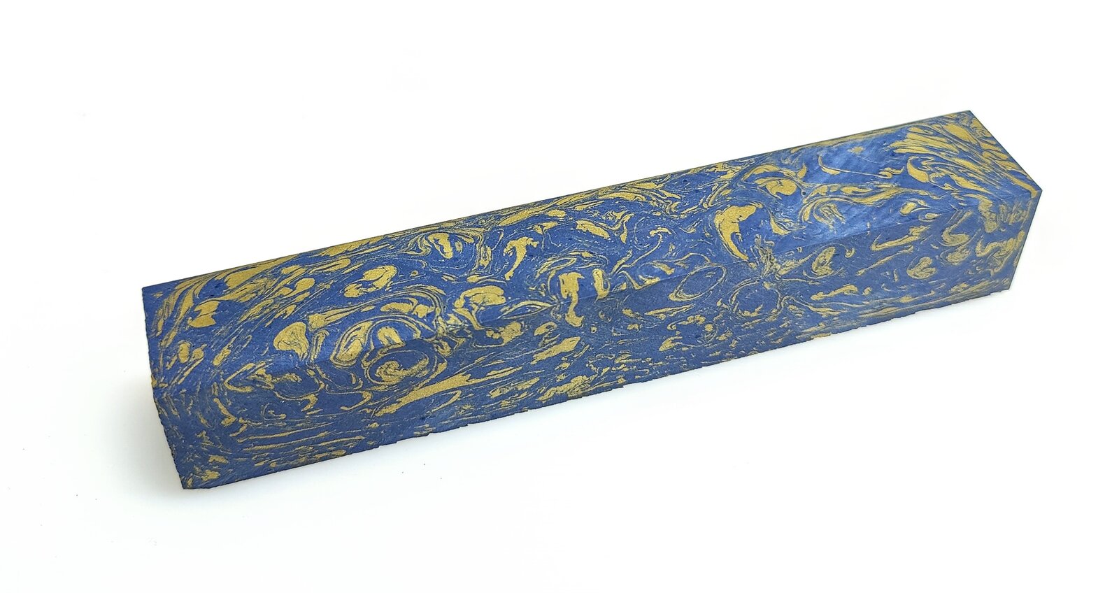

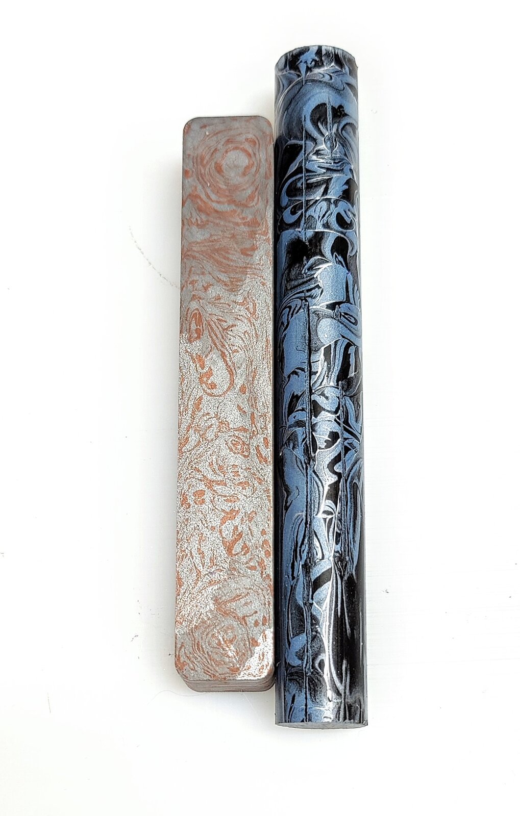

Well... Day one of training on making the M3 Metal composite blanks was epic failure yesterday but we took the lessons learned from that and had some success today.
Cobaltium and carbon rod, Copper and Steel Mokume Gane square blank and a "Oops wrong blue for Cobaltium" and carbon square sheet....
We've got some production stuff to adjust to fit this in with DiamondCast but, I think we'll be able to pull this off nicely!

Those are fabulous ... I don't see why those aren't an epic success. Unless the material properties are off? Too brittle, too hard/soft, ... ? I'd take any of them in a heartbeat
Mar 11, 2012
799
Fuquay Varina, NC
Oh I'm happy with these... but we're still going to run them through tests like threading, etc. I've learned over the years to temper my excitement when we have something new to offer. (Pretty sure I spent $300+ on shipping new parts out when we realized a good chunk of our new pen kits had parts that were out of spec... I just happened to test 3 pens that went together perfectly... oops!) Production is going to be a big change for us compared to our current methods so it'll take a few weeks to iron out the details there. The big blue sheet was just the wrong pigment for the original color of the materal. I kinda dig the richer blue though so we'll probably end up using it in the end.
Saturday's tests were... bad. Found out some of our dyes weren't compatible and ended up with rubbery messes that are going to be less than fun to clean out of our molds. Once I figured out what the problem was it was easy enough to switch gears and we ended up with usable material that I now get to play with a bit. (Any excuse to get to use my lathe these days!)

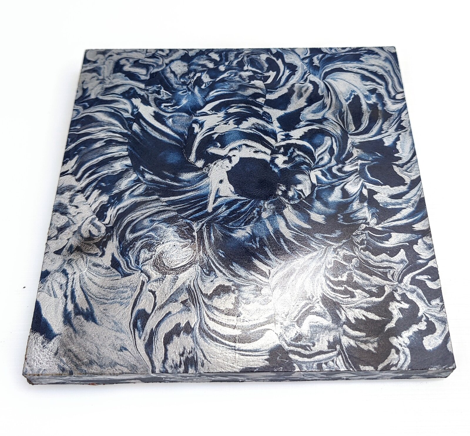

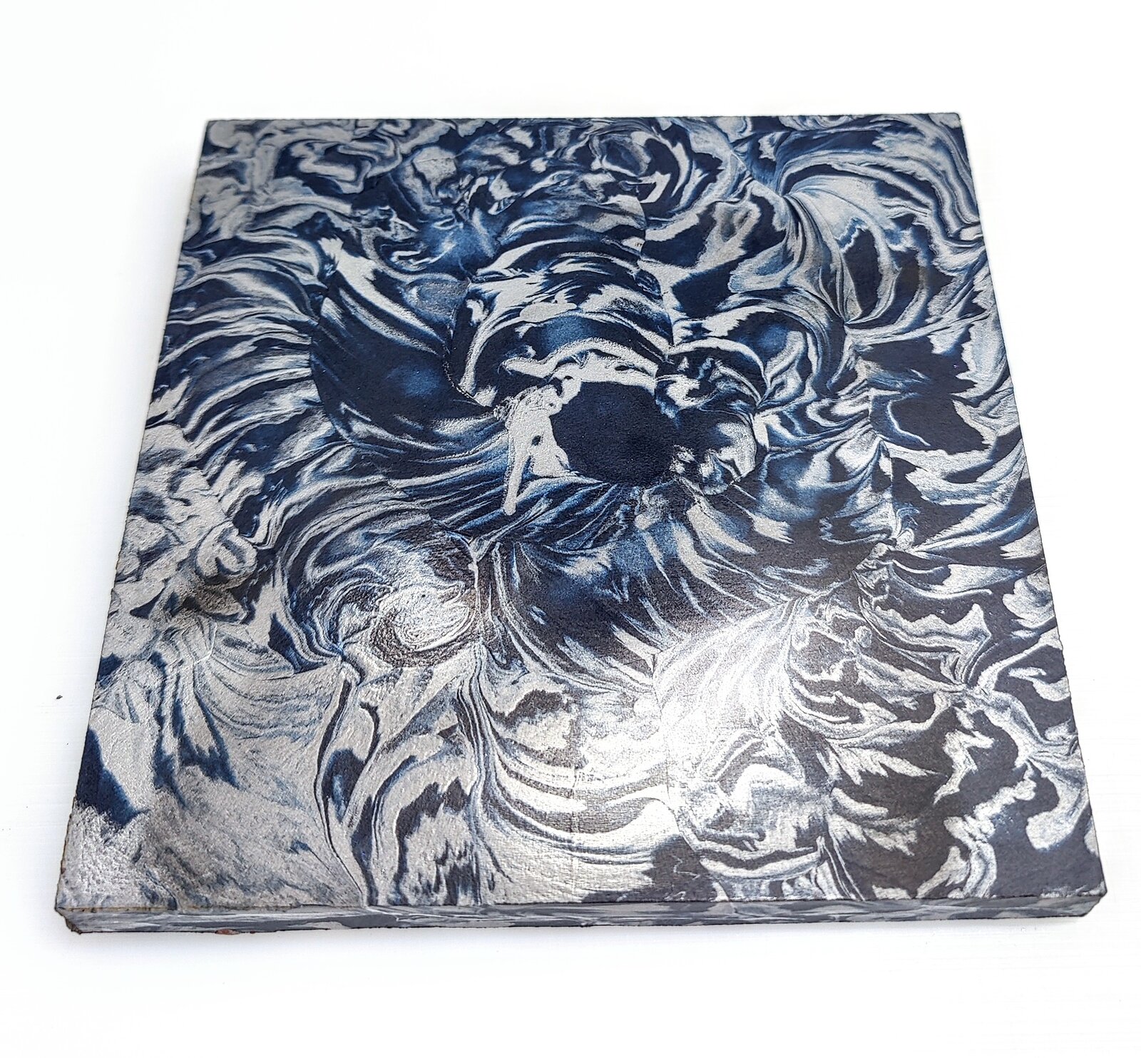

Mar 11, 2012
799
Fuquay Varina, NC
This is what he called Lapis blue with gold. Picture doesn't really show it but it's very metallic in person. Cast this as a 6x6x1 block to see what it would look like. It's a size that can be used for full size pen kits or cut into ring blanks even. (1.5x1.5 squares)
