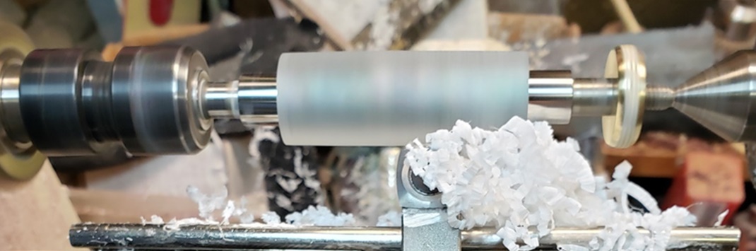

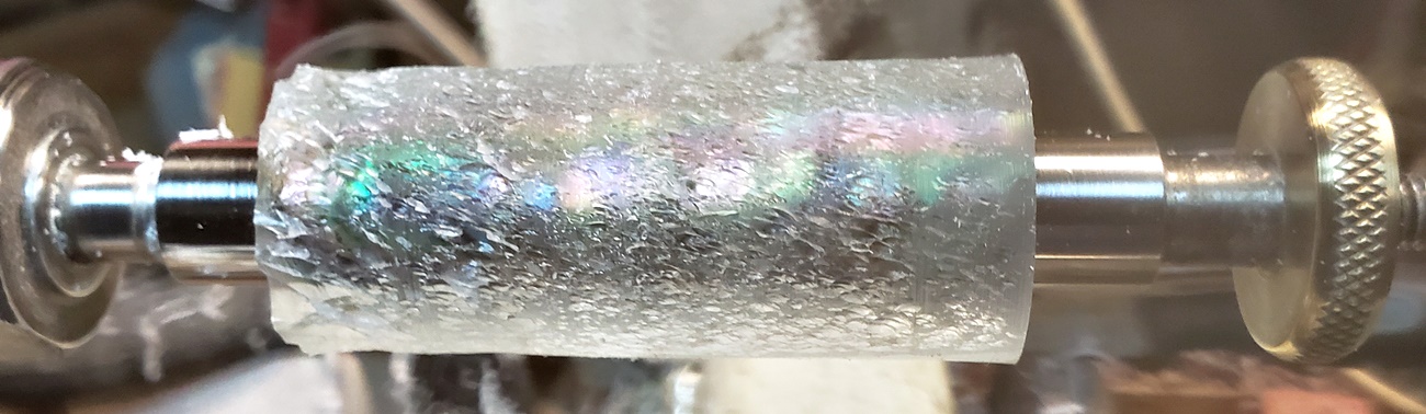

Like I said, I have my engraving done by a local trophy shop. I'm sure they have more than a "mini tabletop laser". I've never had a problem with them engraving acrylics in the past, but this is the first clear one I want engraved. After the pen is done, I'll take it in and see what they say about it.
Sent from my iPad using Penturners.org mobile app

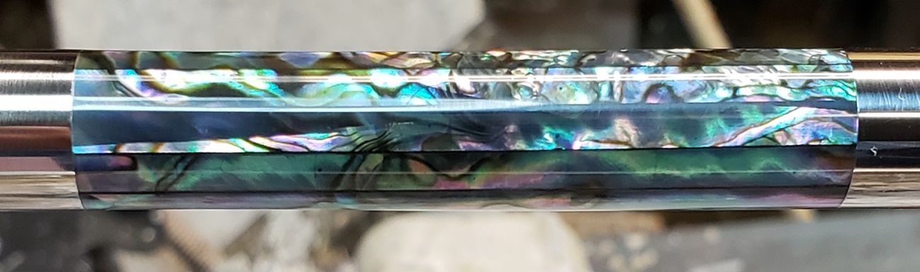

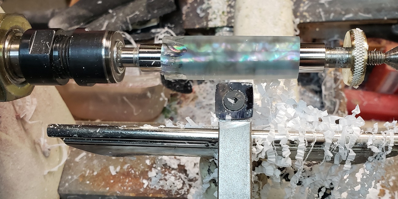

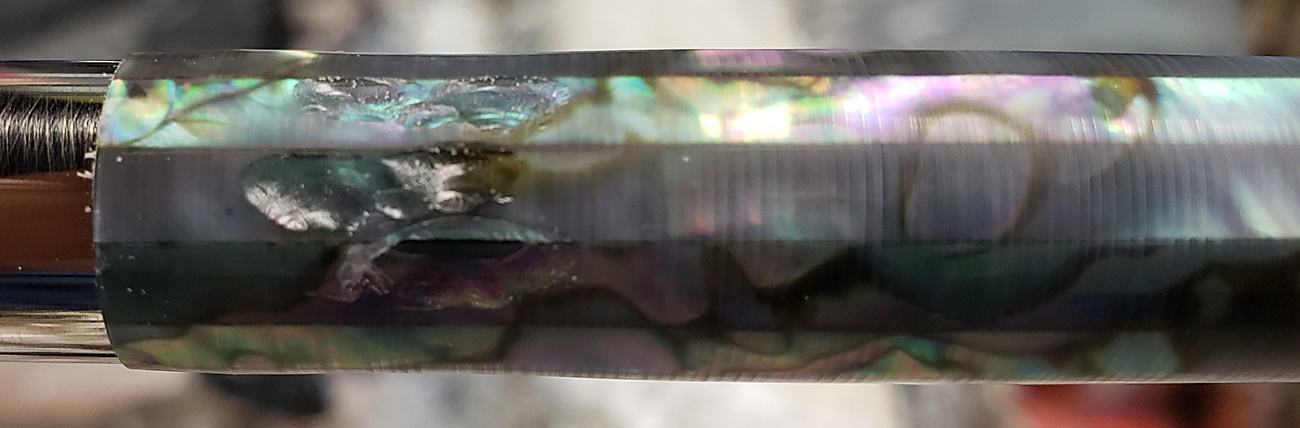

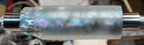

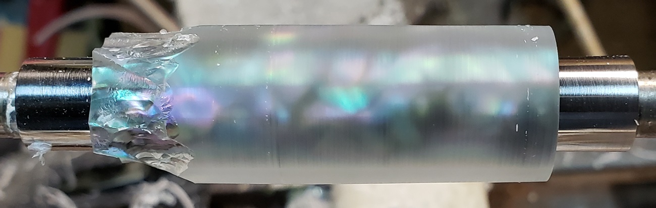

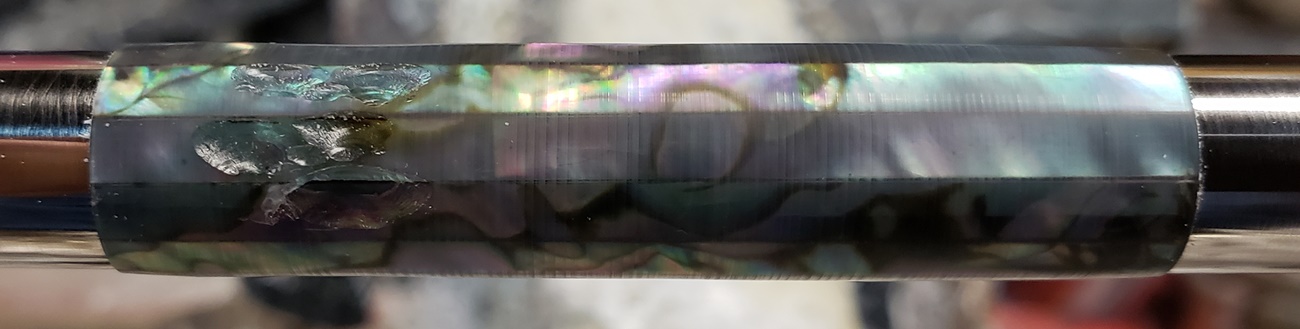

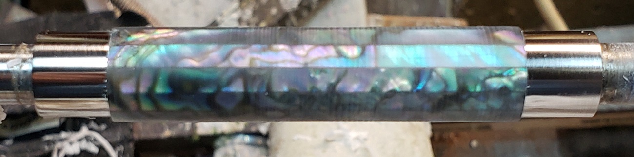

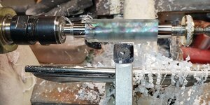

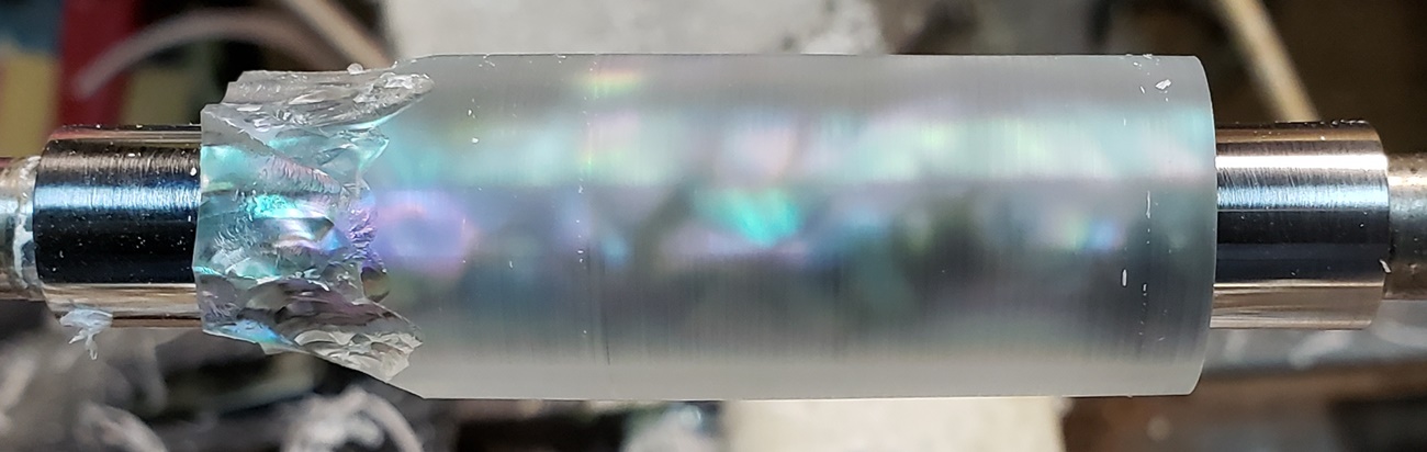

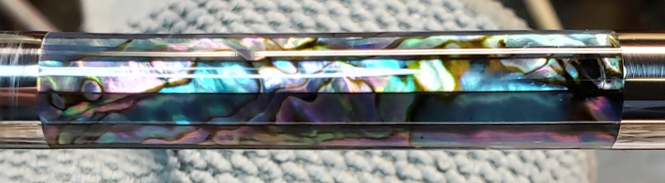

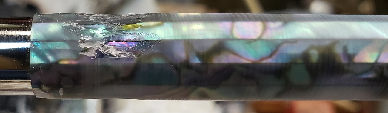

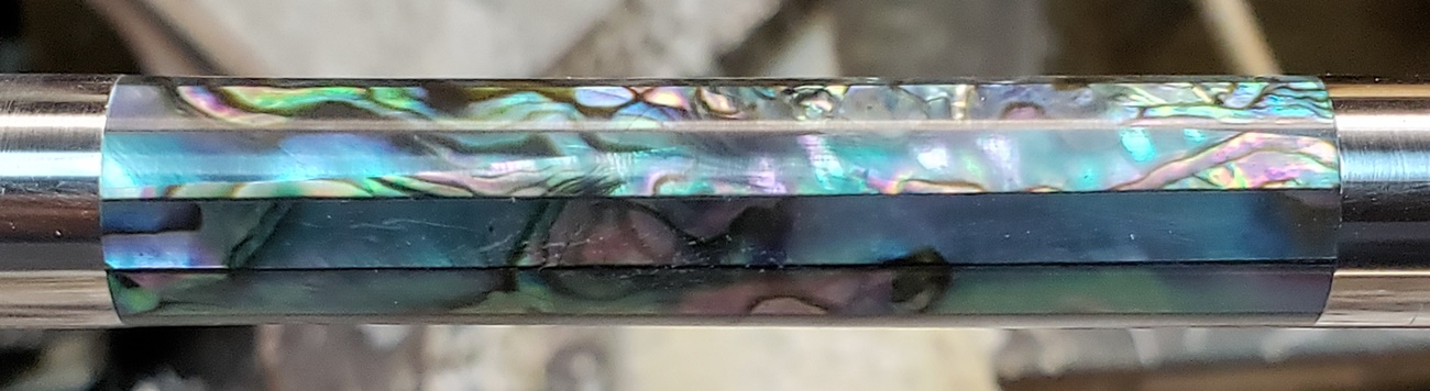

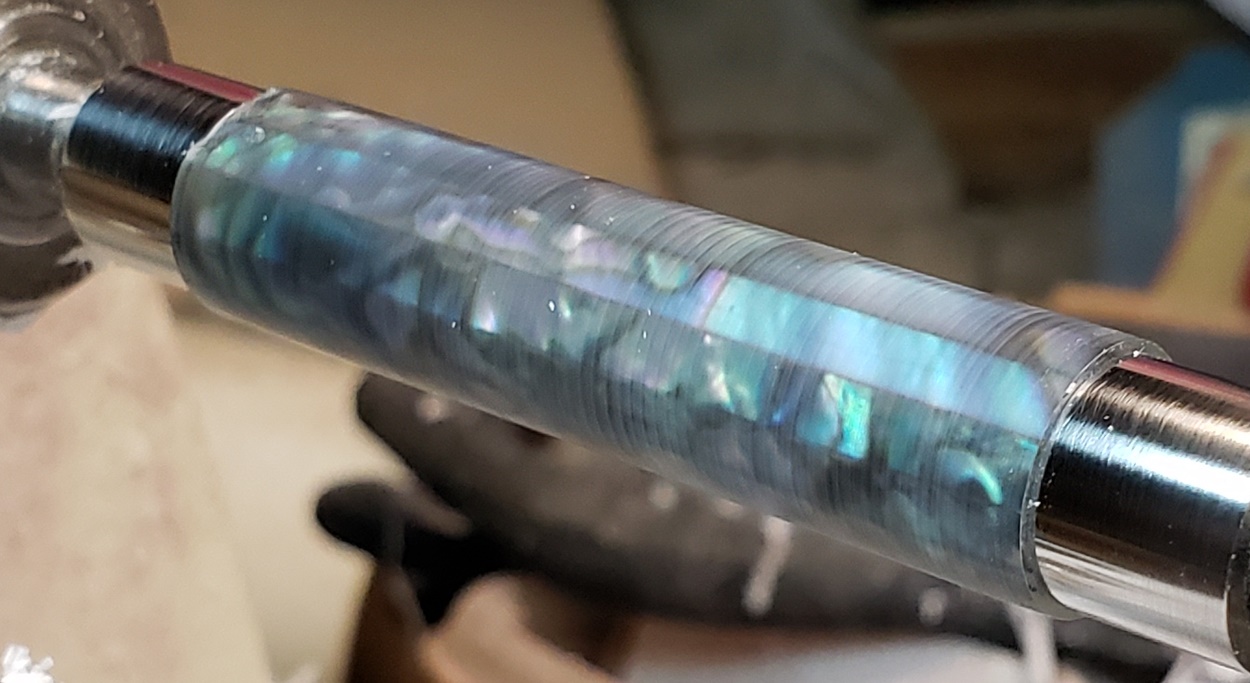

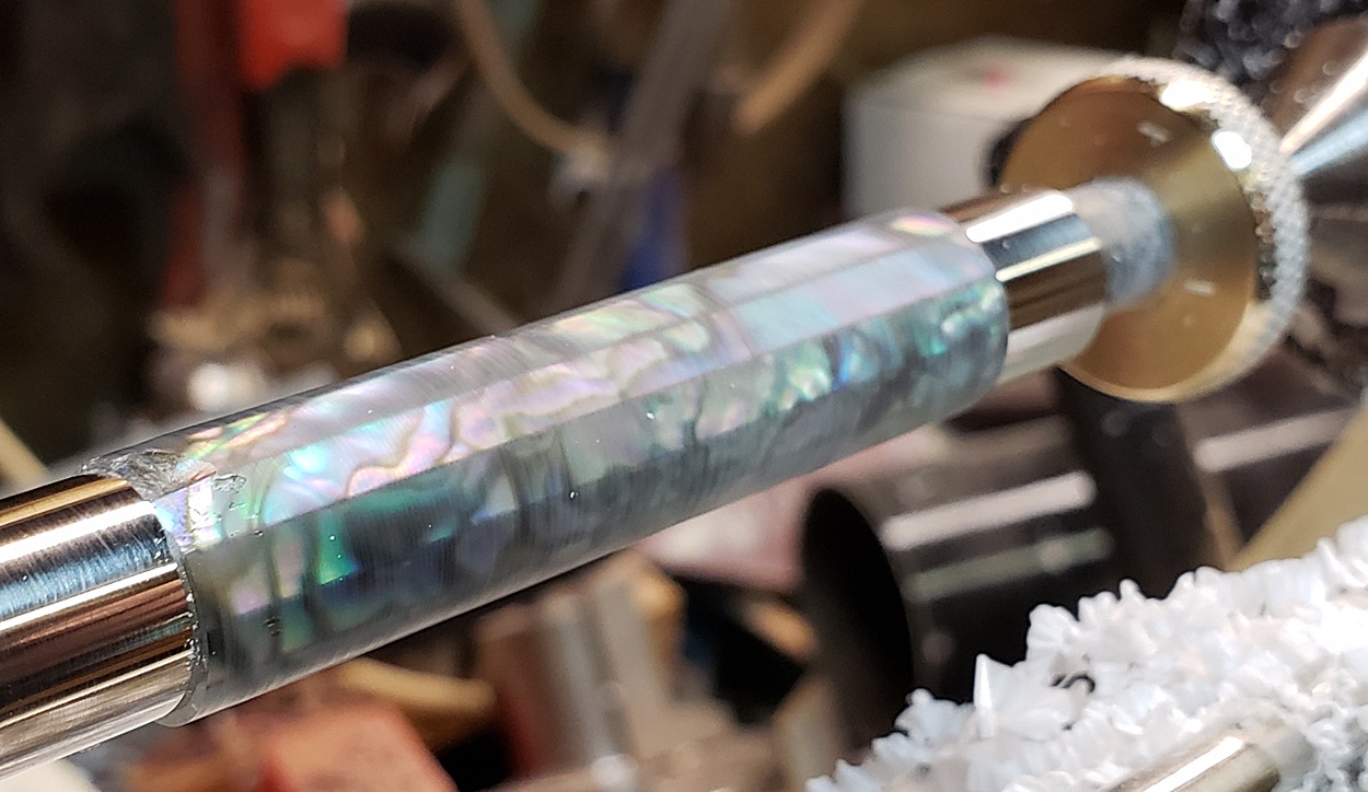

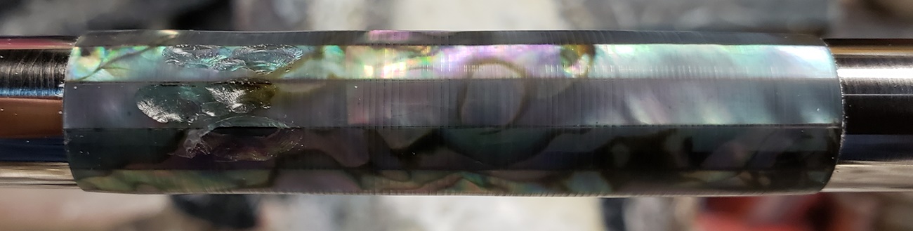

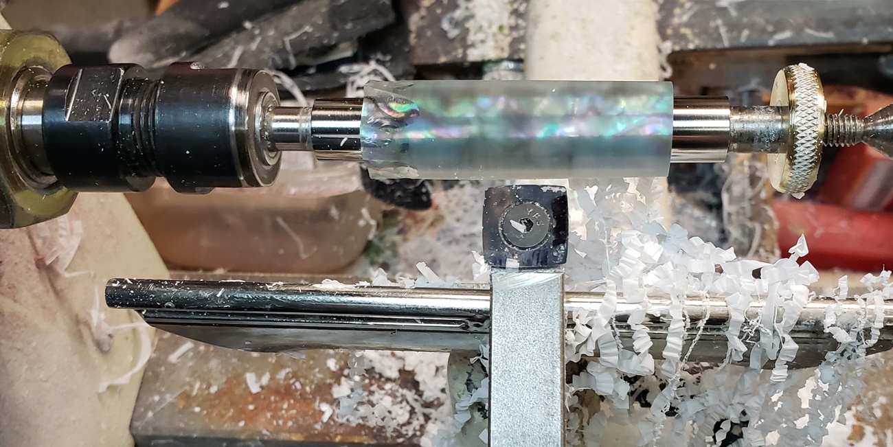

Yep, it's chippy. But it was my fault, I was being way too aggressive. The first was a HSS spindle gouge, and the bad one on the end was with a negative rake carbide.
Let me get this straight. You first used a HSS spindle gouge and got chippy and then switched to a negative rake scraper and got blowout on the end???????????? Did you use the scraper upside down?? No way any and I mean any scraper on any material will do that. Impossible!!!!!!!!!!!!!!!! What are you doing?? It is a simple acrylic PR resin cast blank. Looks like you took a grenade to it. :):):) Walk us through this. We are going to have to revoke your pen turning cardo_O Can you use a skew?? If so try that and do not use it as a scraper.

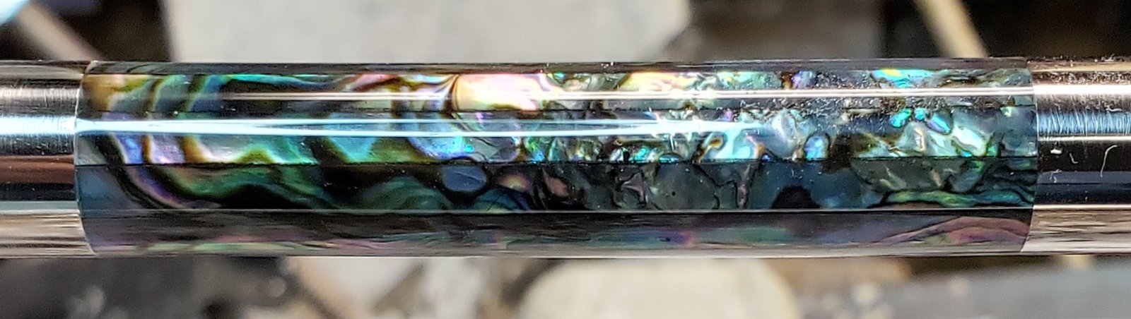

Thank you Ed, I appreciate the offer, but it's almost done. And since it's a wedding gift for a friend, I want to complete it myself. Like I said, it was purely my fault. I have a bad habit sometimes of being too aggressive. But in my defense, I have many, many more successes than failures.

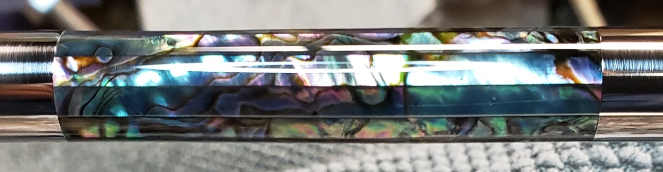

Well look at you you saved it and did a great job. Call off the marines.:) How did you wind up doing it and what tool worked best.

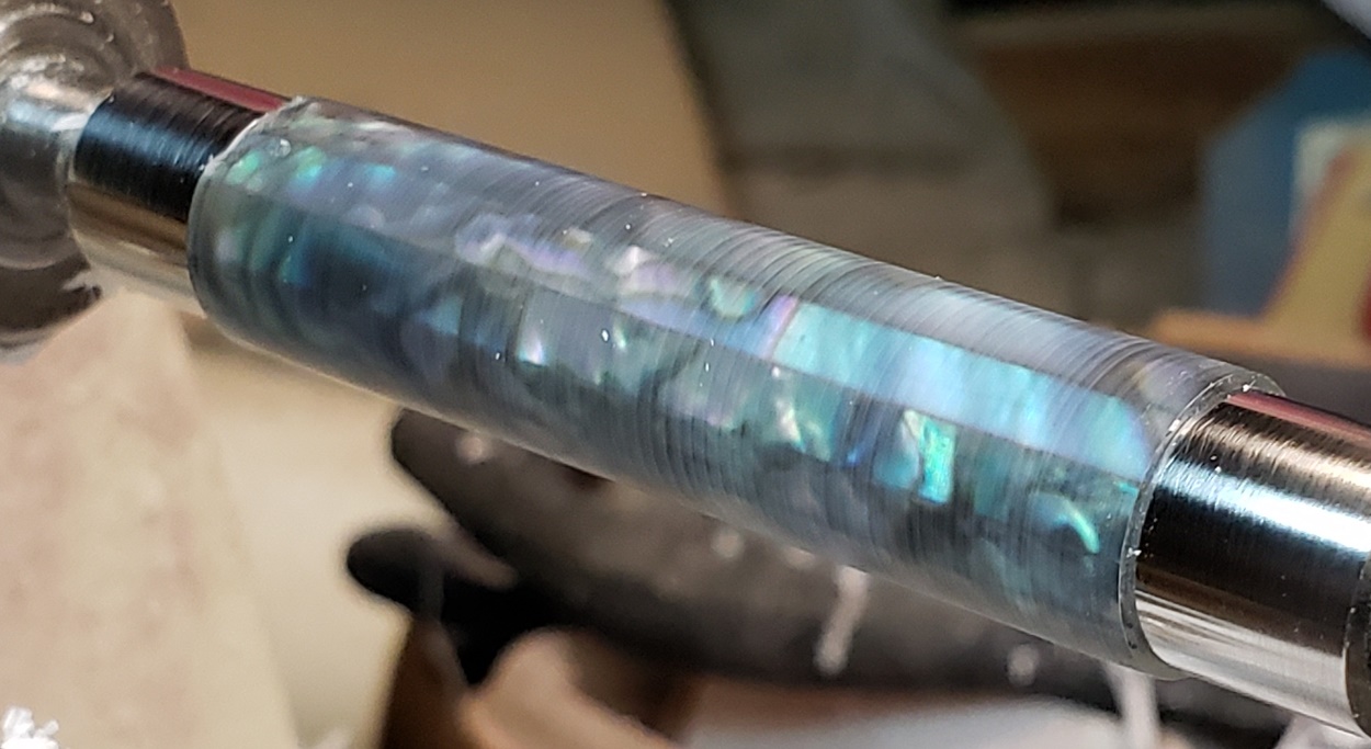

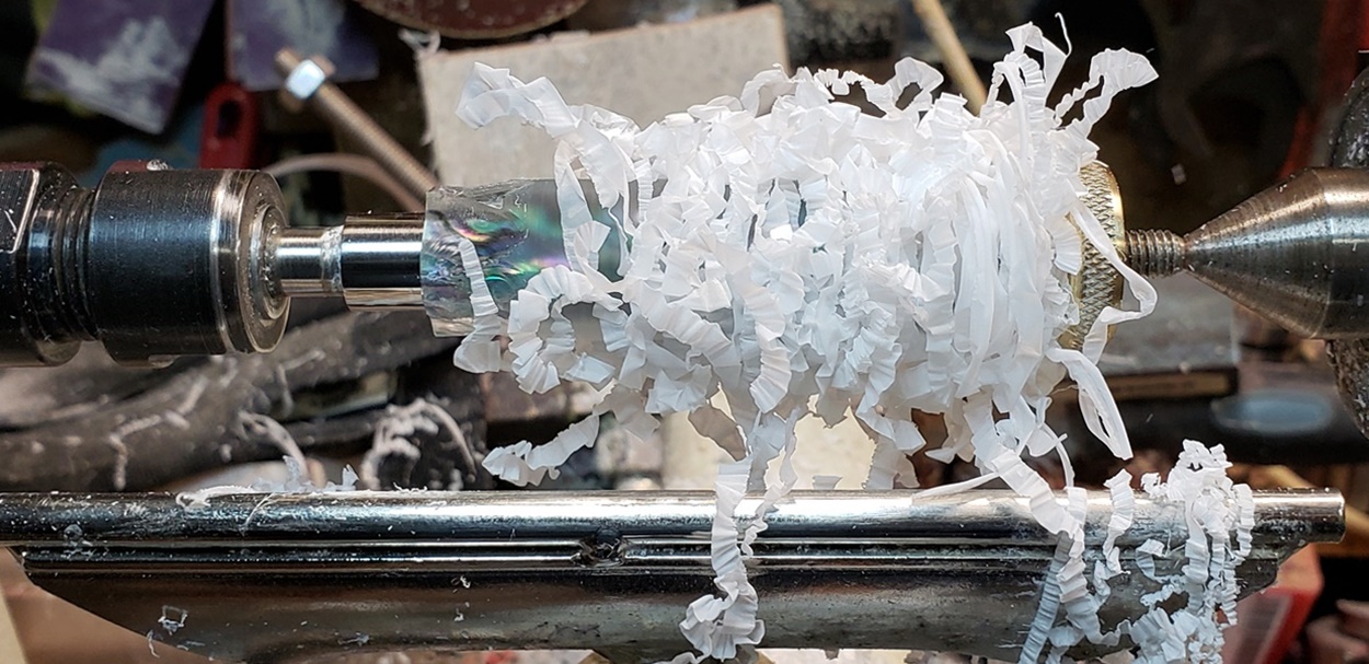

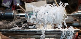

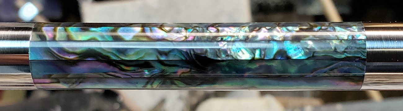

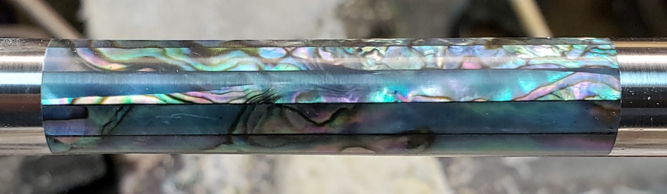

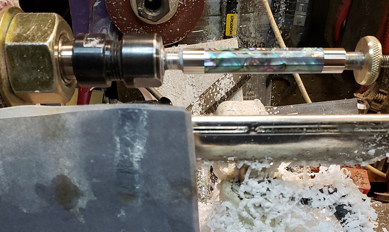

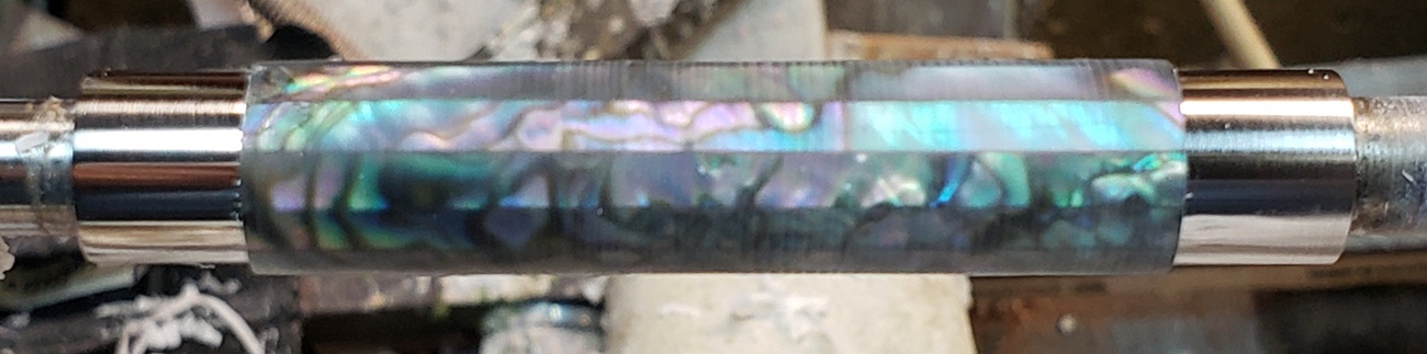

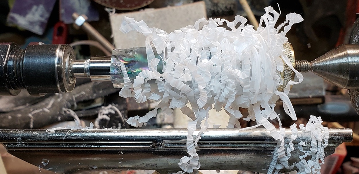

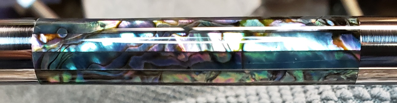

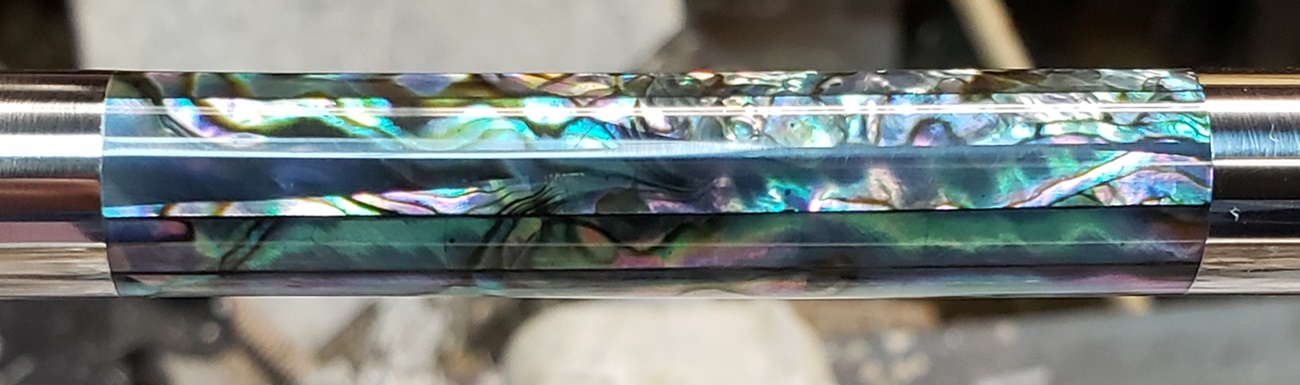

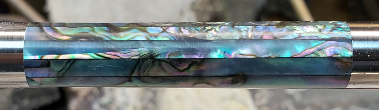

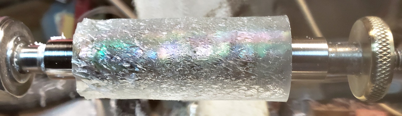

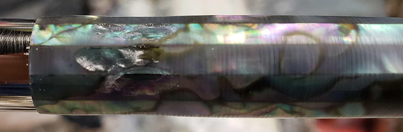

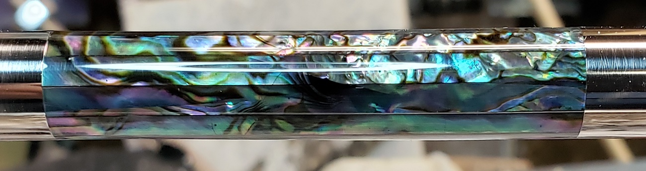

You know, I've been thinking about it, and I think the "grenade" happened when I lifted the handle of the chisel with the negative rake cutter too high. Because of the increased angle of the NR cutter, it got "under" the blank too far and really dug in. That's my theory, anyway. After it happened, I switched back to the standard cutter, was very, very careful, and took very light cuts. Like I said, all my fault, certainly not the fault of the blank. And when I said it was "chippy", I meant it was slightly more chippy than the stained glass blank I recently turned and finished. Nowhere near the chippyness of an acrylester blank. I got plenty of good ribbons from the abalone blank.

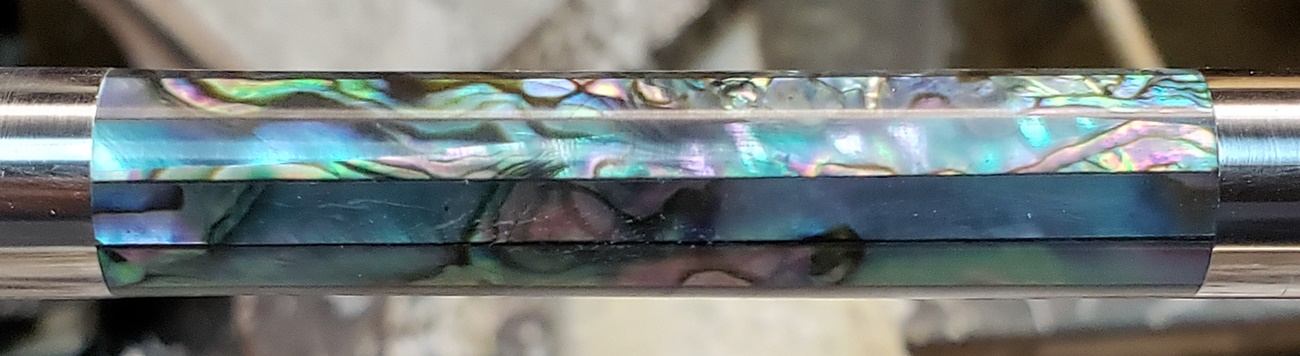

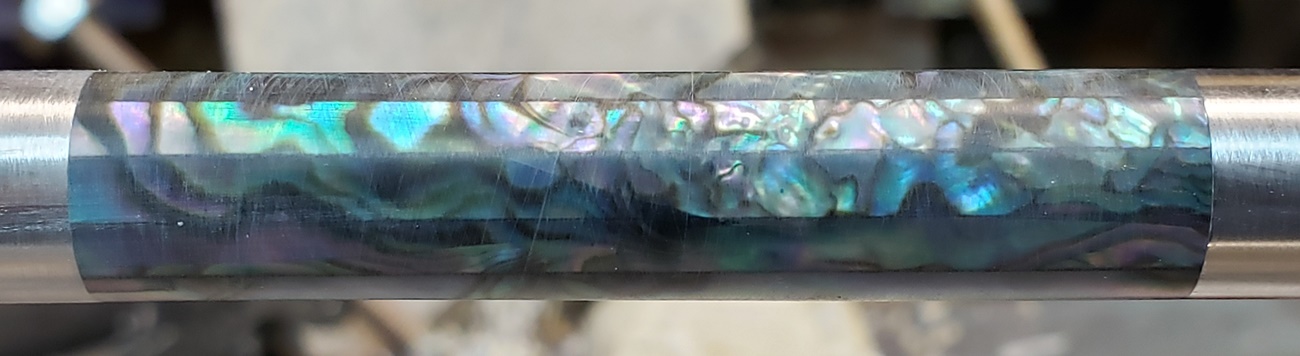

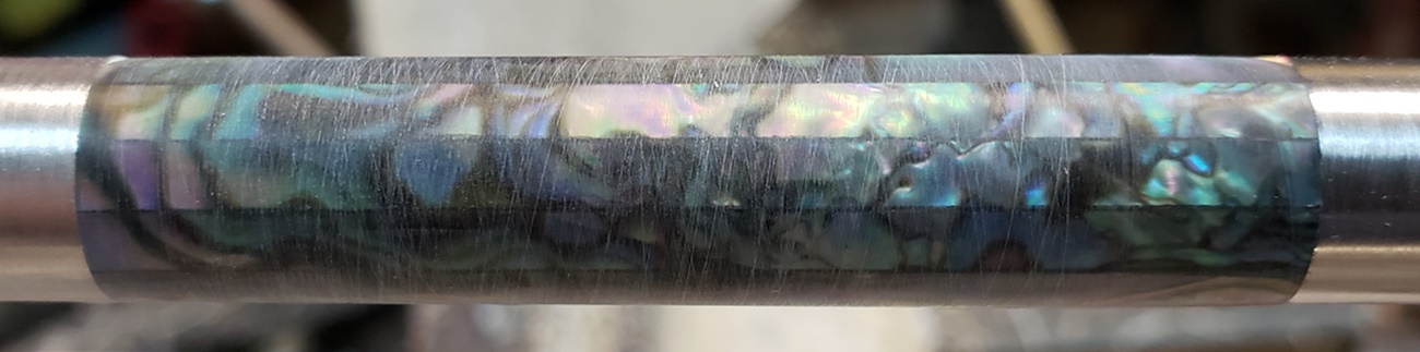

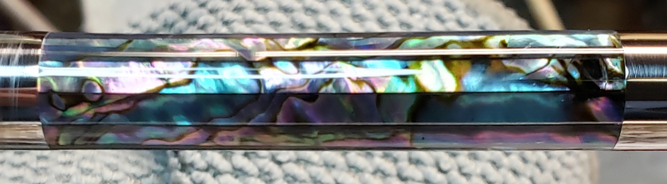

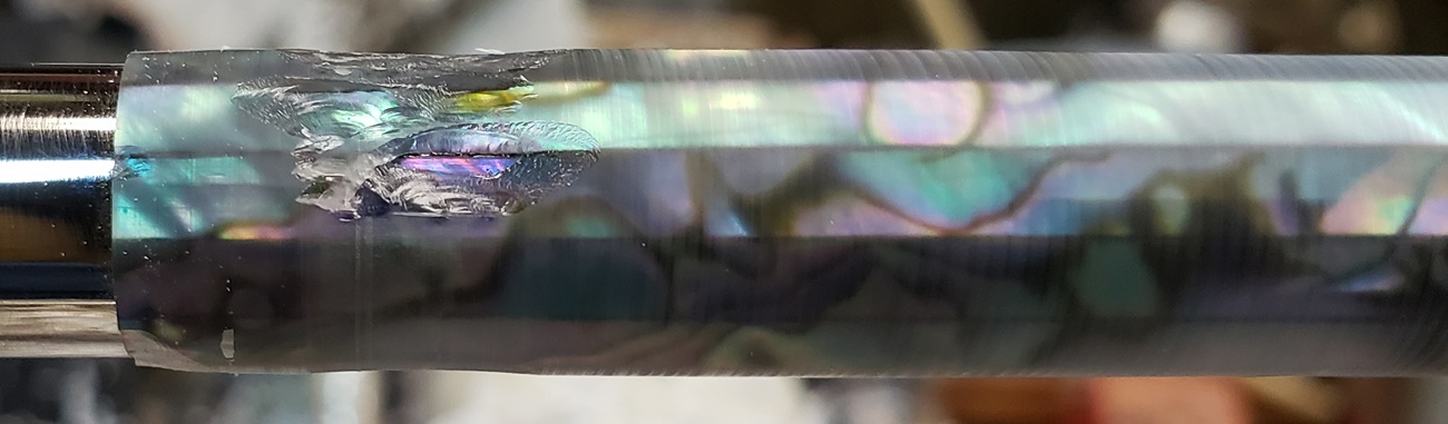

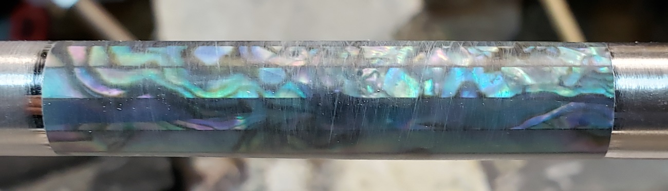

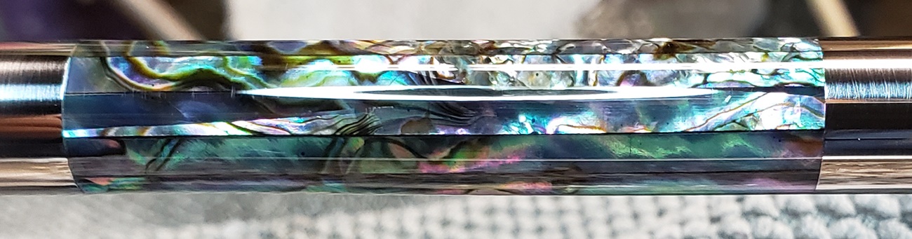

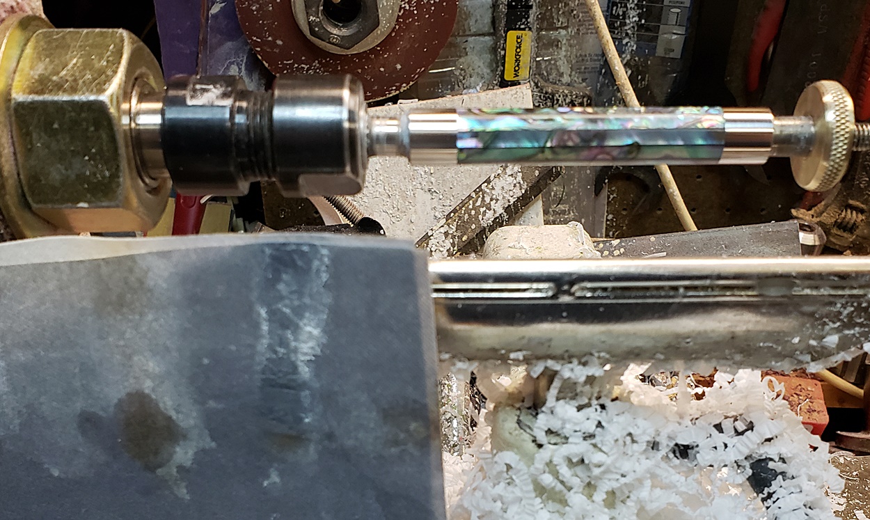

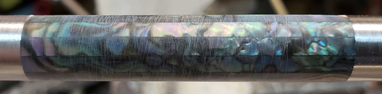

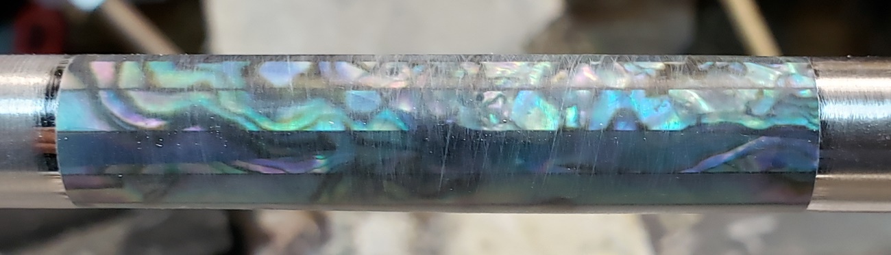

Well damn! I have no idea what I did here. I took a couple more very light passes after this happened, then decided to finish with 220, 320, and 400 wet.

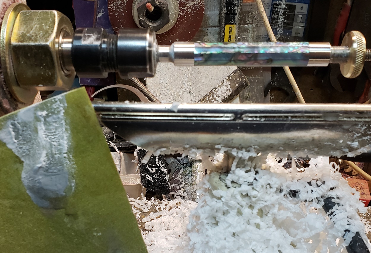

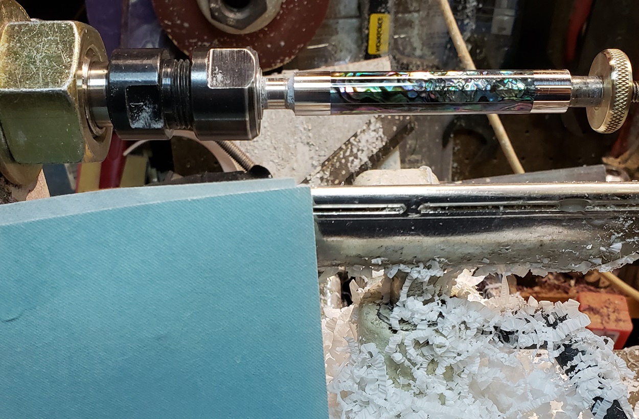

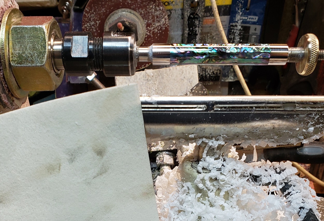

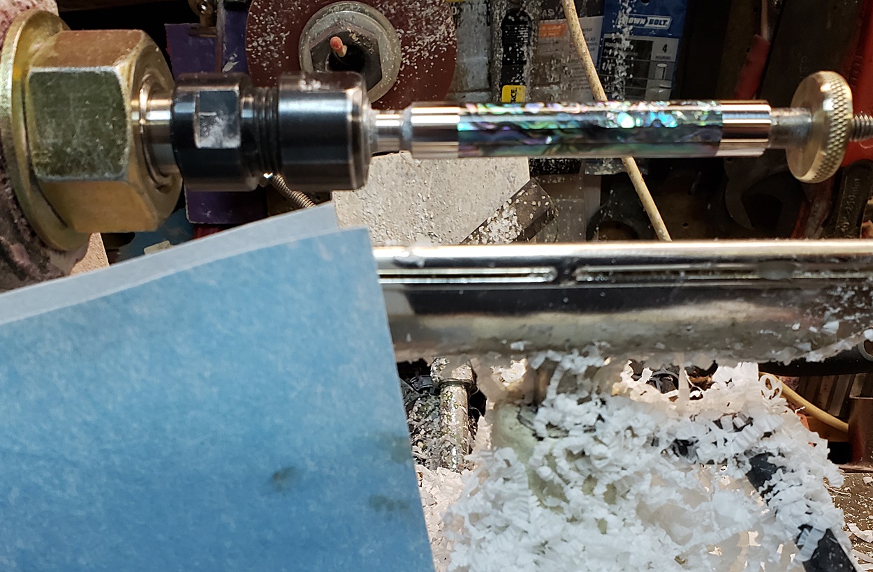

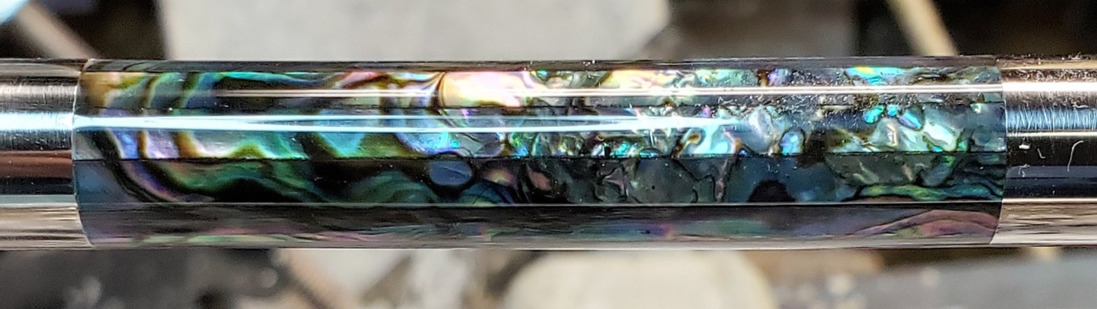

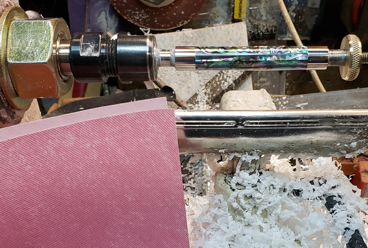

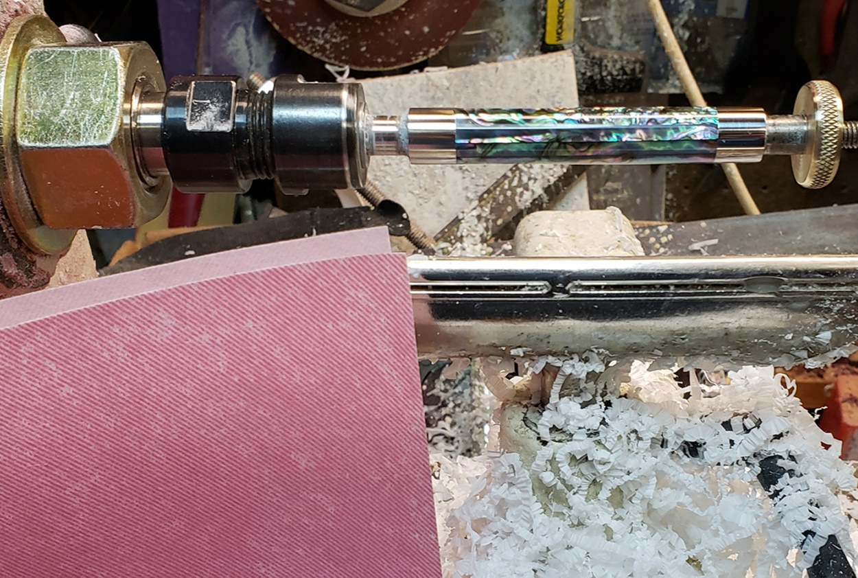

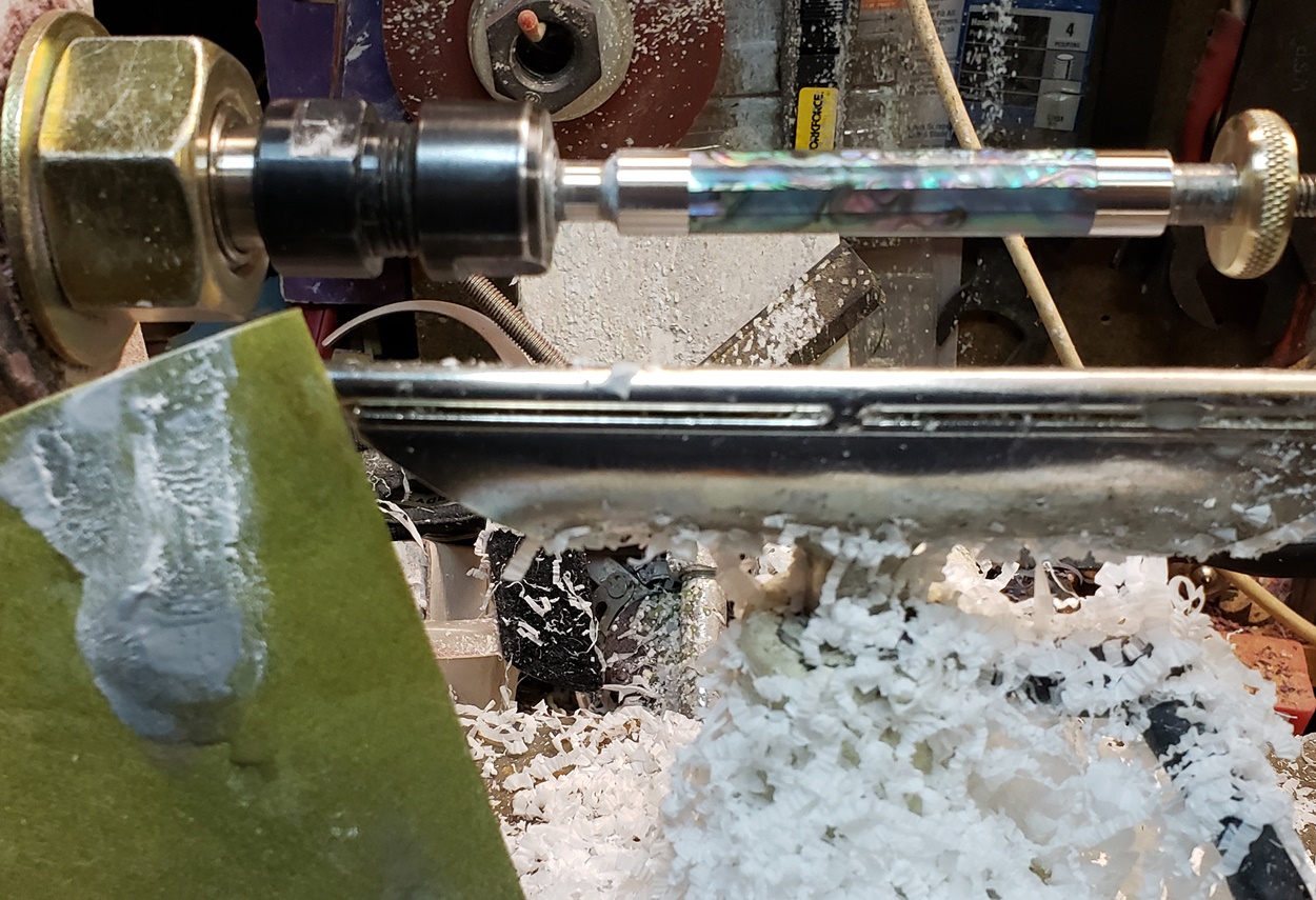

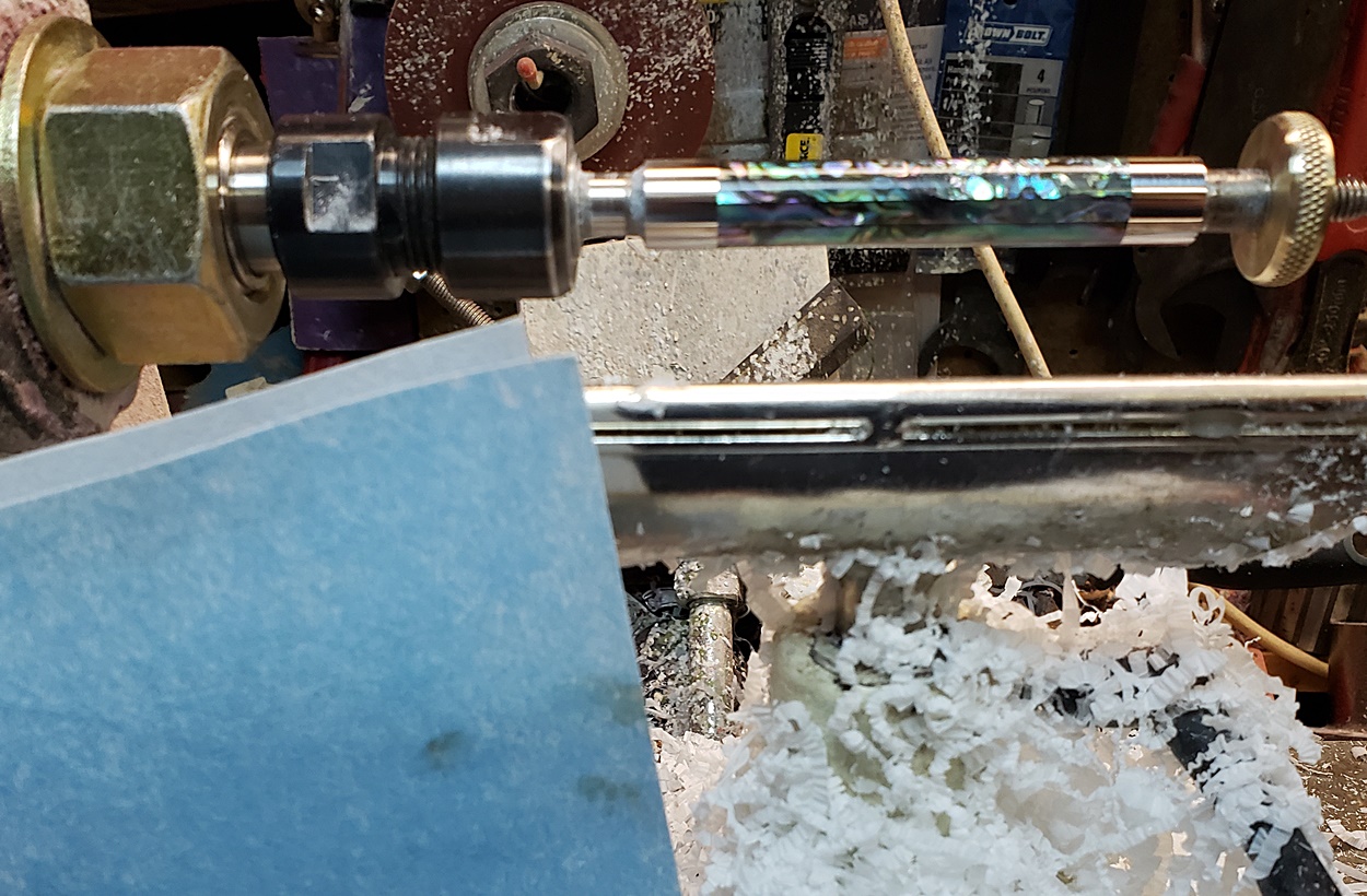

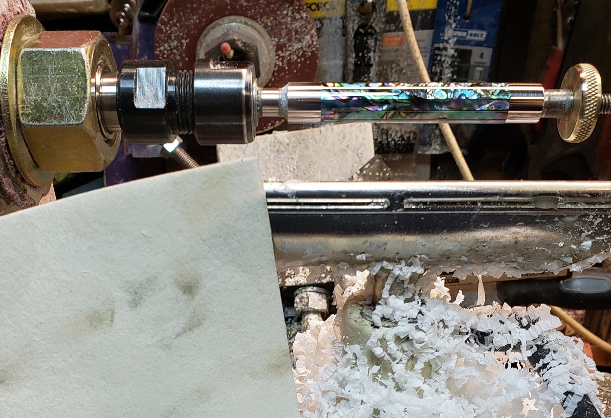

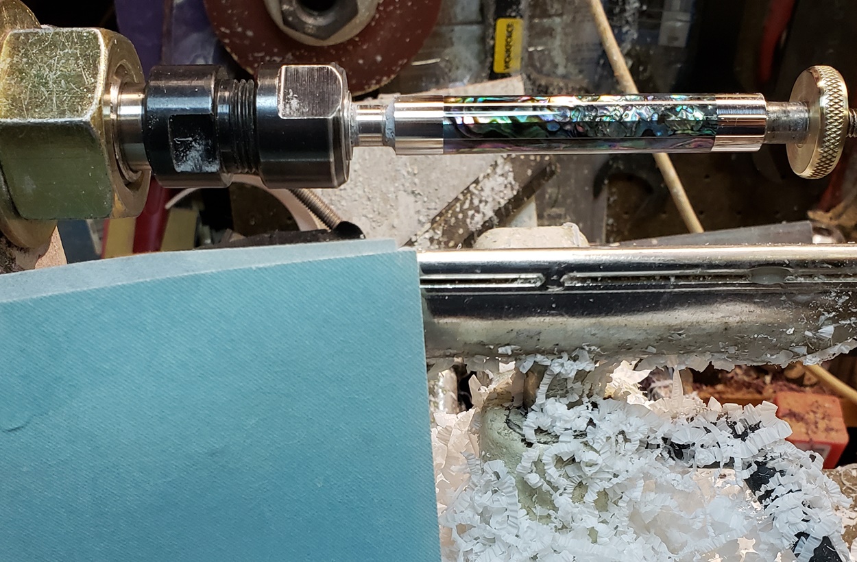

I am really becoming a fan of the 3M Tri-M-Ite polishing paper. I'm getting better results than with Micro Mesh, and there are only six grades vs. nine. And it polishes up the bushings real nice, too!

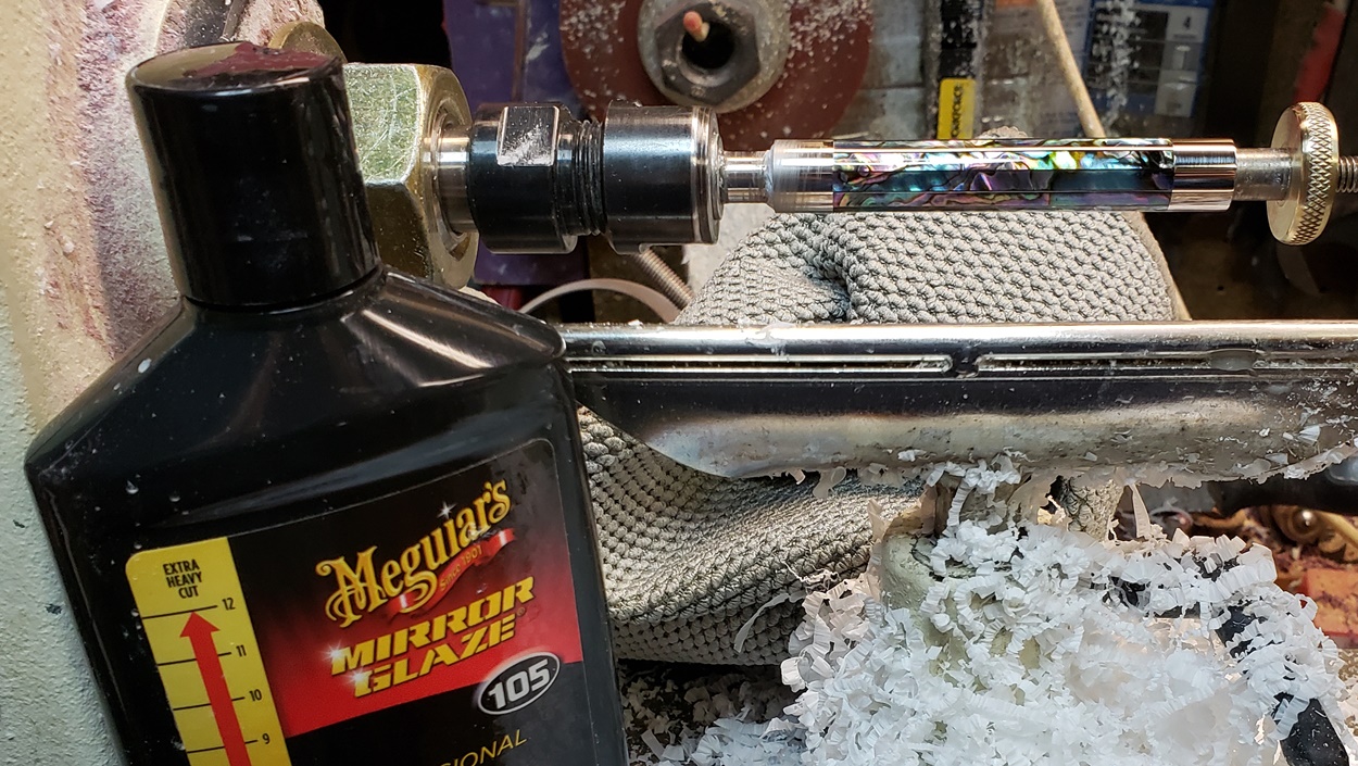

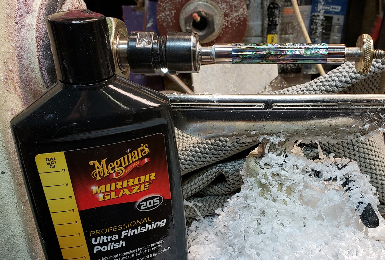

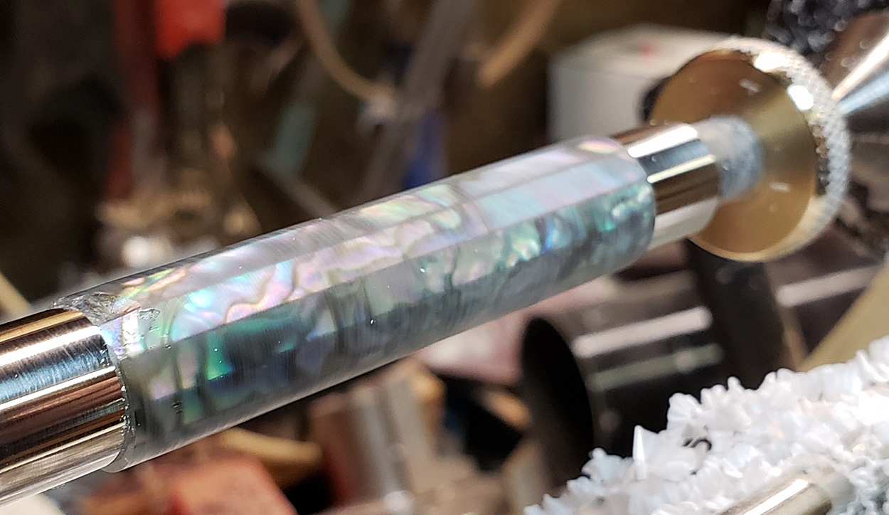

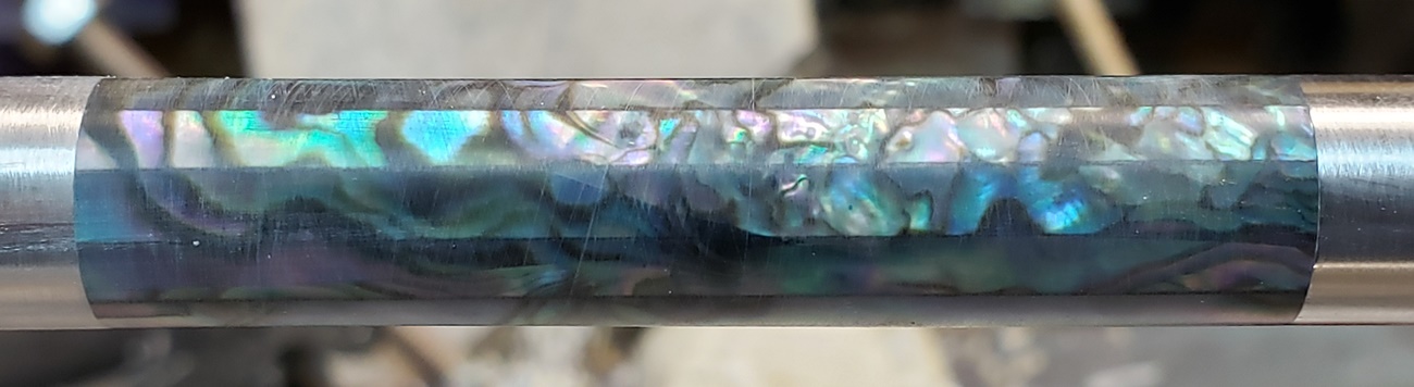

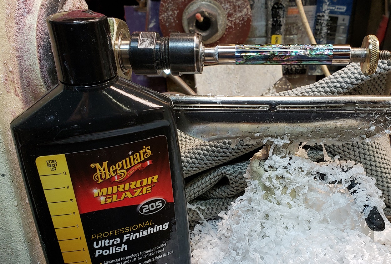

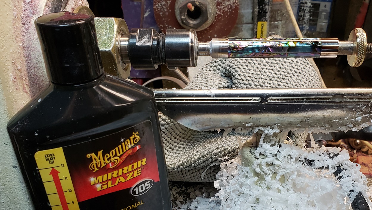

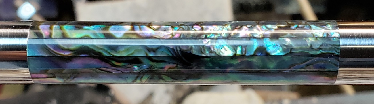

And finally, Meguiar's 105 then 205. I'm breathing a big sigh of relief, I almost ruined the blank a couple of times. It was close! But I must say, it looks magnificent. I think Lauren and Braydon will be very happy with it! Now I just have to assemble the pen. Can't wait to see it done!

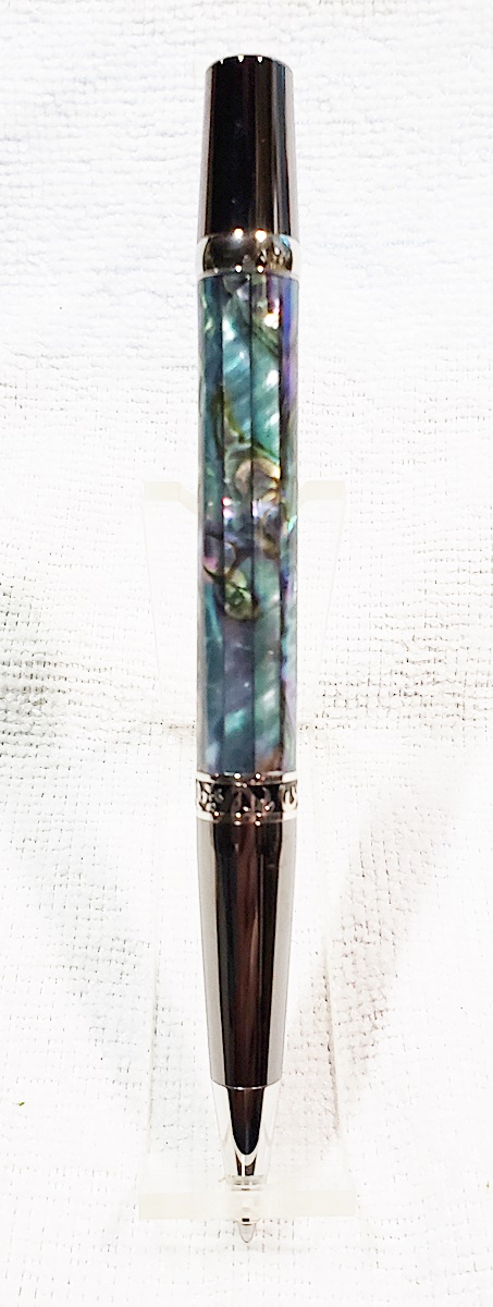

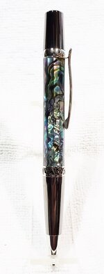

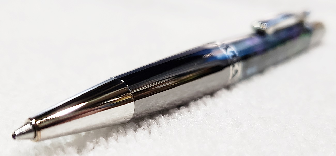

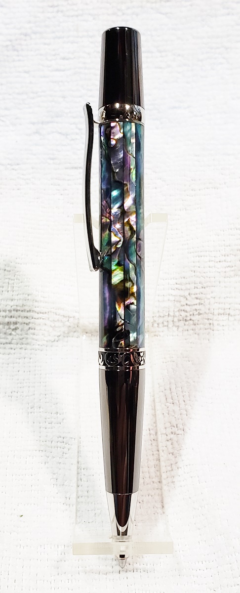

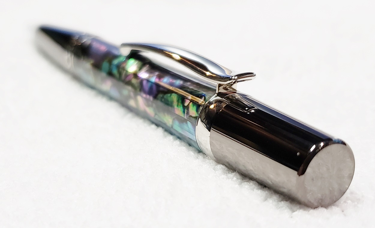

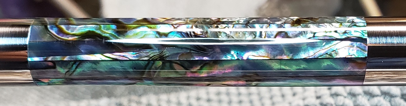

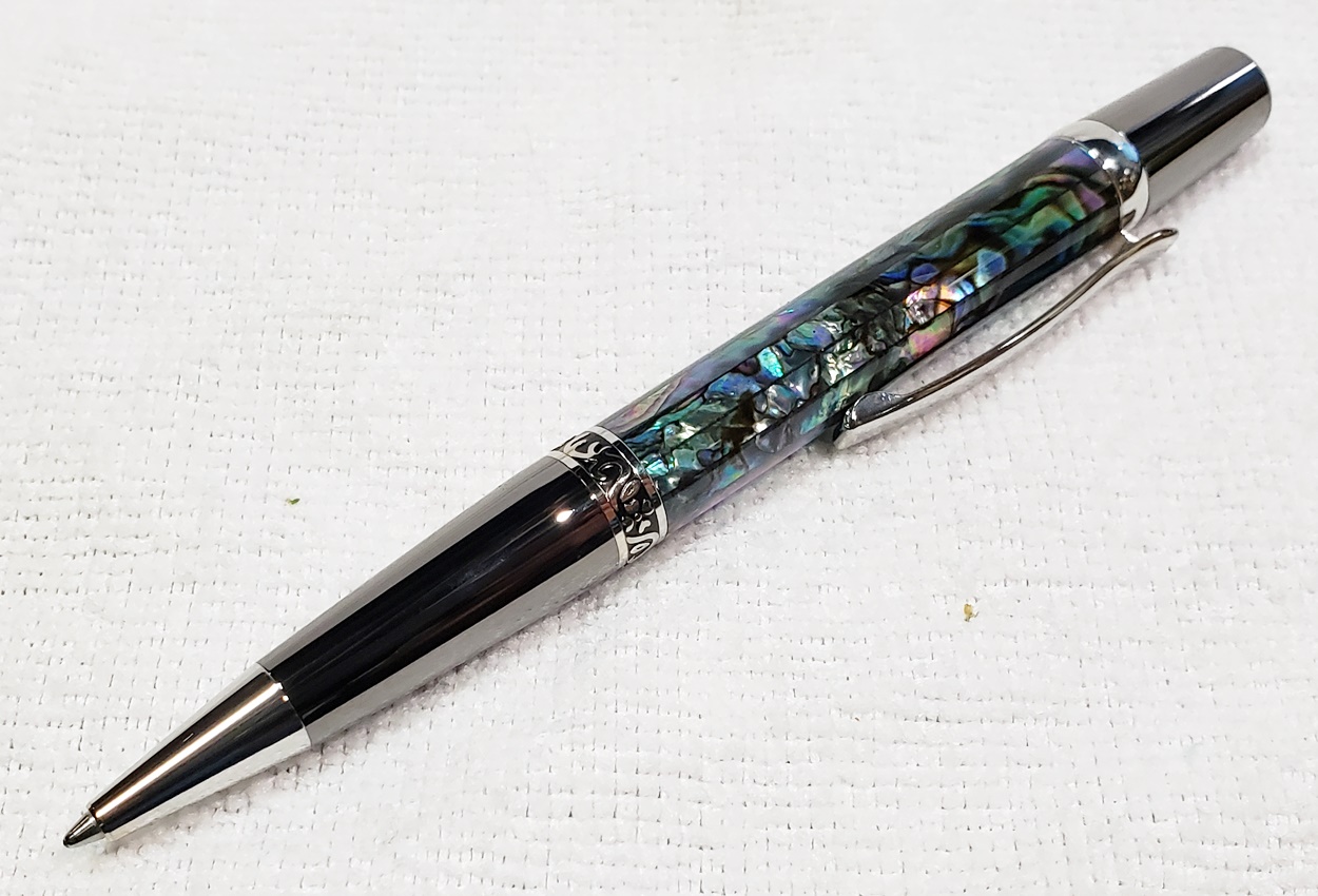

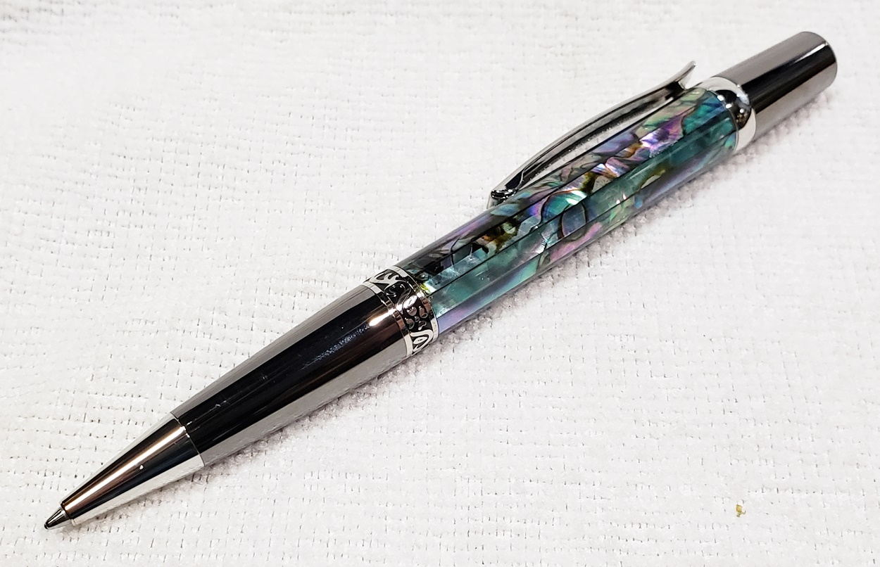

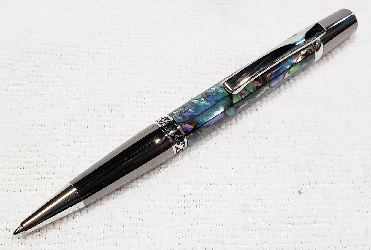

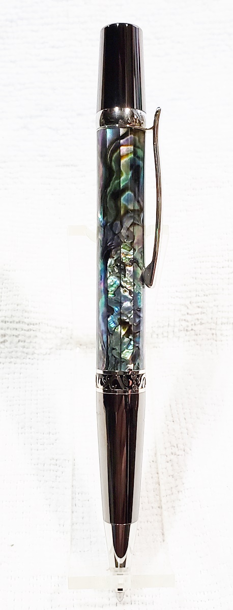

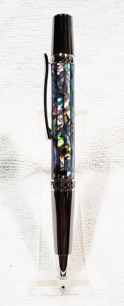

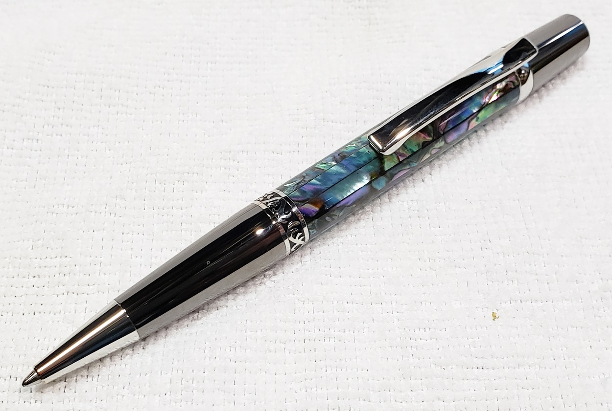

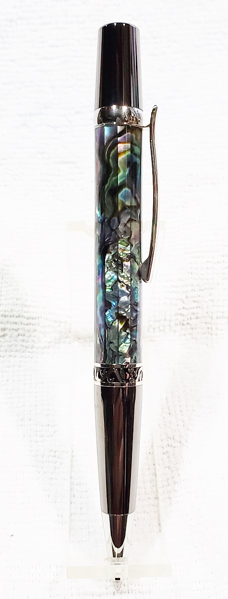

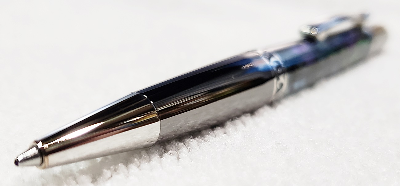

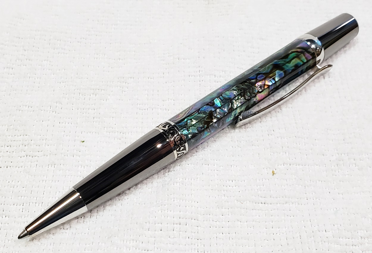

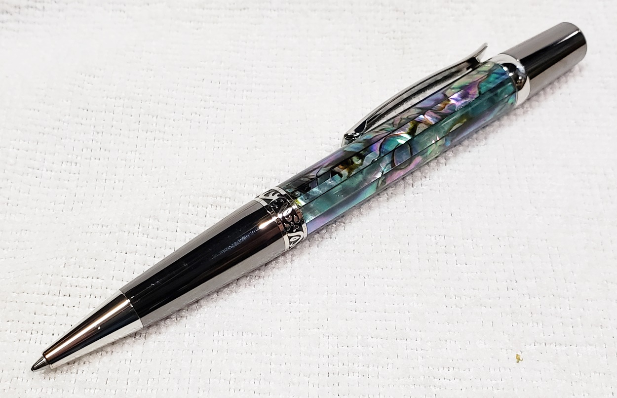

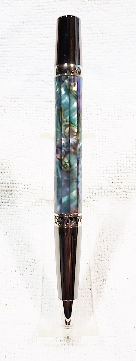

I am very happy with how this turned out, especially after the near disasters!

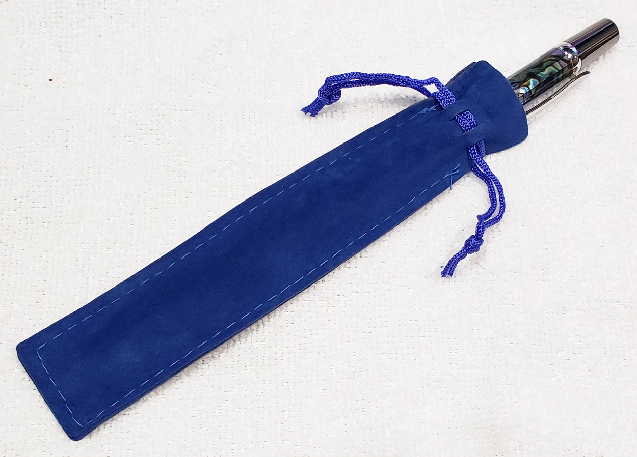

PHEW!!!!! You know Jim I was starting to feel real bad for you and the troubles this was causing. I know I made light of some of that and really just meant it as a joke thing to help get your mind off what was happening. I was getting ready to get on a plane and get out there and help you with this thing. I was going to bring my skew and shown you how to use it which I am sure would have helped tremendously. That is the tool for blanks that can go boom. A good sharp skew will out perform even a round carbide cutter in my opinion.
Glad to see this done and yes the saves were impressive. It came out just fine and wish you luck with the engraving. That material makes for such a classy looking blank and now all polished up it sparkles. Thanks for keeping us in the loop and again hope you did not take my comments too hard. Keep on turning. Now that you have one under your belt I am sure Ed can expect an order for many more.
You should have flown out John, I'd have bought you a beer. Or a vodka cran. Or CBD gummies. LOL

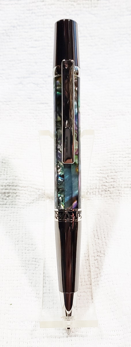

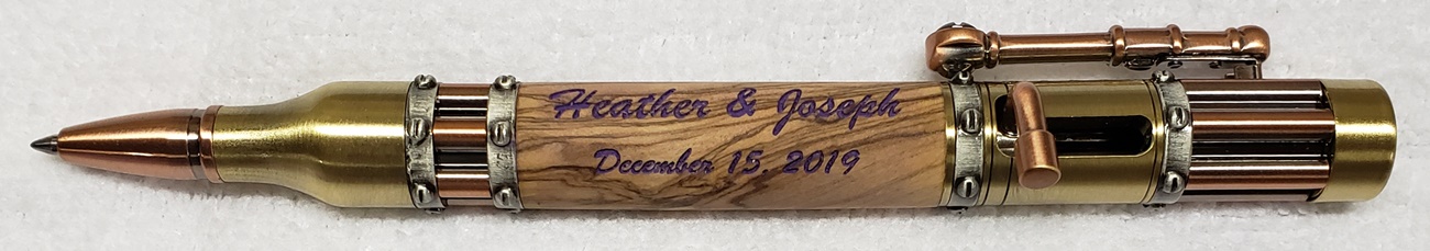

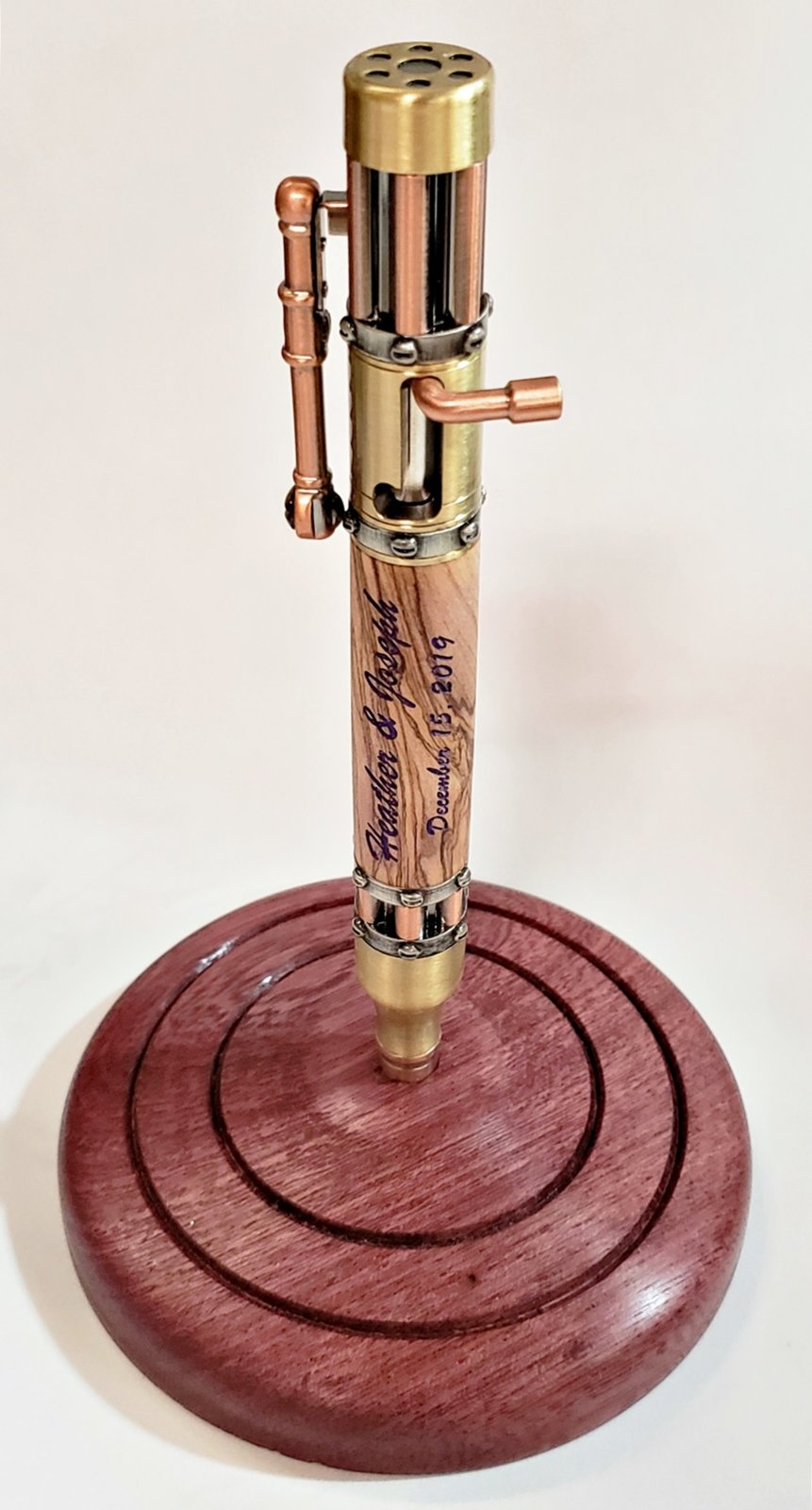

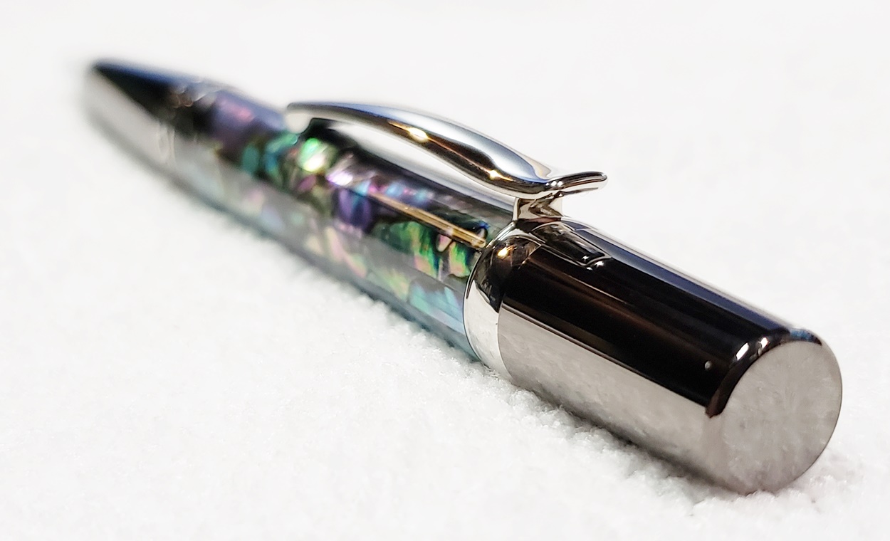

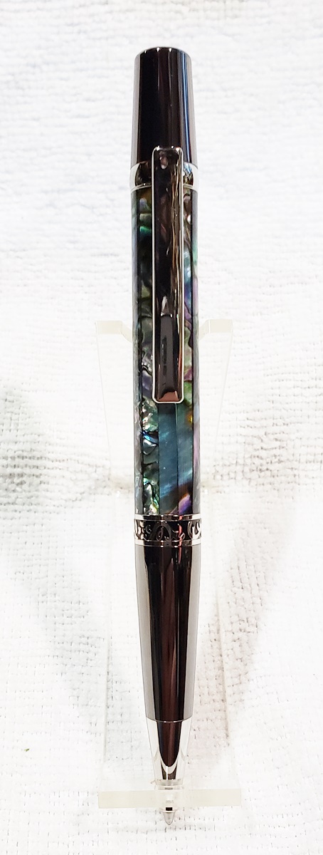

One thing I've never learned to use correctly is a skew. I have several, have watched videos online, but just can't get it. I do use them as scrapers from time to time, but that's it. Gouges have served me well for over twenty years, though, and learning the skew isn't a high priority for me. As for turning more abalone blanks, I don't know. They're very expensive, and the mistakes I made were very nerve wracking. It was worth it in the end, of course, the pen is magnificent. And Lauren is beyond excited about it. She chose the blank, and the abalone is perfect, since she's getting married on the beach in Mexico. I would have to say it's my second favorite pen I've ever made, behind my son's wedding pen, of course. But his was Bethlehem olivewood, which is much easier to turn.

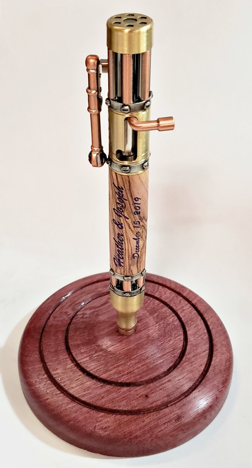

Yikes! Qquake does a victory dance with power mooning on that one! I've had that sort of experience with the Thin Red Line plastic blanks, except that they tend to explode, rather than chip heavily. It takes me an average of 1 1/2 blanks to make one Fire Fighter pen.
I'm having images in my head of your son having a Steam Punk wedding...

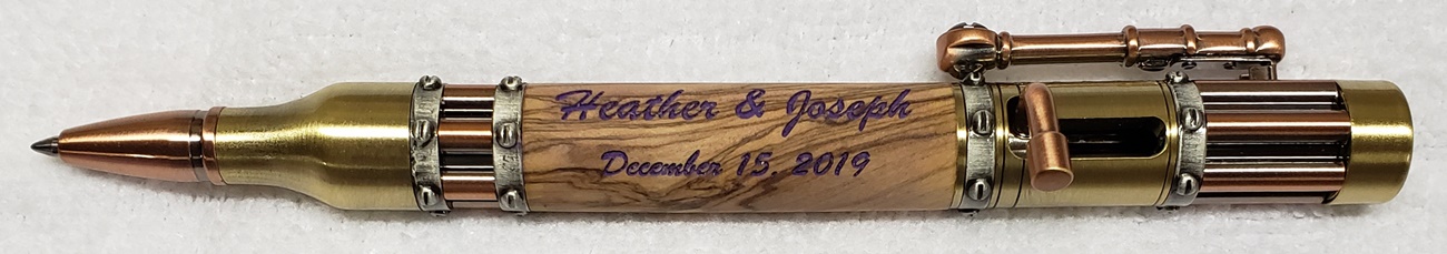

Actually, it was more of a country theme, than steampunk. I chose the steampunk kit because it matches my daughter-in-law's personality. She has tats and piercings. Everyone wore cowboy boots, including the girls. My son and the groomsmen all wore bib overalls, as did I, the bride's father, and my ex-wife's husband. I may be biased, but it was the best wedding I've ever been to! And yes, those are handcuffs. The officiant put them on Heather and Joe during the ceremony. Afterwards, they couldn't find the key. Fortunately, my son is a corrections officer, and several CO's attended. One of them had a key in his car. They were really sweating it!

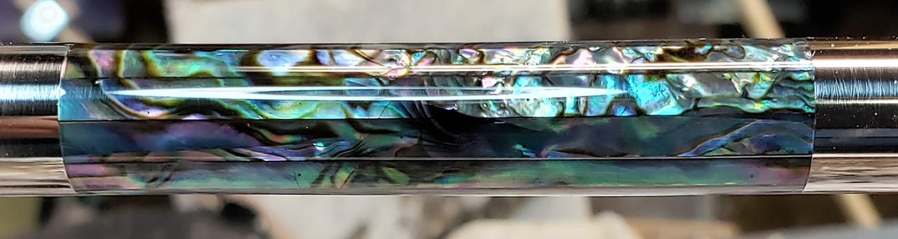

@qquake I have a question for you. In post #53, image 044, it looks like that blow out went all the way down to the paua shell. Did it? If it did how did you repair that so seamlessly?
That is a great looking pen!
