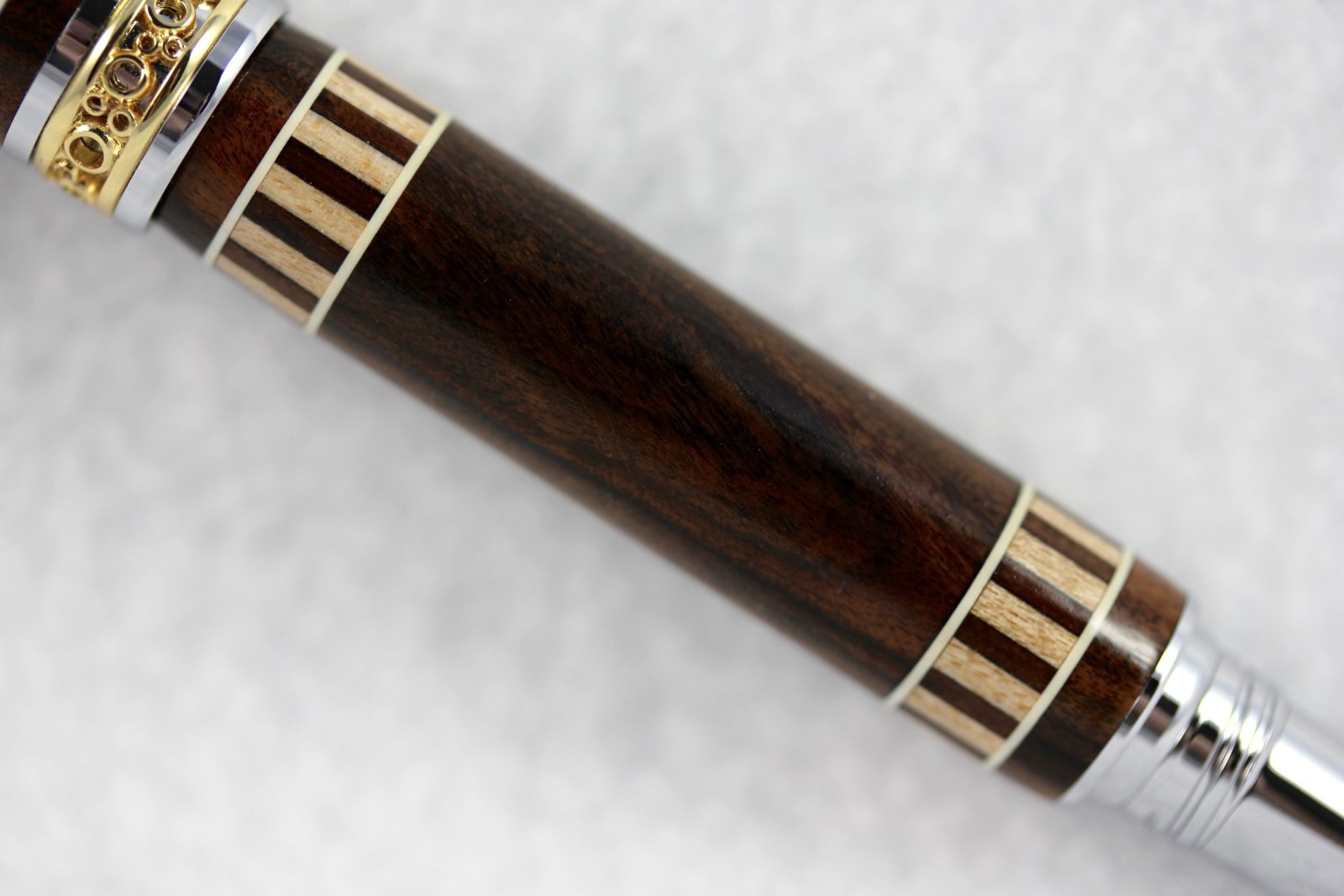

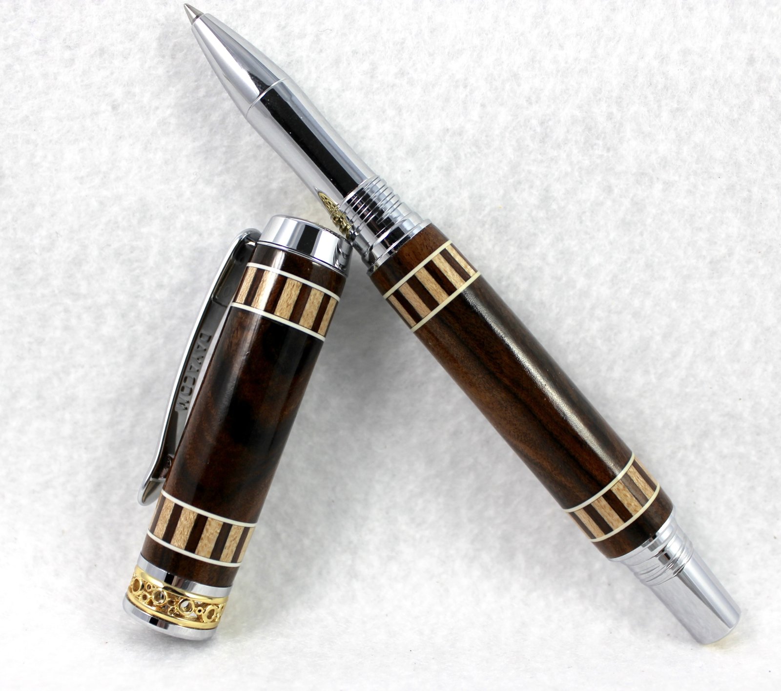

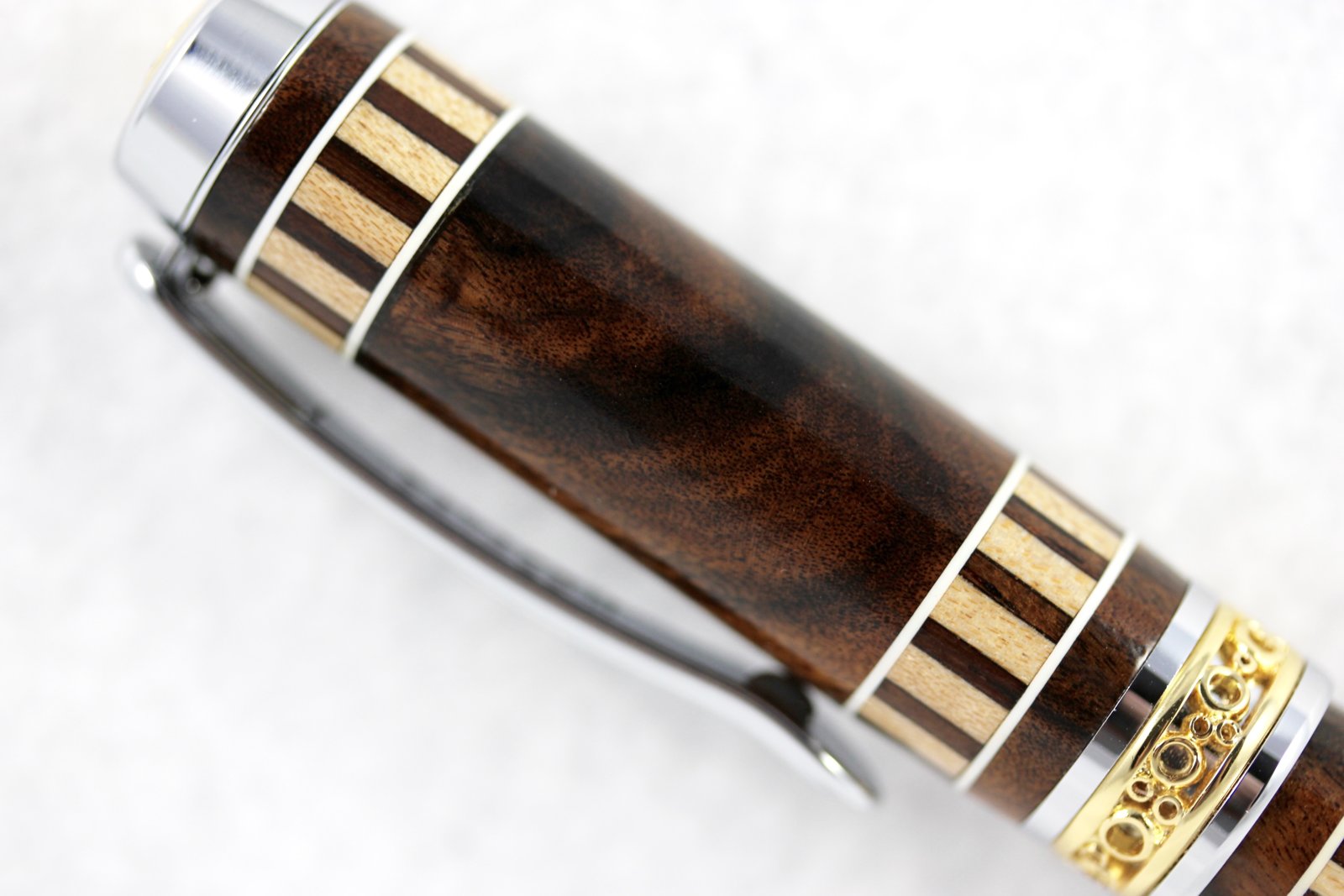

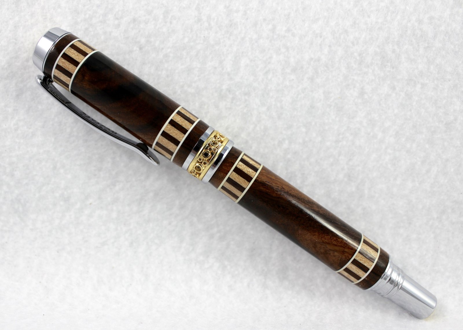

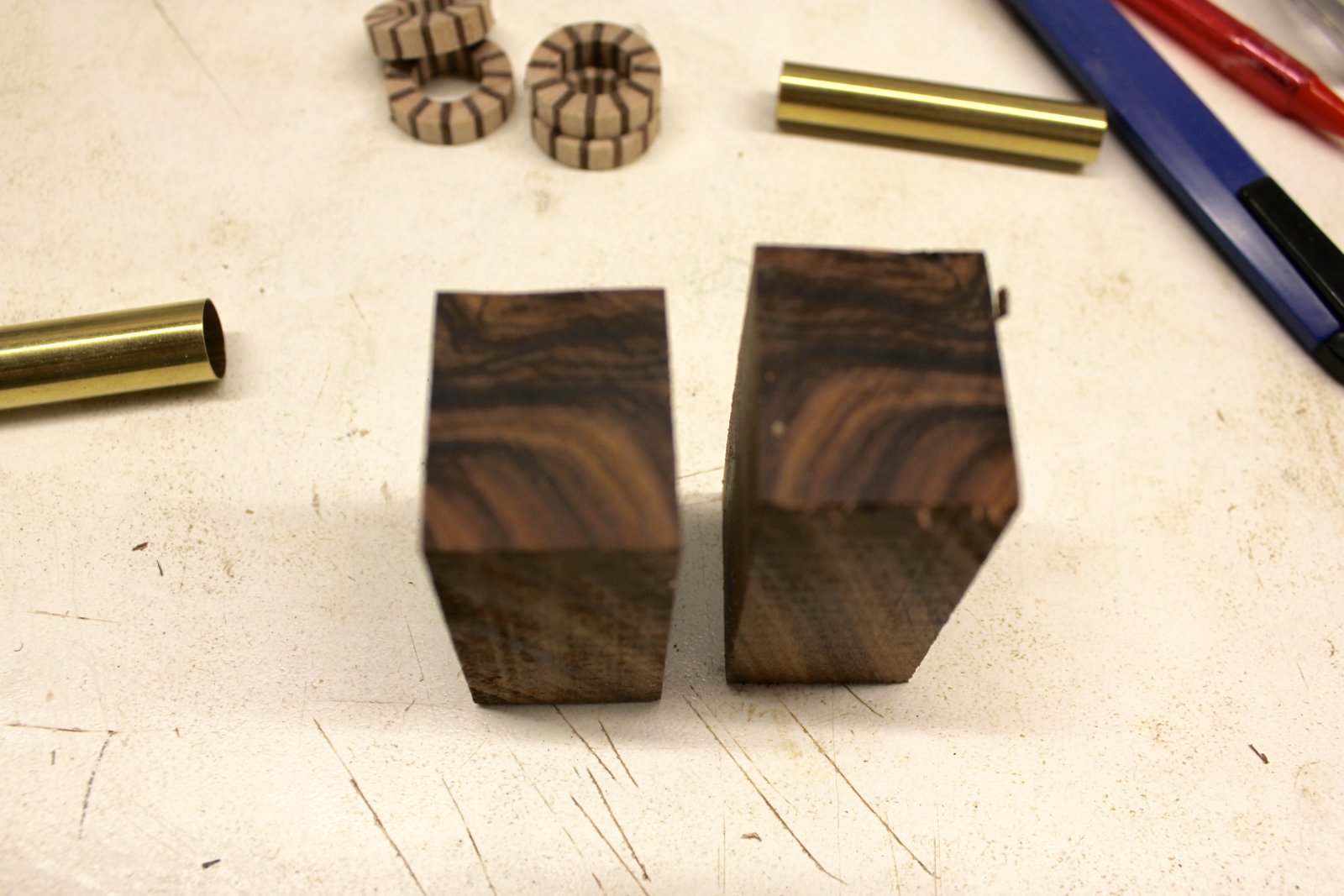

This was a special order for an individual in Louisiana. It was received, so I thought I can share. The request was for a Rollerball with trim rings, the base blank was my choice.
Pau Ferro blank, walnut and maple trim rings. Glu Boost finish.

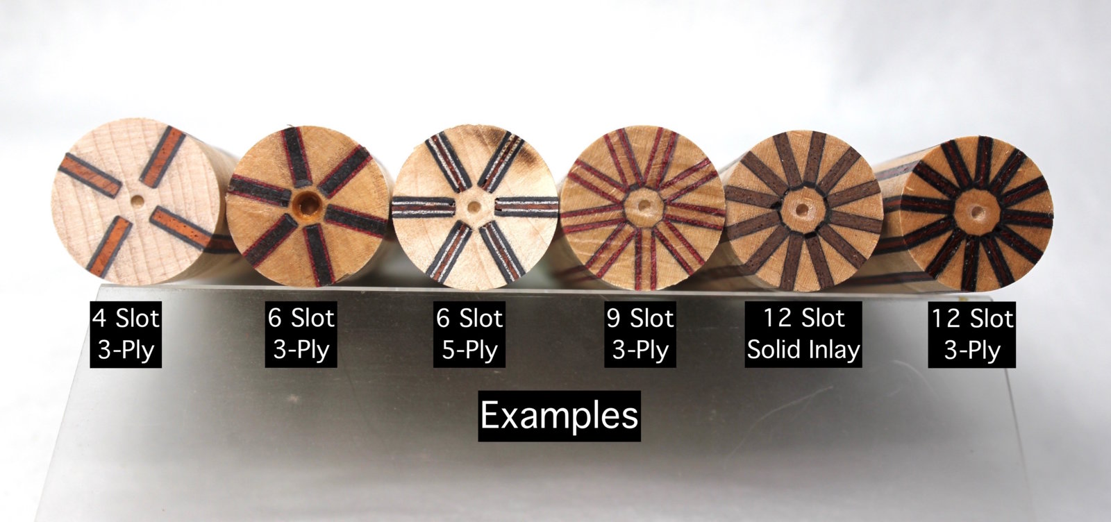

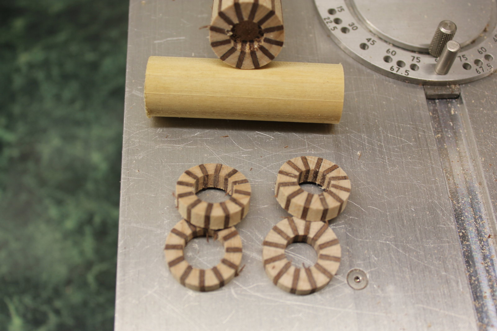

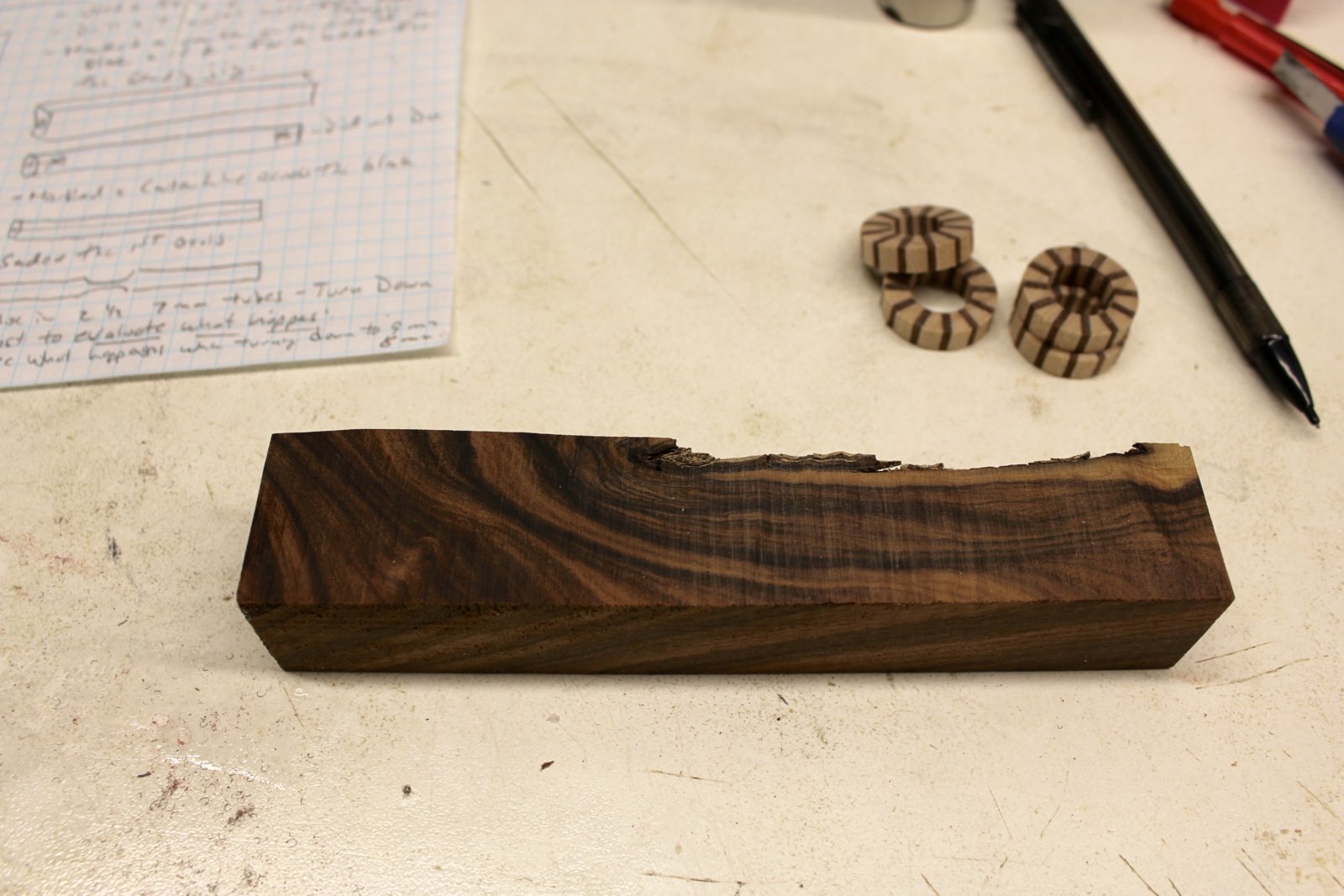

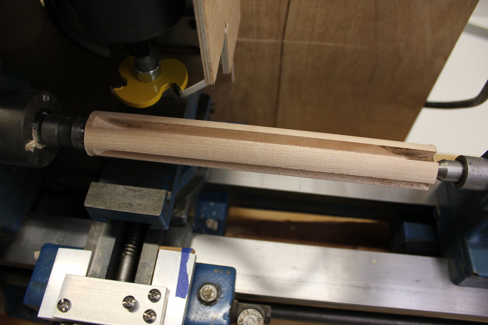

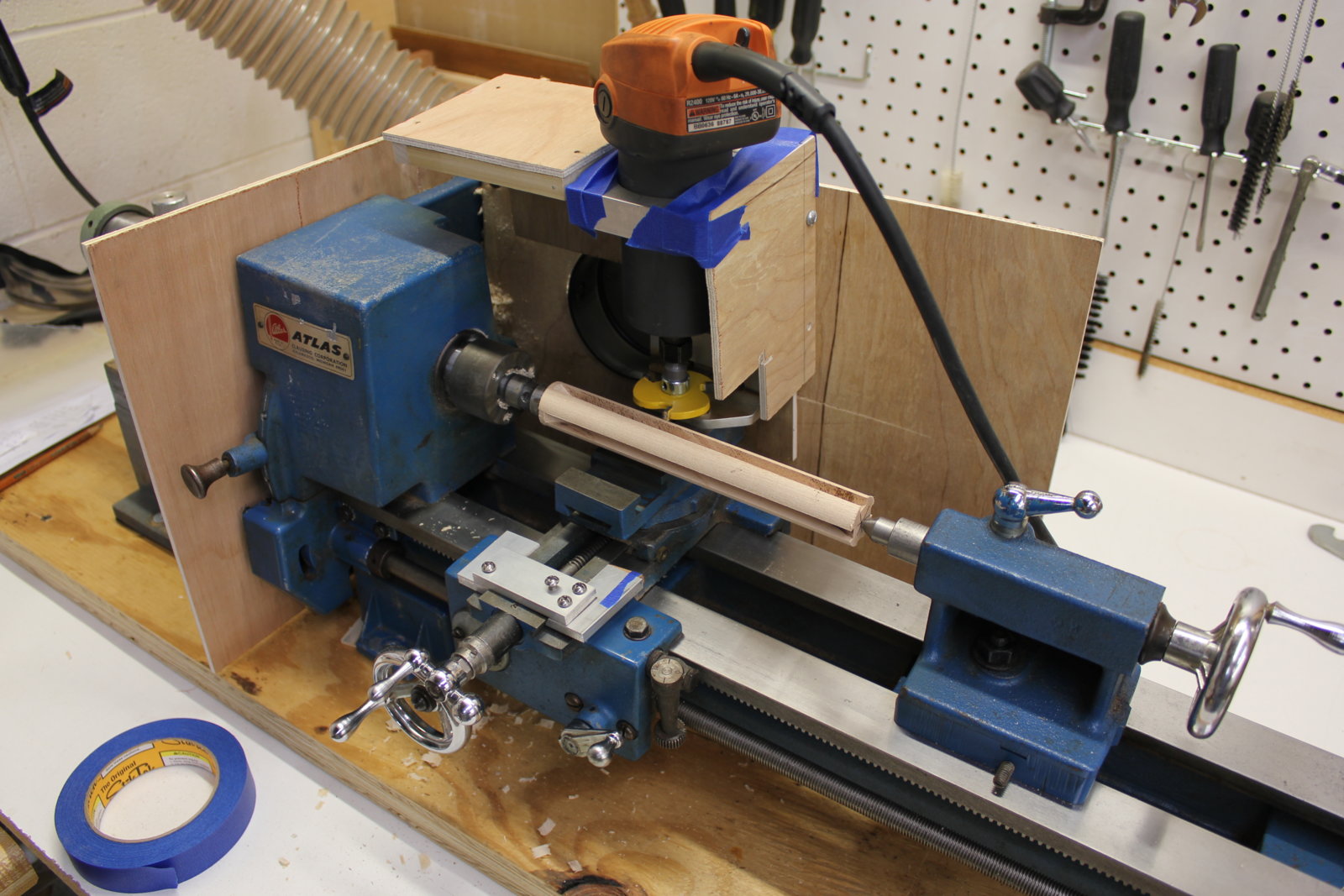

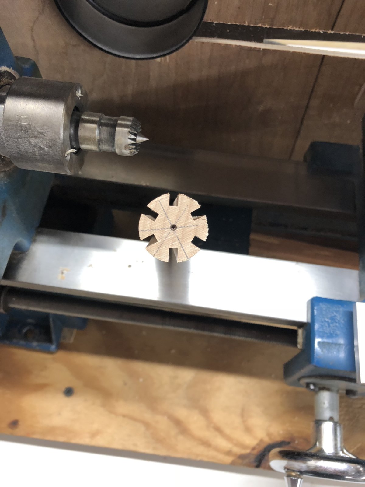

Hi Mal, I have not written a library article on the trim rings. I do these on "Frankie"... my Atlas Clausing Metal Lathe skelton (No motor, no pulleys, no brain, out of the wizard of Oz!). It has a heavy duty indexing plate and a back mounted router).
I have shown these before (don't want to bore folks), but here are a few shots:
BTW: I have only been able to do 12 rings max, as the remaining material in the middle tends to "explode" with higher numbers of slots. BUT, If you make multi-layered inlays you can easily get 24, 36 colors, just in a different sequence.
