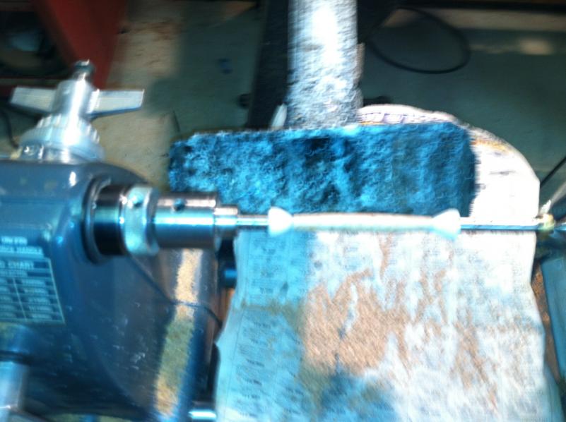

Here's the turned product.

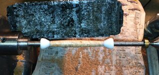

Here I've transferred the blank to a regular mandrel with Delrin bushings for finishing.

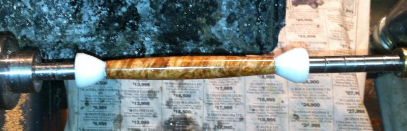

After finishing with CA.

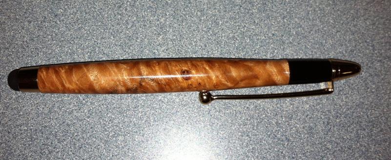

The finished product.
