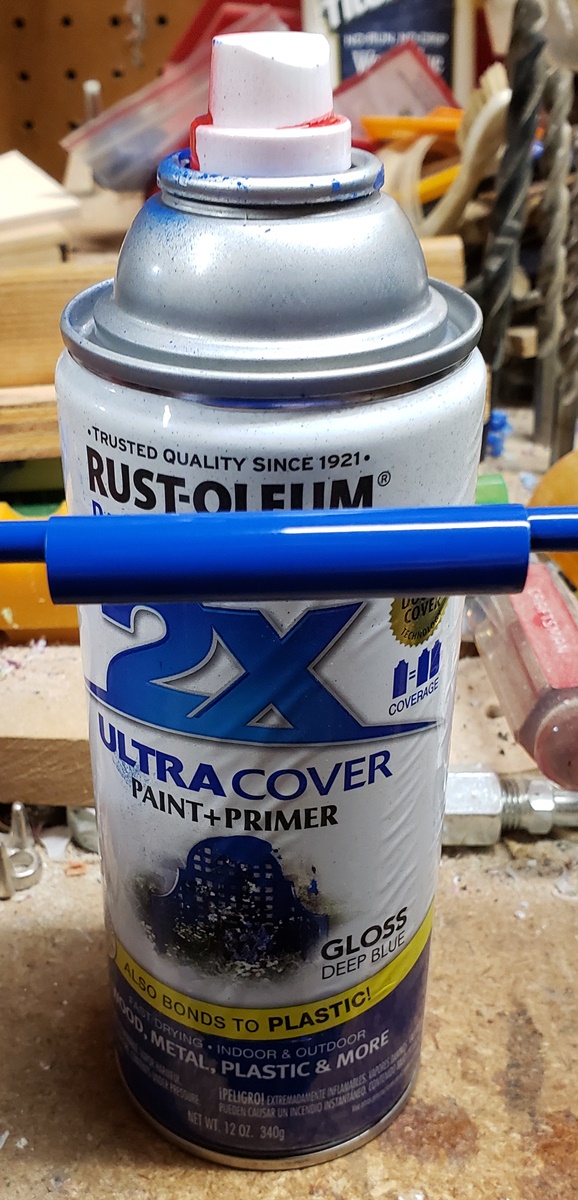

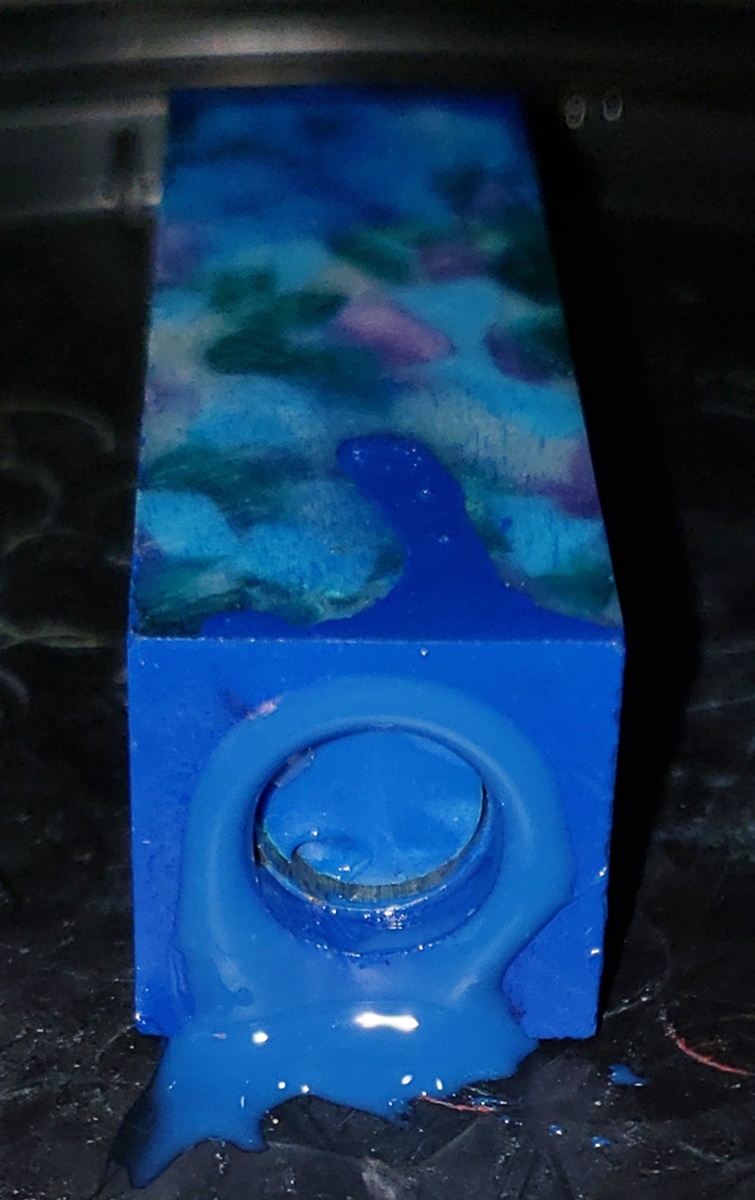

As you have seen already - I would recommend painting the holes and using epoxy instead of CA and painting the tubes. I have used spray lacquer and Testors enamel (the little square-ish bottles designed for painting plastic models). - Dave

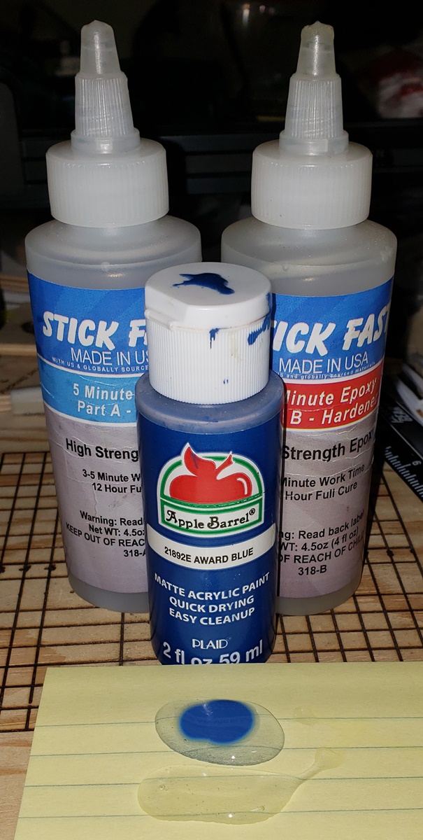

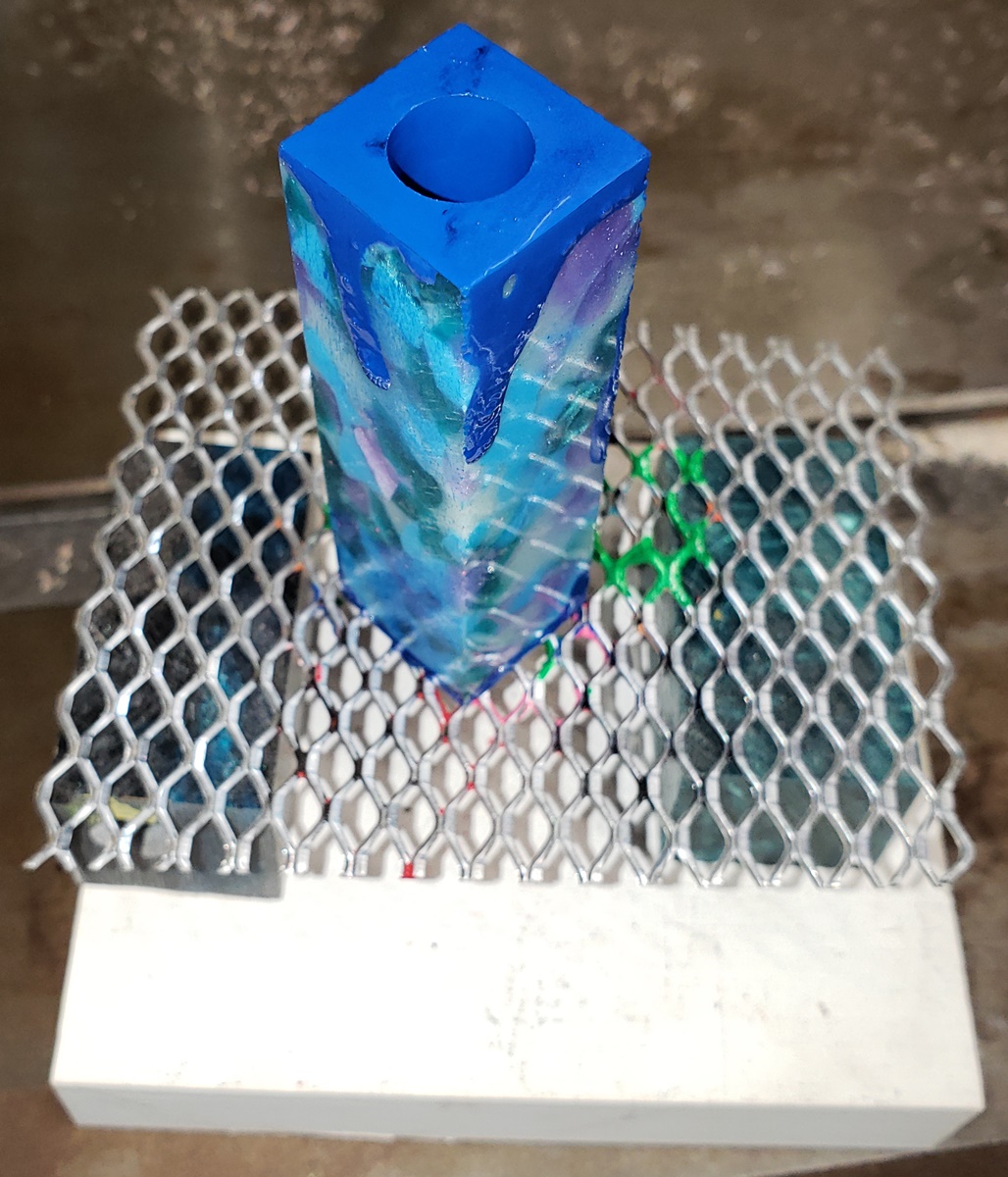

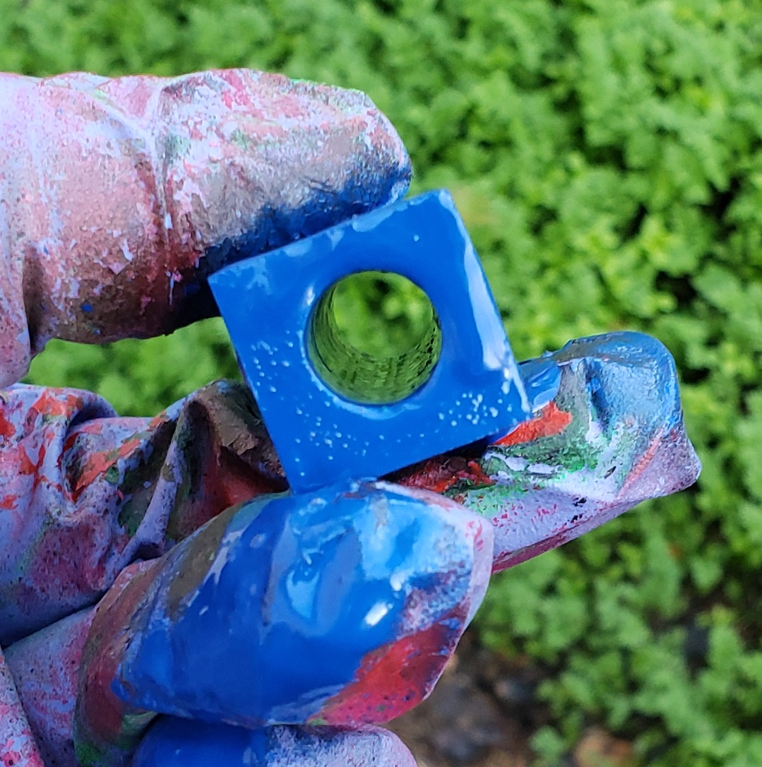

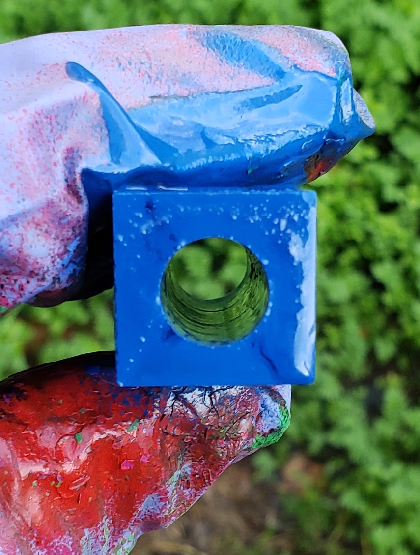

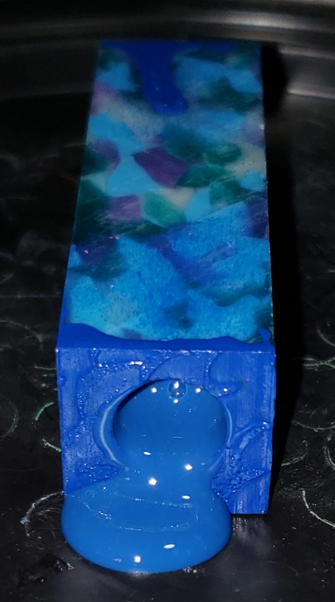

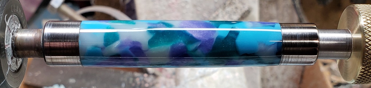

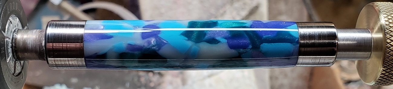

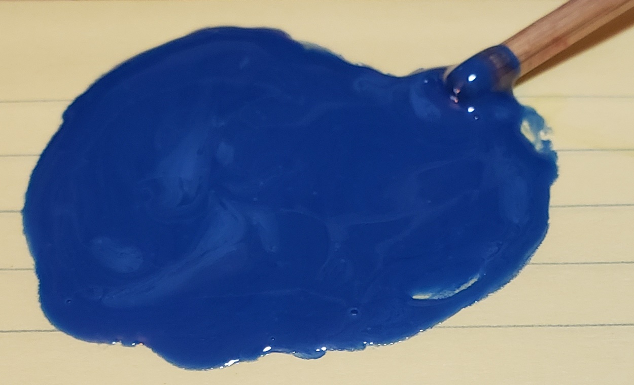

I paint the tubes and holes with spray enamel, and color the epoxy with artists' acrylic paint (can't color CA).

It really depends on how clear the blank is as to whether to paint the tube or the hole. If it is very clear and the tube could be seen clearly, painting the tube will not hide the glue between the blank and the tube. That's where painting the hole is a better choice. If the blank is very opaque, then painting the tube is adequate. I just did my first acrylics, and one was very opaque so I didn't paint, but the other was very light, so I painted the tube (it was a Slimline, so the blank would be pretty thin, thus the paint).

I don't paint the tube, because it seems to scrape off in places as I put it in. But I do paint the inside of the drilled hole. I use acrylic paint and let it dry overnight
