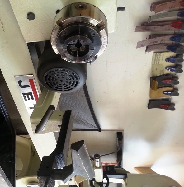

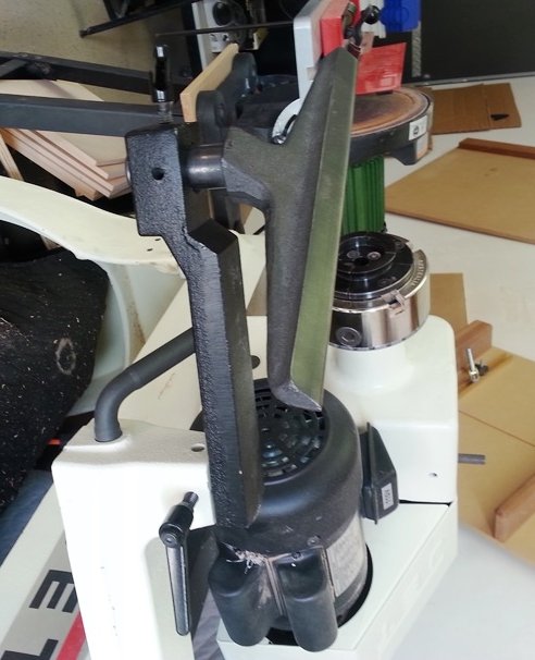

I have an extension for my Jet that makes it able to turn outboard and gets it about 11" out from the chuck. It's just a piece of steel that fits into the banjo and the tool rest fits into that, nothing fancy but pretty solid. Works on either side of the headstock. Maybe you can get one for your lathe or maybe Rick Herrell can fabricate one for you.

I consider those things to be incredibly dangerous. If the castings were higher quality, maybe. But knowing how poor import cast iron can be, I would really be cautious with that cantilevered arrangement!!!!!
