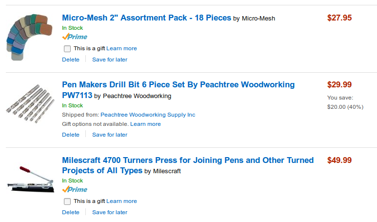

Now I need a list of things to buy to make a pen! This is what I have for equipment:
-Rikon 70-220 VSR
-Delta Industrial 46-461 Reversible Nova G3-D Woodturning Chuck
-Heavy Duty 1/2" Keyed Lathe Drill Chuck #2 MT
-PSI Woodworking LCHSS8 HSS Wood Lathe Chisel Set, 8-Piece
-PSI No. 2MT Heavy Duty Live Tailstock Center (friend gave it to me)
-NOVA 6034 PEN PLUS JAWS (comes with 3 pen kits!:smile:)
Safety:
-Uvex S8510 Bionic Shield, Black Matte Face Shield
Sharpening:
-Rikon 80-805 slow speed 8" grinder
-Oneway Wolverine Grinding Jig
-Wolverine Vari-Grind Attachment
I know folks say stay away from kits. In lieu of purchasing a kit like:
http://www.amazon.com/gp/product/B0043M5YDE?psc=1&redirect=true&ref_=ox_sc_sfl_title_5&smid=ATVPDKIKX0DER
What "list" of stuff should I get? Mandrels (which ones are good), drill bits, flush cutting tools, CA...etc.
I added them up individually and they come up to more than a kit it is.
Advice?

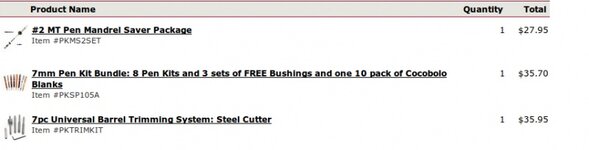

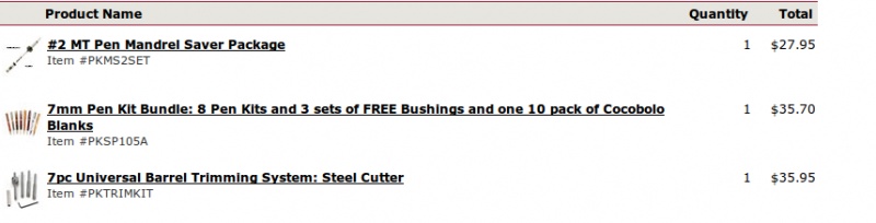

Well, I think I have everything I need and maybe more LOL. I got a drill bit set since I will have the bits for further pens and if not, I could always use extra drill bits...especially metric. I got a pen press. I have heard yea's and nays.
I got the Lathe and Grinder from Performance Tools Line. No taxes, free shipping, and the lowest cost around:smile:
  • Screenshot from 2015-10-22 18:00:49.jpg
  • Screenshot from 2015-10-22 17:59:15.png
I have Minwax Stain and Seal that I picked up at a local lumber yard (McCoy's, though ACE may also carry it, as well as Lowe's and Home Depot). I use it as a pre-finish, the color is "natural" so it slightly darkens the wood and gives it a "wet" look.
On top of that, while the stain and seal is still wet, I begin applying the first coat of CA. I just use the cheap stuff in the 10-pack of tubes you can buy at Harbor Freight for $2.99. I use this for gluing my barrels as well as finishing. 6 - 9 coats, then 1000 grit wet, jump to micromesh and finish with Meguiar's PlastX and Turtle Wax hard coat polish. Every time I reach double or triple on the grit (like 1000, 3200, 6000, 12,000) I stop the lathe and sand laterally to break any radial lines before I continue.
