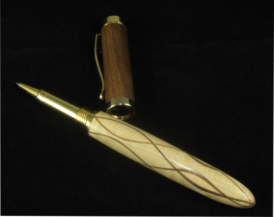

Haven't seen many closed end pens on the ol' IAP recently, so I thought I would make one from our new Serpentine blanks, made by TerryQ!!
The blank "does the talking", so a simple pen kit seems the right choice--I picked an Atrax Upgrade gold. Thought it would look nice with a simple cap.
Well, I made the video and in the process of the steps, everything went well.
The pen was complete and I felt it was successful.

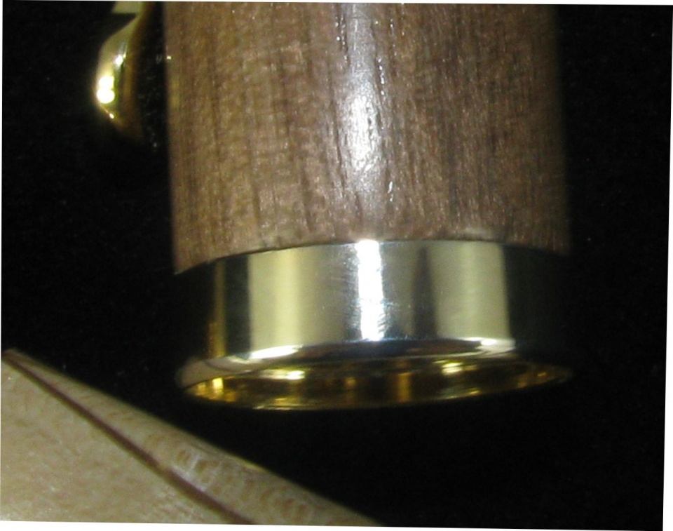

Assemble the pen and "oh, sh_____ucks!!" The centerband does not mate with the wood all the way around the pen--the wood was never faced!! So, DISASSEMBLE the cap.

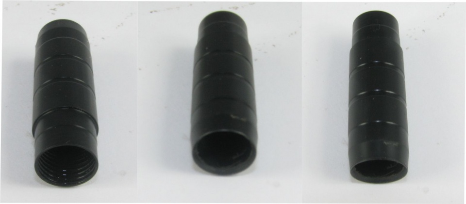

Tonight, I went back down and beat on it for several more minutes. The part came out. To my amazement, it looks like it is brand new. Pictures attached.
attachment.php
From both ends and close-up of plasic where it was hitting the punch.

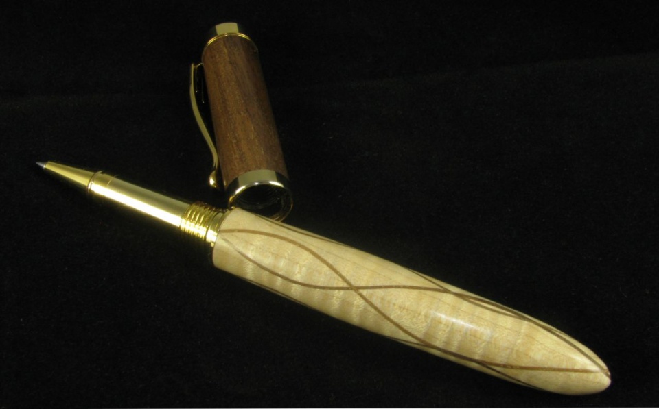

Then, I took the cap to the lathe and faced both ends (the step I forgot yesterday). The repair and the parts are shown here.
My only comment is "It definitely AIN'T EASY!!!!" But I was the dumb spit that made the mistake, so it was my job to fix it---and I did---YOU can too, if you are an equally dumb spit to MAKE the mistake and determined enough to FIX it.
The diameter of the punch IS important. The pressure was on the outside of the plastic piece, so it survived nicely. I can't think of an easier way and this way was NOT easy. But, it CAN be done!

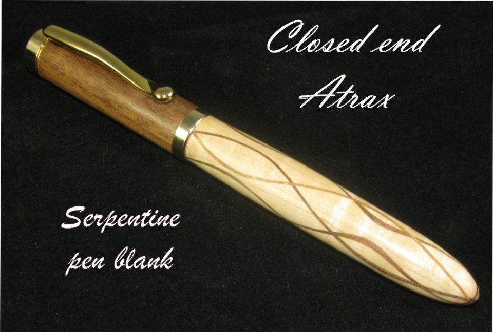

Proof below.
And I really value this pen a lot more than most---I WORKED for this one!!
