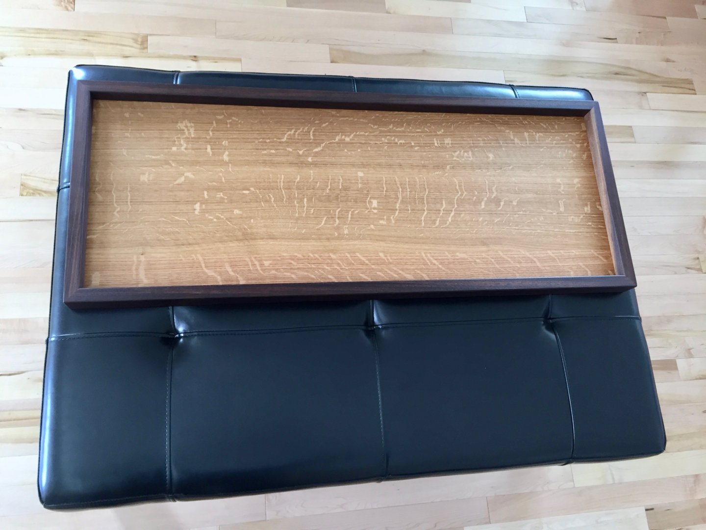

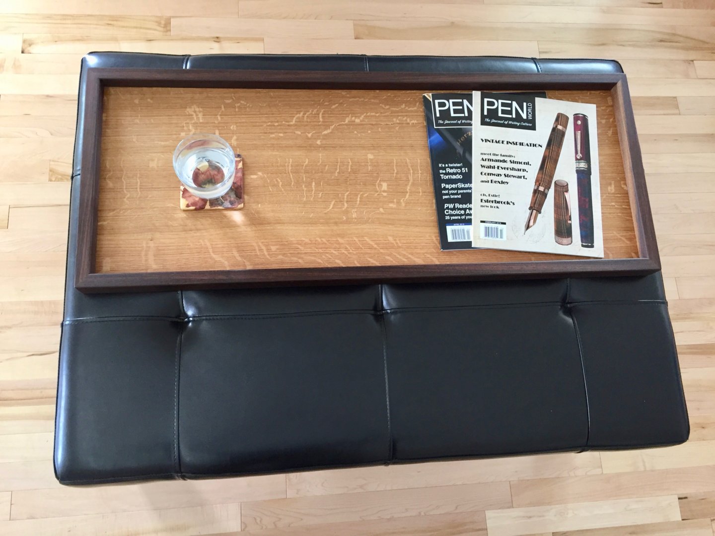

Marla bought an Ottoman to put in front of our couch. They are nice to put you feet on when reading a book but they are lousy at putting a beverage on so I made a tray that sits on top. A Quarter Sawn Oak panel framed in Bak Walnut, Boiled Linseed Oil and Paste Wax finish.

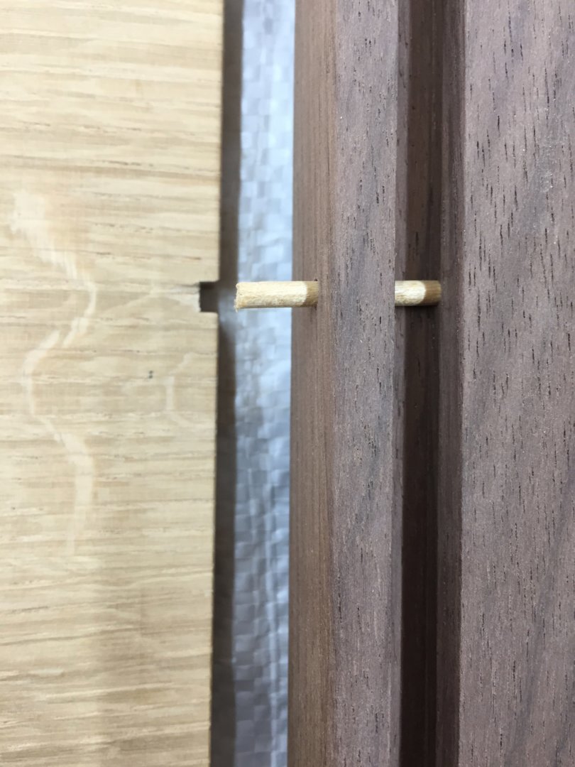

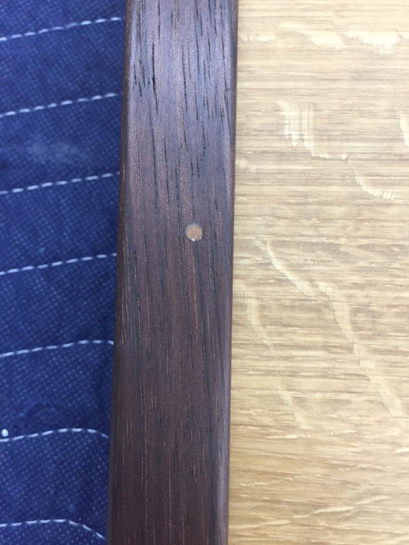

One thing I do for panels that most people don't do is to put a small dowel (1/8") in the centre of the groove on the end of the frame pieces and notch the centre of the panel. That ensures the panel is centred when I glue it up. Most people would, if anything, use SpaceBalls or bits of O-ring etc. Any seasonal movement of the panel will always be even. It isn't so important in a flat panel like this but if it is a raised panel the reveal may not be even if provision for centring wasn't taken into account. One of the pictures shows a mockup in scrap. The dowel in the finish piece being glued and trimmed flush.

You're welcome. If you don't want the dowel to show at all drill the hole into the bottom of the groove. Then the dowel is hidden in the slot. A suggestion from a fellow on another forum.
