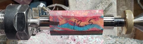

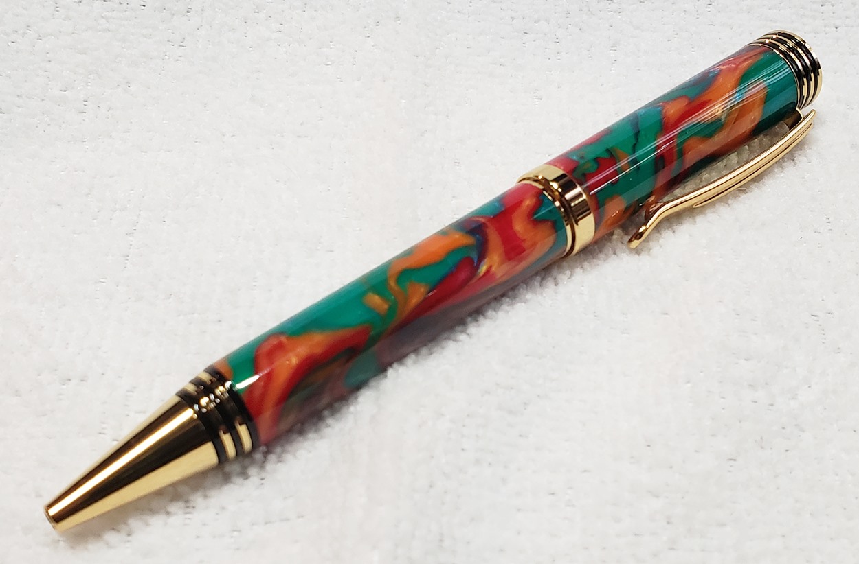

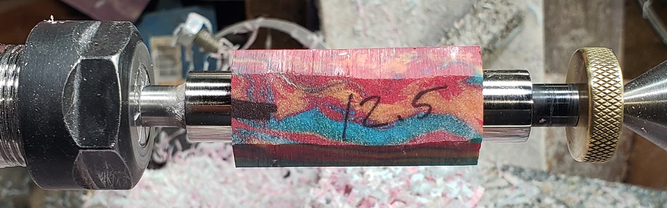

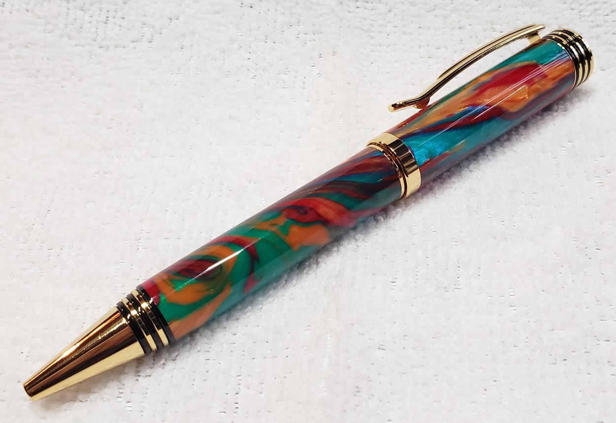

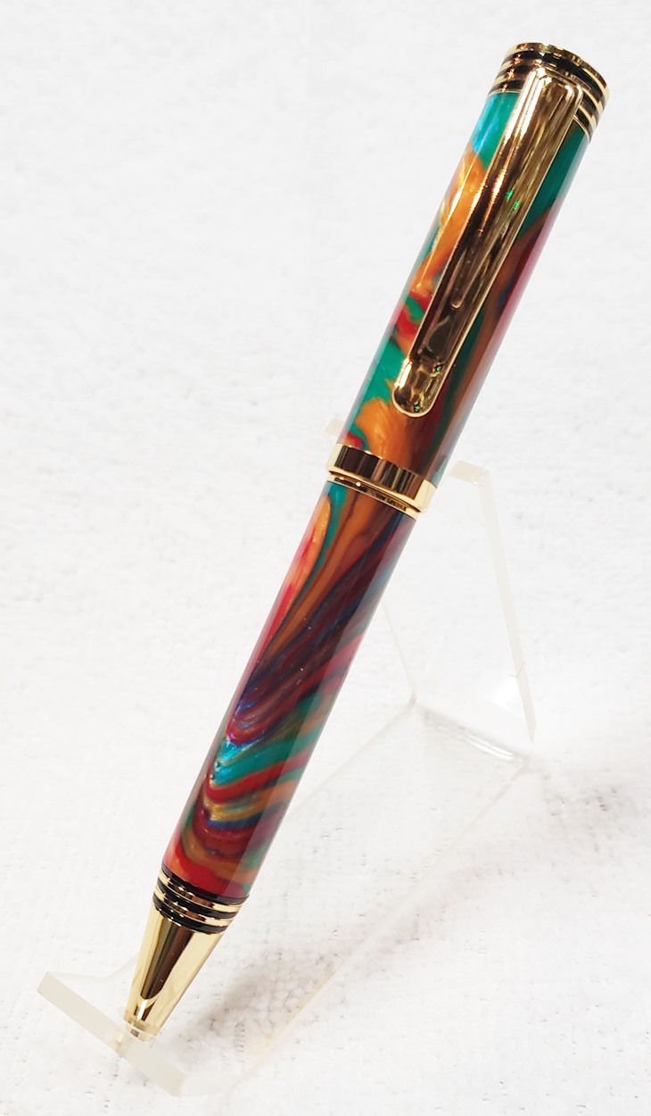

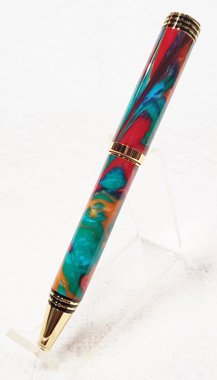

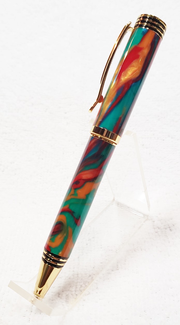

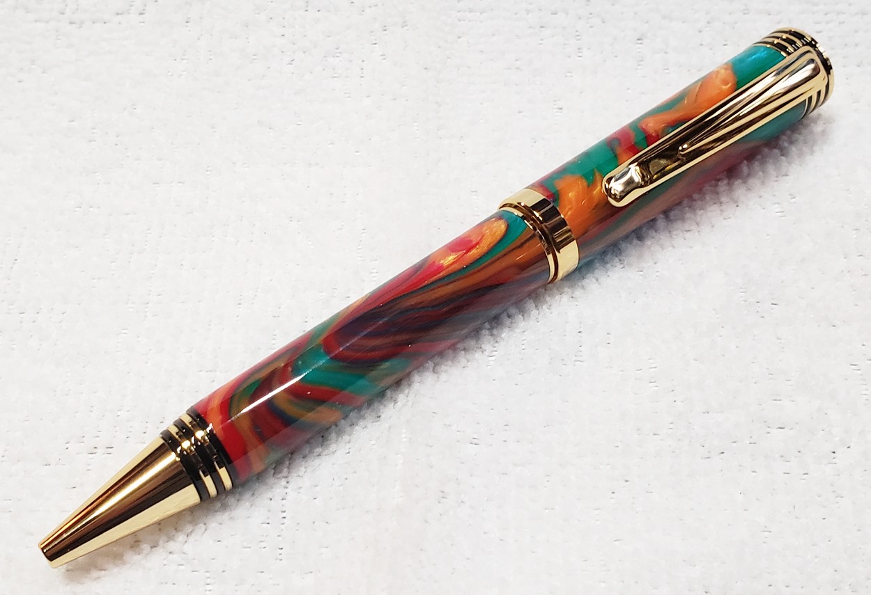

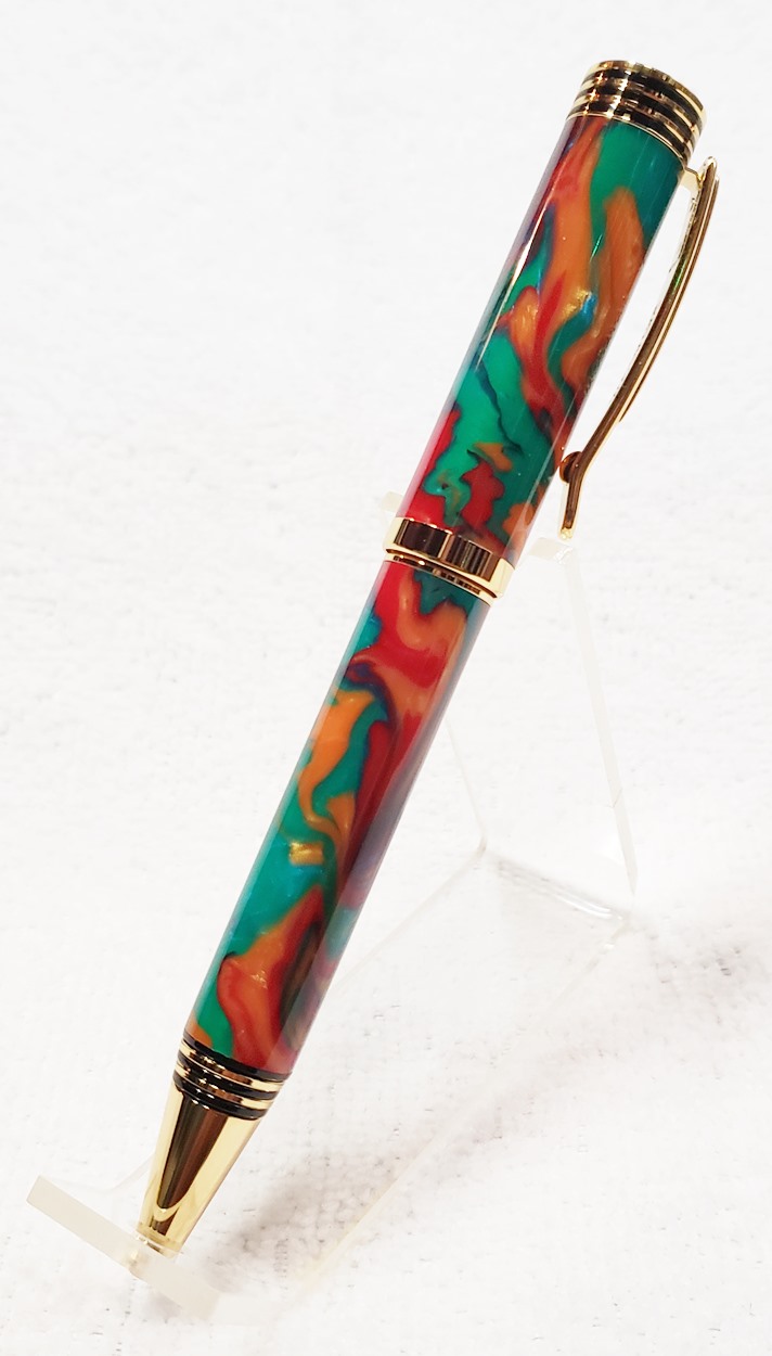

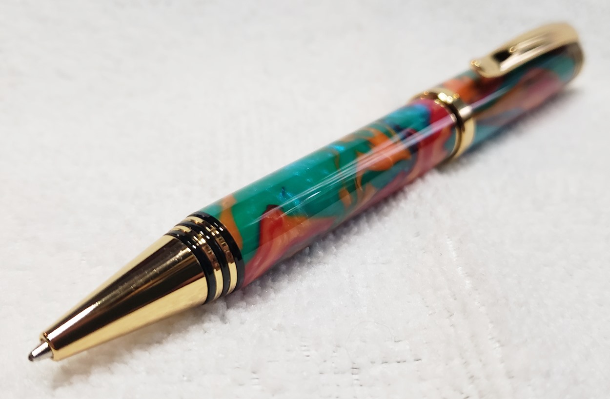

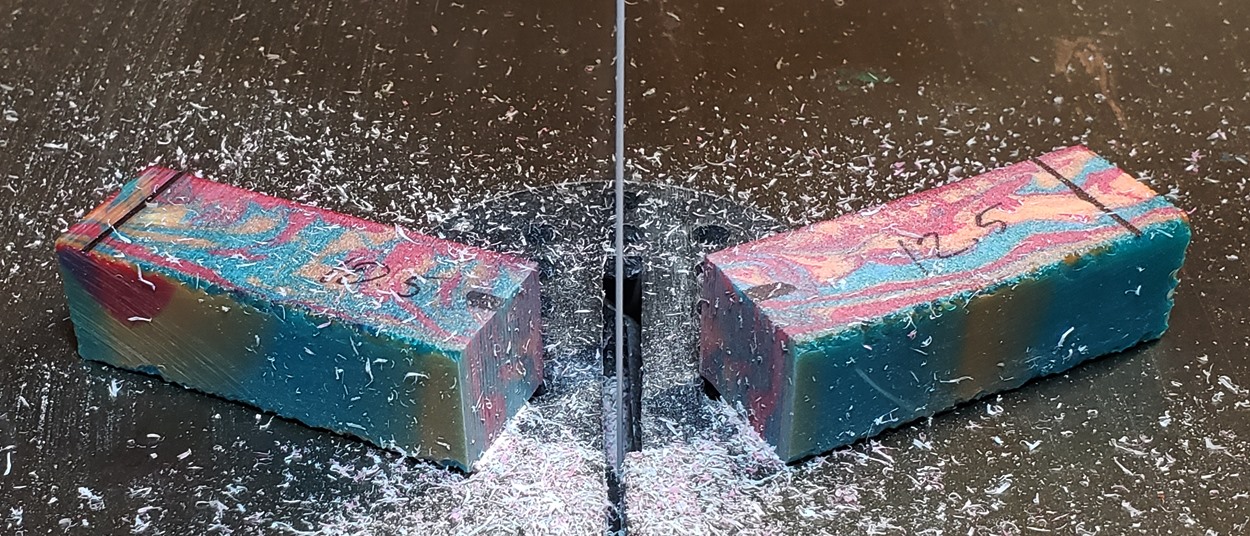

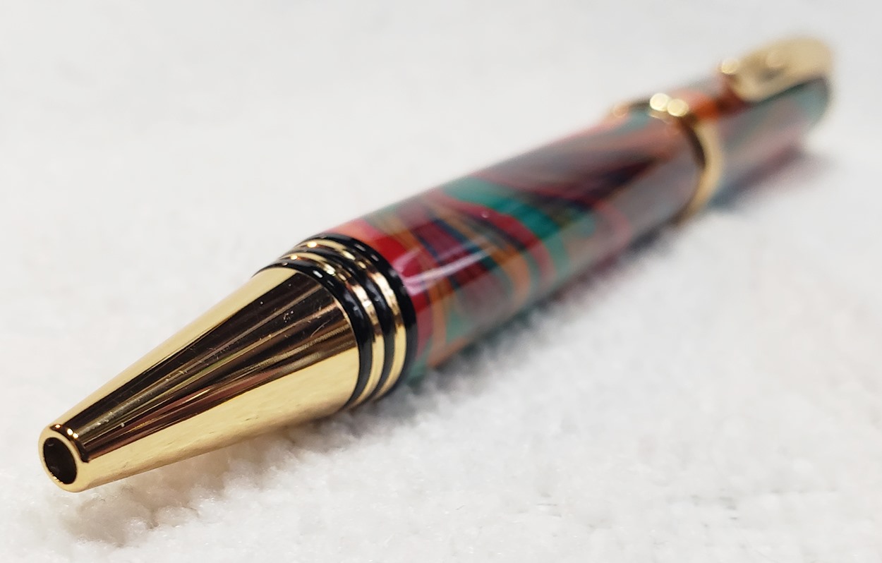

This is a Dayacom Oscar, in gold and black chrome, from Turners Warehouse. The blank is an inlace acrylester called Tie-Dye, from Woodturningz. I like the combination more than I thought I would.

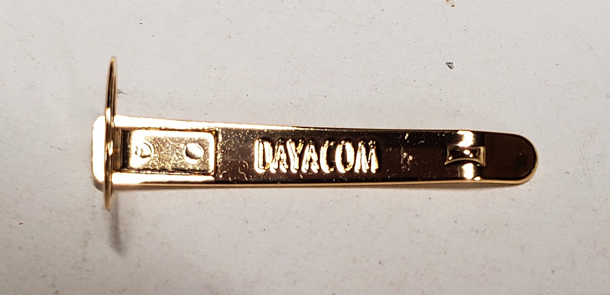

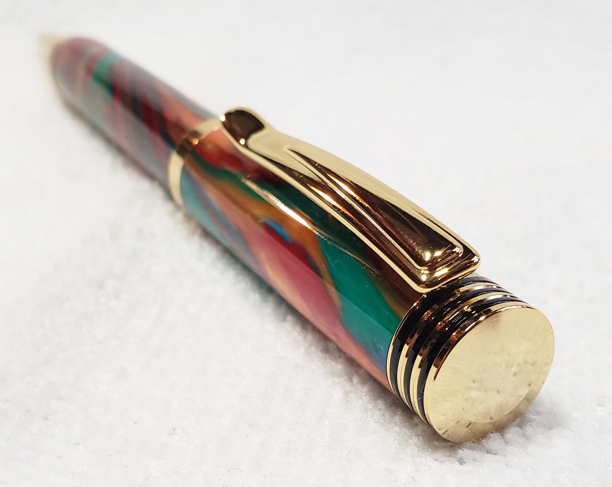

I like that pen very much !!! . Is it a Ballpoint ? . Seems to be by the look of the refill tip in Picture #6.

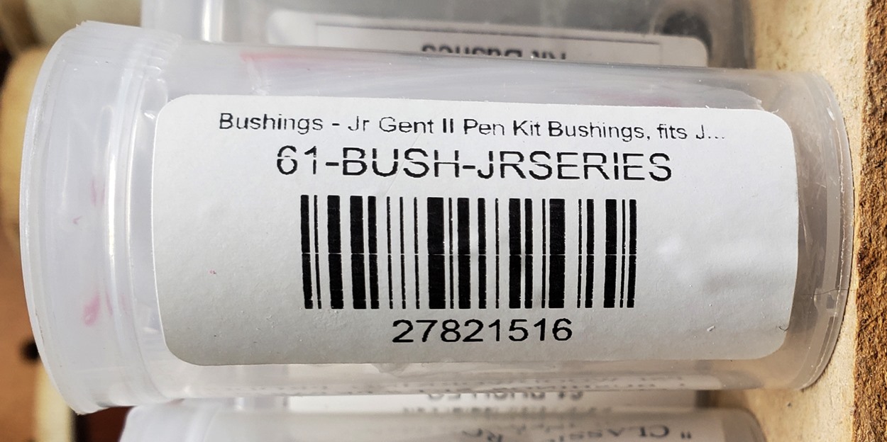

JR Series Pen Kit Bushings
Fits kits made on the Jr Gent II platform, known kits are, Jr George, Jr Aaron, Panda, Jr Retro, Oscar Ballpoint Kit, Jr Independence, Jr Duke, Jr Lincoln, Jr Hamilton and more..
instructions:
https://cdn.shopify.com/s/files/1/1284/5707/files/jr_gentlemens_pen_7d889912-ea24-4f2c-aa9f-4a14ac0dc3f0.pdf?
6797884653171261626
Mal from Exotics
https://www.exoticblanks.com/bushings-jr-series.html
I say this all the time, if you are buying a new kit buy the bushings is a good idea. . Do not rely on list of kits.

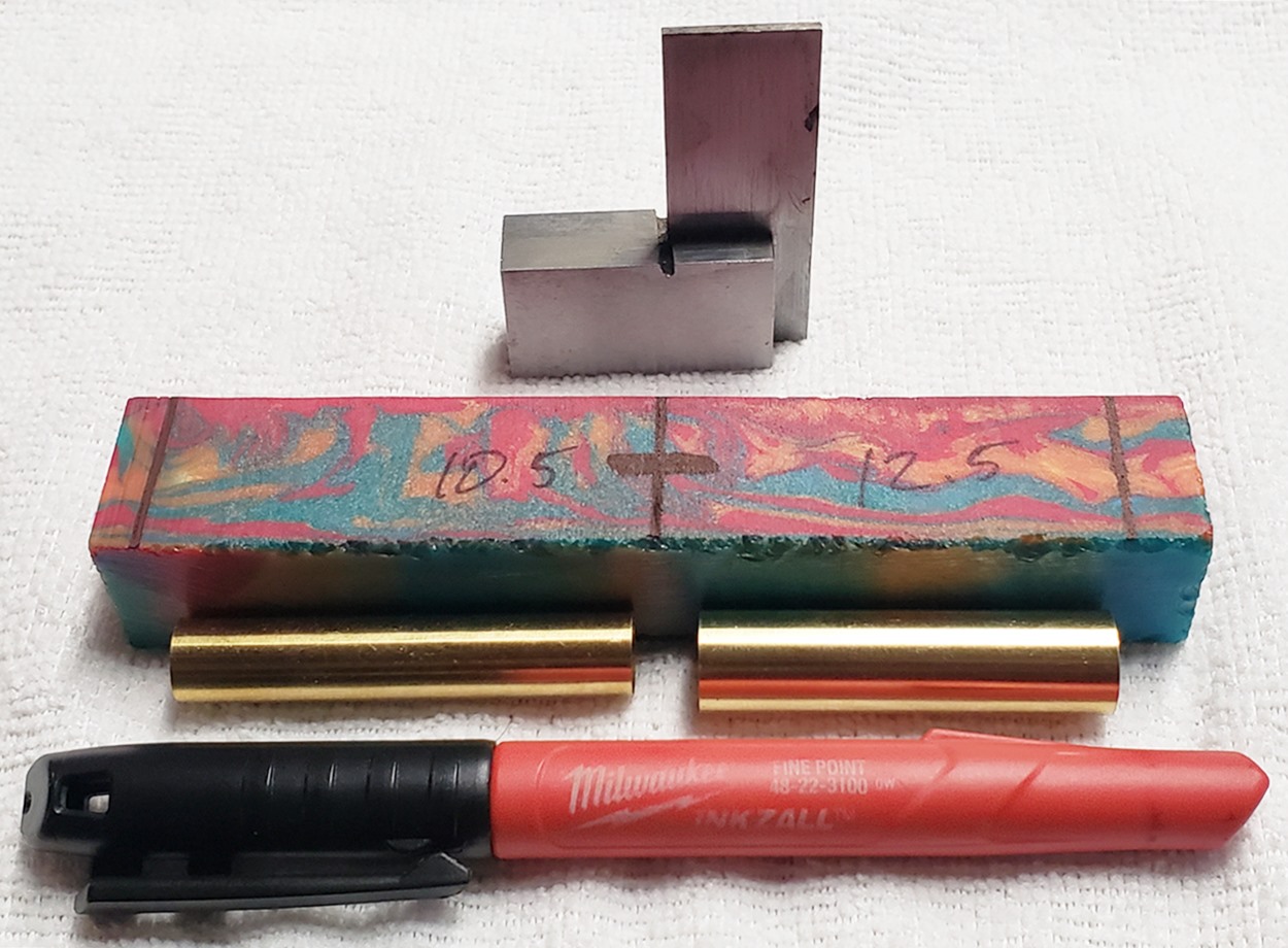

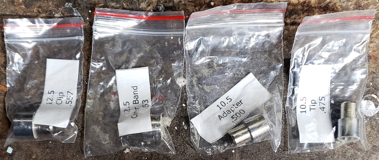

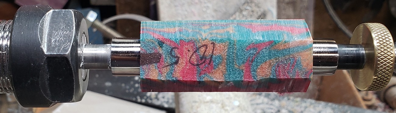

The Oscars are the only "Jr" pens I've ever turned. I ordered the bushings from Turners Warehouse at the same time as the kits. I remember I was confused by the bushings, so I made a cheat sheet and labels for each of the four bushings. I always make a "registration" mark on the blank for two body pens, so I know which end is which. I always position blanks on the lathe so the wider end is to the left. Does this help?

Yes, what you provided is a PARTIAL help and PARTIAL answer ... THANK YOU. Is this pen a BALLPOINT ?
I will need further clarification, but let's start there, Jim.
Mal, why don't you ask Ed, carries both styles or if you are serious about getting this kit just buy a set of bushings if you use them but from what I understand you do do not even use bushings so what are you worried about. As you see Mal this is not a capped pen so it is a ballpoint. Maybe if you want to expand your thoughts you can go to the charts and look up both JR Gent II rollerball and ballpoint and give us the tube sizes and the bushing measurements. I also believe Timberbits had a different Jr Gent kit also so maybe include that one.
https://www.turnerswarehouse.com/products/copy-of-oscar-ballpoint-pen-kit-dayacom-kit
@qquake
Thanks for your reply. . I apologize for pushing that point. . I failed to read the kit title on the Turners Warehouse listing specifying "Ballpoint".
It now seems from the pictures that you show that the bushings for the Oscar are NOT the same as the Jr Gent II bushings.
For the probably obvious reason, I have continued this discussion with you in a Private Conversation.
Thanks again, Jim.
Great looking pen - kit and blank look amazing!
Was this your first time turning inlace acrylester? Thoughts of it versus other types of blanks?
No, I've turned a fair amount of it over the years. When I was still using HSS chisels, I hated turning it. Avoided it like the plague. But since I've been using a carbide chisel with a "shearing" cut, I've had much better success.
