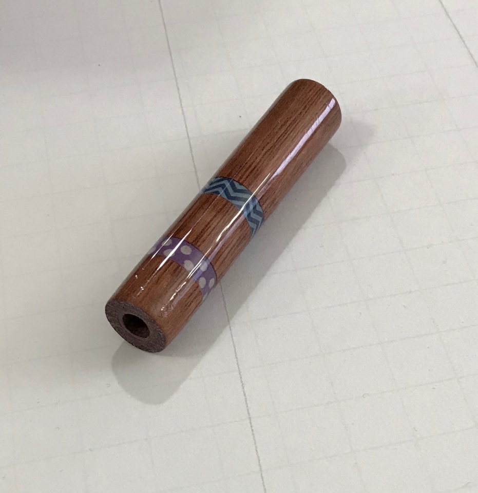

While browsing around Joanne Fabrics, waiting for my wife,picking out fabrics, I came across this stuff called Washi tape. Gears started turning and I wondered if I could incorporate this stuff in making pens. I tried it on a piece of Purple Heart, inset in in a slight groove, my parting tool is the exact width of the tape I bought. I turned out fine, put a ca finish on it, it's very smooth, you cannot feel a transition whatsoever. My concern and question is, will it make a pen look cheap? I wouldn't ever try it on something high end. My wife commented that she thinks it would look great on seam rippers as it has a kind of fabric look. Thoughts? IMG_2800.jpg

I can see it may have its place on some light colored wood or acylic as an accent piece. But what makes it so noticable is the edge from the parting tool and transition to the tape. We know it is not true segmented. Even if you used just as tape then you have the reverse look. As I said maybe some steam punk blank or as others have said a knitting needle, or seam ripper. Good luck and you will run into this all the time now. Constantly looking at things and trying to see in your mind if they would work on a pen blank. You are hooked. :):):)

The image i posted is just a proof of concept thing, it is not an item of use. It is just a piece of scrap wood to see if the Washi paper could be of use in a future project. It seems like maybe that wasn't clear. In any case I am thankful for all observations.

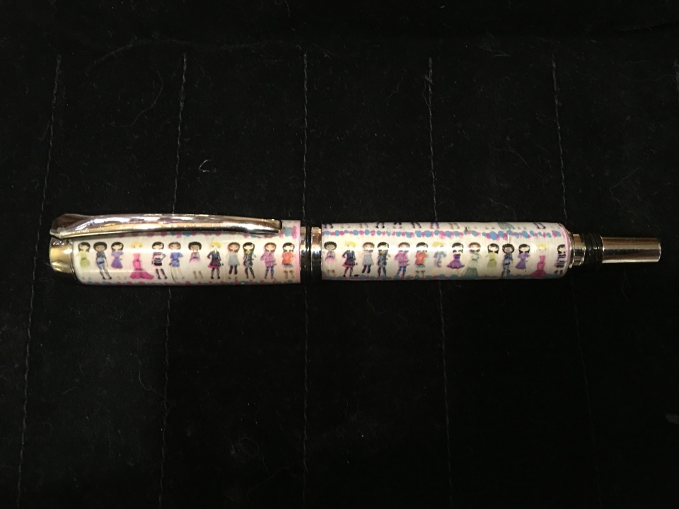

Looks great. I wish you better luck than I had.
My wife took washi tape and placed it directly on the tubes and I cast it in Alumilite. Made this pen with it. Had it in my inventory for 4 or 5 years with. I was asking $60 for it. She claimed it for her own this past year.

I overlapped the tape and then carefully cut across the overlap with an exacto knife then removed the underlying piece as well as the overlap and literally you can't even find where they meet.

I think if you got the depth down for your parting tool and if these were darker colors, it would fit very nice on a pen. They look pretty good for just playing around with it. I love experimentation!

I think it looks great the idea is fantastic. I can only assume that this product is not sand-able and that the parting tool needs to cut a very thin inlet? My wife drags me into Joanne's when we go to town. I'll have to look at this stuff. Thanks for sharing.

It is not sandable and the groove I cut is extremely shallow. I would guess that it is about .010 under the surface of the wood and then I just filled in with thick ca. Sanded that down and then proceeded as normal.

Couple suggestions
Taper the sides of the groove slightly to meet the tape before applying CA
Or
Use a "V" groove that the tape does not fill completely and the edges of the tape are slightly proud of the surface. Apply CA and level the edges once the CA is dried after a few thin coats.
I like the idea and think it looks good.

I'll give it a try, thanks for the suggestions.
