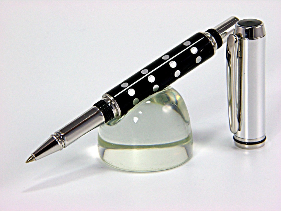

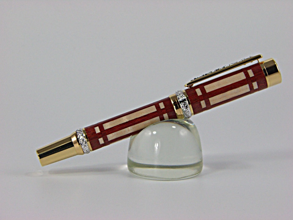

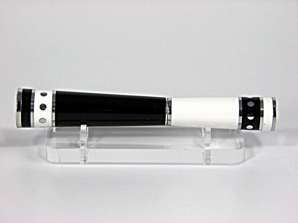

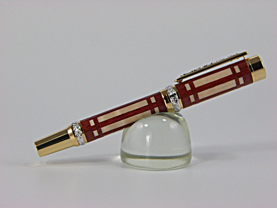

I just saw this. I ask the demonstrator if his lathe was a 1221. I have 2. I would like it for drilling holes around the blanks to full with crushed stone/powder. Thank you for the post and I will get back to you if he answers me.

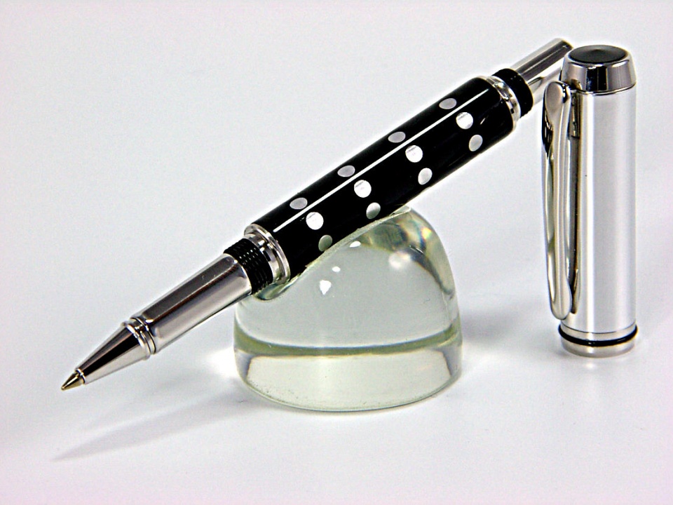

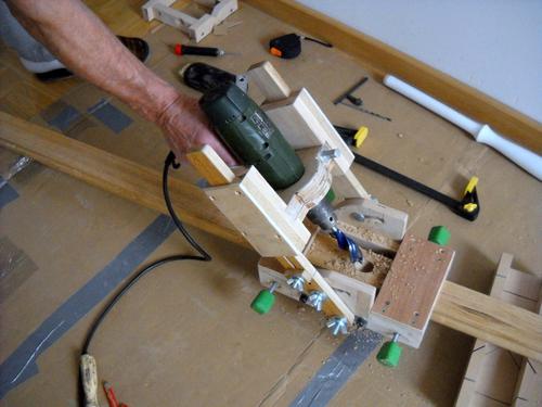

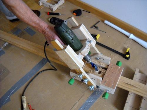

This is like the one that I made. Drill Guide
How has the UMHW block held up to wear?
I used a homemade block, recycle code 2 that I made out of plastic, I han no problems with wear. Made one for my son, we used a block of maple and drilled a small "oiler hole" to drip oil in. His is still in use after several years. I also made an indexable holder to fit my drill press, sort of llike the indexable feature that Sherline has for their mill. https://www.sherline.com/product/3200-indexing-attachment/
For homemade recycle block, look up homemade HDPE.

If you check on David Reed Smith's site, he shows how to make a drill guide that fits in the banjo. Since you make it yourself, it can have any size post.
