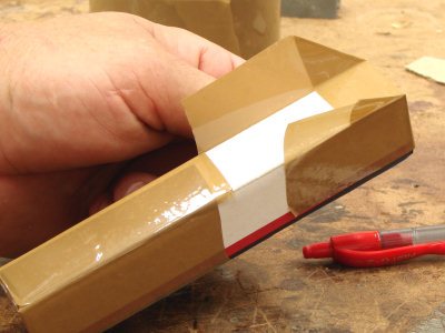

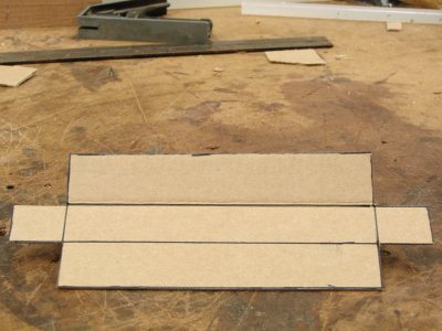

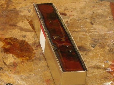

A good way to make a one time use, custom size mold is to make it out of cardboard and tape. Then once the blank has been cast you simply cut the cardboard off with a bandsaw or turn it off on the lathe. Here is a picture of one I did:

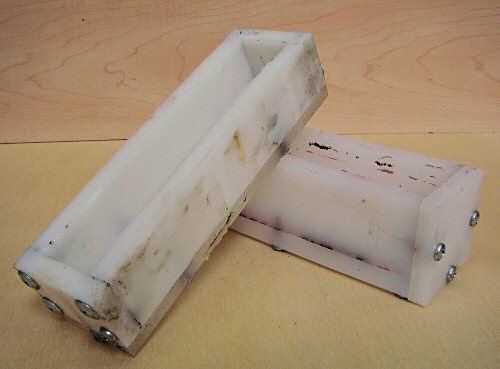

Of course then there is the re-useable molds I make from the white plastic cutting boards...
