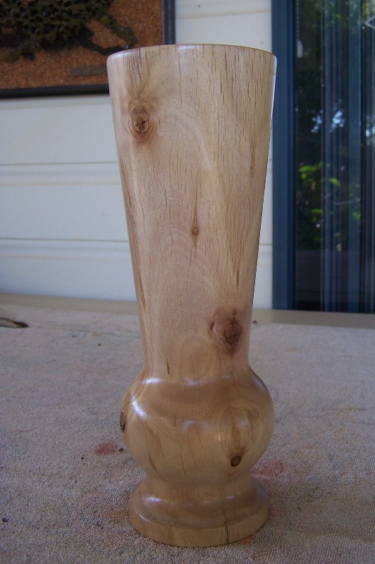

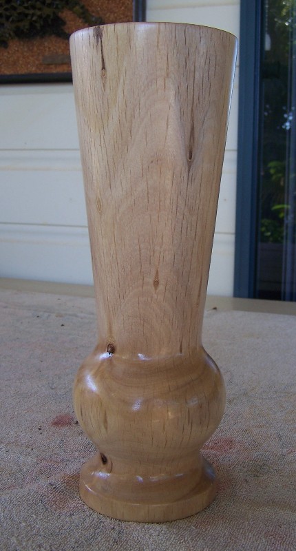

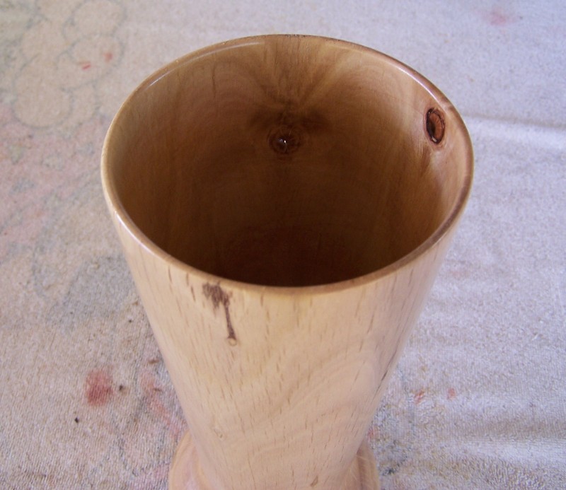

I was given the wood from 2 Olive trees growing in Kalbarri, the cost being my arms, chainsaw and trailer. The trees were still quite young, 13 - 15 years, so there is not a lot of colour. One of the trees had been lopped previously and this branch had a heap of shoots from the end and I thought it might be interesting to see what happened on the lathe.
It is 11.5 inches tall and 4 inches diameter, and hollowed as far down as the top of the bulb. I wanted to have some base weight for maximum stability.
It is finished with Shellawax "Glow" and was sanded to 400.
Hope you like it and thanks for looking.
C & C welcome.

That's gorgeous, Bob.
What's your method for holding a long piece like that while you hollow out the inside?

I made my own Centre steady out of ply and skateboard wheels. It can support about 5.5 inch pieces, should have made it bigger.
Works quite well.

Hi Bob
The wood looks from the "plantation" olive trees and if so, they never grow much heartwood because they are created to don't produce much wood, stay fairly low to the ground, grow lots of fruit and the more "elastic" to allow mechanic harvesting, those machines shake the hell out of the trees, old type Olive trees wouldn't do too well with all that shaking...!
Still, the wood does offer good characteristics for turnings that are elongated such as those vases, and the price of the wood was good so, a win, win situation...!

Hi George,
They would have bought the plants at a Nursery, so I guess you are correct. A couple of the trunk pieces are about 12 - 14 inches in diameter, and I think I can see a bit more colour in that wood. Here's hoping.

Beautiful Vase Bob,
I love the Thin, Wall Thickness you achieved.
Is that a glimpse of light in the 3rd photograph, on the back wall in a Knot?
It is pretty thin, over a knot surface.
Excellent Finish.

Hi Brian,
I did apply some CA over the knots as I worked, so yes, that is a clear piece through the knot.
