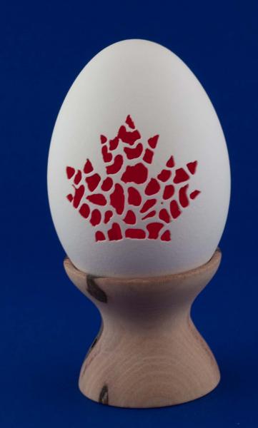

Carved a Maple Leaf into a Goose Egg then airbrushed the inside of the egg red to create a Canadian Flag look.

Charlie - With the right techniques, there is not a lot of risk of breaking the egg while carving. The big risk is cutting through a planned filgree rib and having holes that are bigger then planned.
holmqer
Local Chapter Leader
Aug 3, 2007
1,662
CT, USA.
What do you carve that with? Man that takes a steady hand!!! That is a awesome egg right there nice job.
Egg carving is typically done with a microturbine air tool, with the two most common products being the Turbo Carver or the NSK Presto.
http://www.turbocarver.com
http://www.nskamericacorp.com/prod_handTools_presto.aspx
Both of these use 1/16" shank dental burrs.
I used the NSK Presto with a 699L burr for this piece
These types of tools are also used for pierced wood turnings
Examples from some of the absolute masters of the technique are
Bihn Pho
http://www.binhpho.com/gallery.html
Joey Richardson
http://www.joeyrichardson.com/
Gary LeMaster
http://theeggshellsculptor.com/
