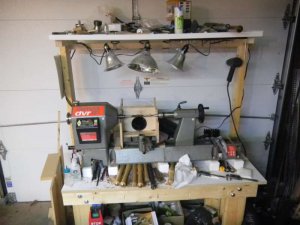

i see woodcraft has the dvr on sale i guess i will have to get one now don't if it will get any cheaper . does anybody have some good plans for a stand besides the one in the instruction manual. any help would be appreciated
Here is a look at mine.

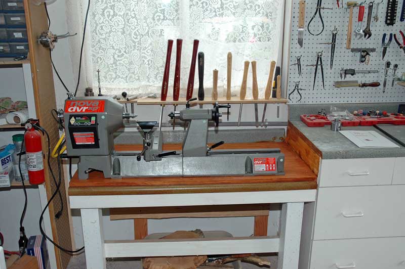

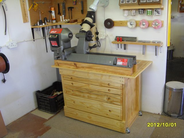

My setup.
First attempt had angled legs which were a pain as the got in the way of my left leg.
This is much better.
Has place for ballast in the bottom and storage drawers
Phil

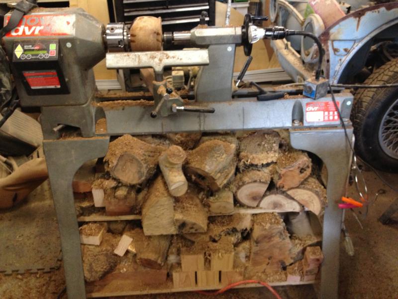

I bought the cast iron stand from Teknatool, added 2 shelves and filled it with my future projects for ballast. You have the option of bolting the legs down as well. I may do that later as I'm building a new shop now
