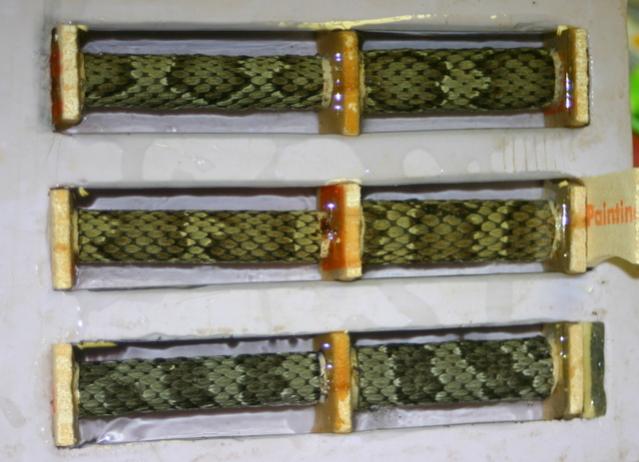

My latest casting...a trio of Gent blanks. No pressure and no vacuum. Just 20 minutes in the ultrasonic cleaner then into the molds. I like this....much easier and faster.
Do a good turn daily!
Don
Thanks John. I like less drama and the results. And yes, more time for fishing and doing other things. I hope the success continues....and I think it will.

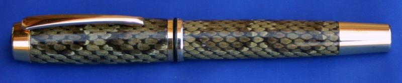

Here is a pen made from one of the gent blanks I posted earlier in this thread. Comments welcome. Thanks for looking.

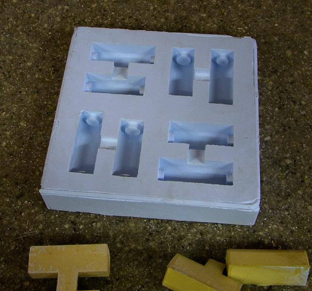

Resin Saving Molds
/quote... I think I'm going to get one of Charlies molds .... end quote
I was reading through many of the threads and kept noticing the mention of these molds. I am currently useing some plastic that is only good for 2 or 3 if cleaned real well. I was wondering where I cold get more info on these molds or the others mentioned as "Resin Saving Molds" ?
Thank you so much for your time,
Dana
I have some molds that have built in stoppers and I really like them.:wink::biggrin: They save a lot of resin compared to the molds I used on the blanks above. I just don't have those special molds for the gent size tubes.
Seriously? Can you post some pics? Did you make your own molds with silicon?
I didn't make my own molds. I purchased molds from NewLondon88. He call them resin saver molds. Contact him and he can show you what he has available. I tried to find some pictures on the forum but had no success.
I can't believe I don't have more photos than this .. but then if you've
seen one, you've seen them all. (mostly)
They're pretty simple.. they fit the particular pen kits and any kits that use
the same tubes. Pop in the tubes and pour.

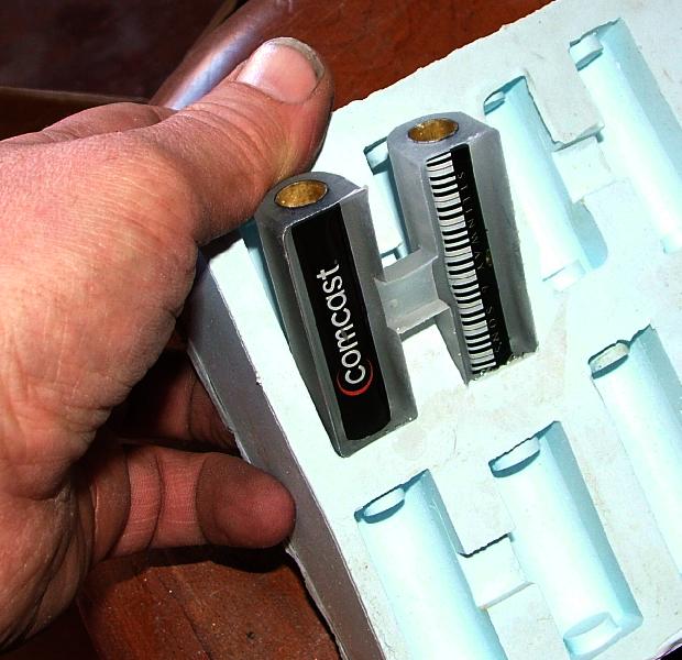

I've been unsing NewLondon88's resin saver molds for awhile now. I have the molds for the jr gent, gent, baron, cigar, and sierra. Not one leak...not one. But, I've stopped using pressure and vacuum...as is the topic of this thread.
Tonight I poured 4 sets of jr statesman blanks, 10 sierra blanks, one slimline set, and one cigar set...used 14 ounces of polyresin. Talk about resin saving! :biggrin::biggrin: They were all snakeskins blanks and the 10 sierra and 4 slimline sets I made last night look great. I'll post pictures tomorrow evening.

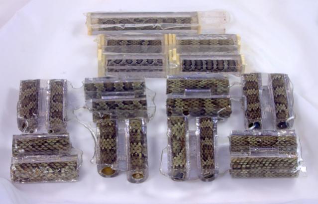

Here is the promised picture:
Don
Yep, and saving resin. That's only half of them. I just didn't see a need to post a picture of all of them.
