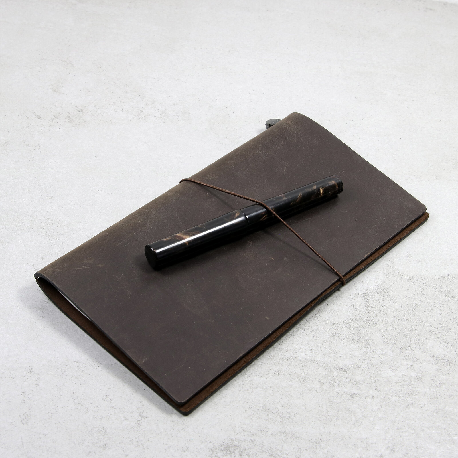

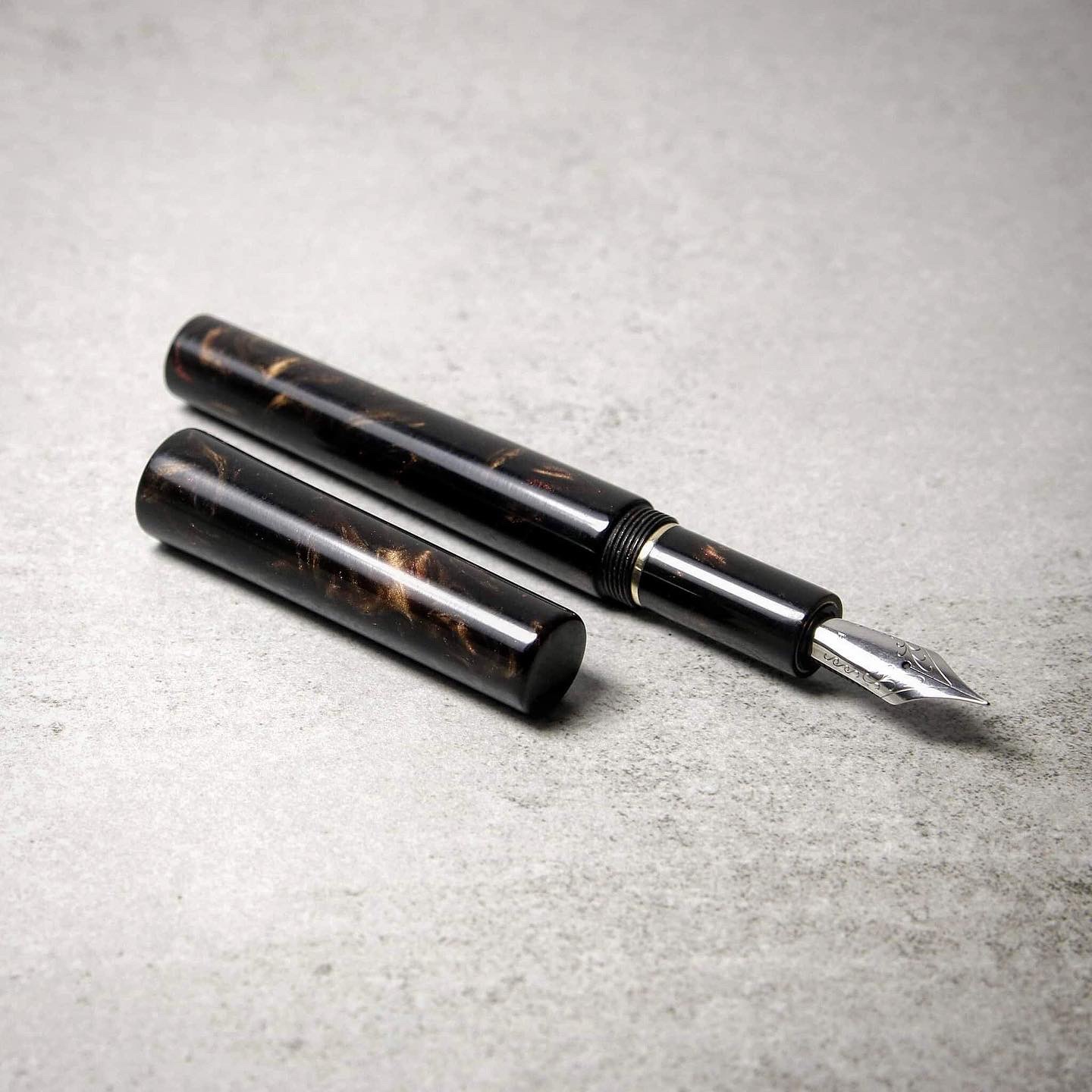

I was gone a little. Nevertheless, I come back. Two important things, actually three:
1. Beautiful resin came out
2. First encounter with a three-thread tap - it's great.
3. I have serious problems with cleaning threads - do you have any patent for this activity?
And finally a pen - kitless.

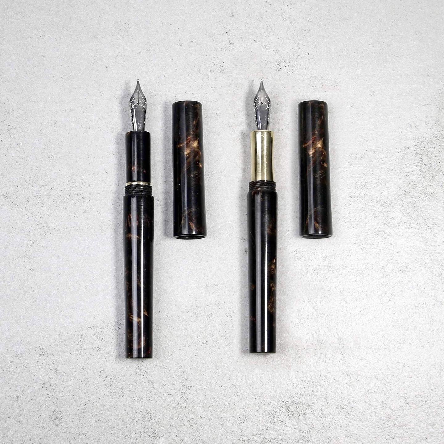

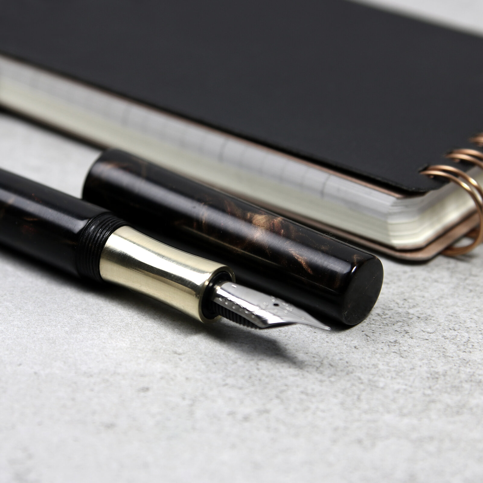

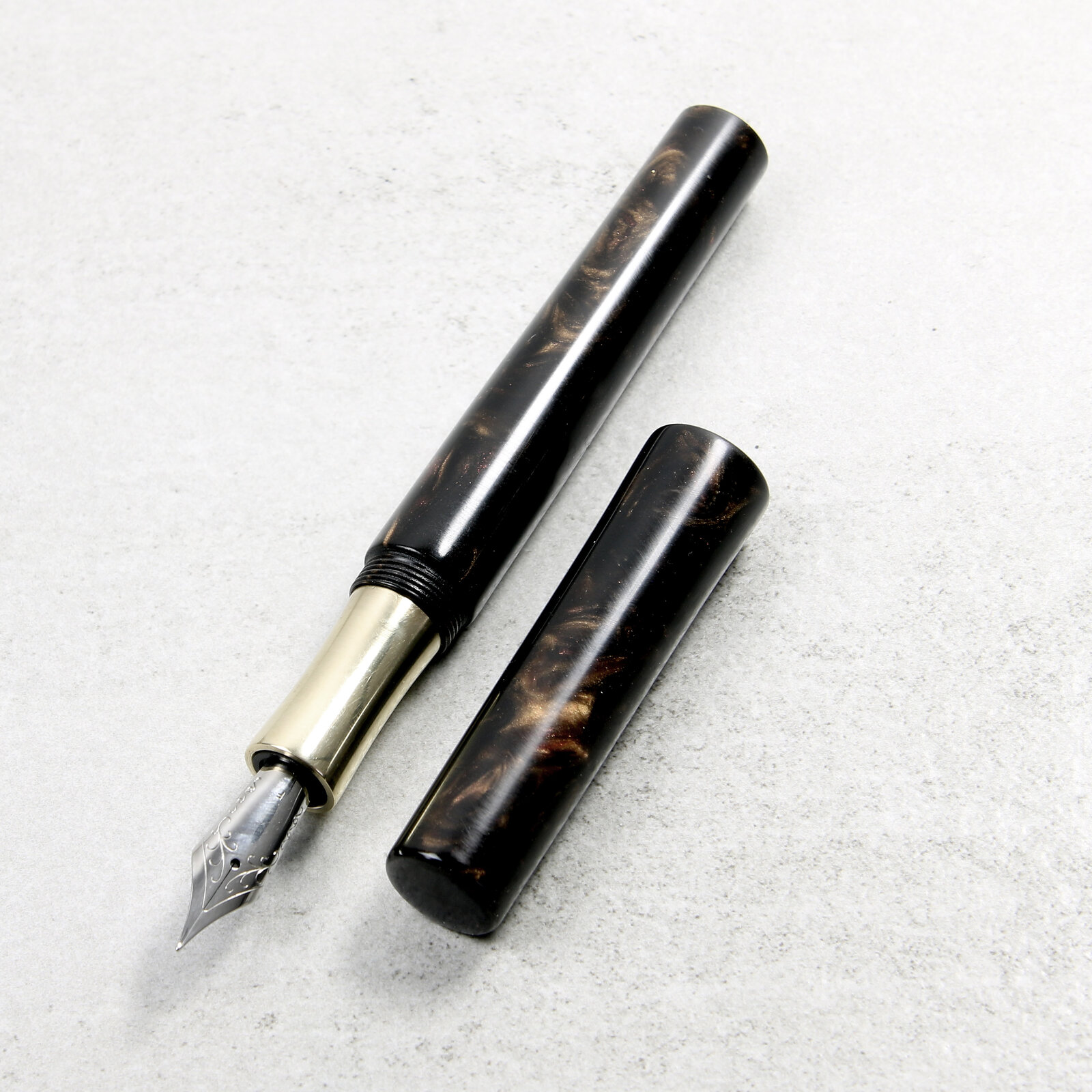

Change of concept on the look of this pen. The section is the same color as the rest of the pen with a small brass shade. What do you say? Which one is better?
One way to get slightly prettier threads is to sand/buff the tenon prior to cutting the threads. Also, after cutting the threads, put a little polish on your die and run it up and down the threads a few times to polish them up a bit.
