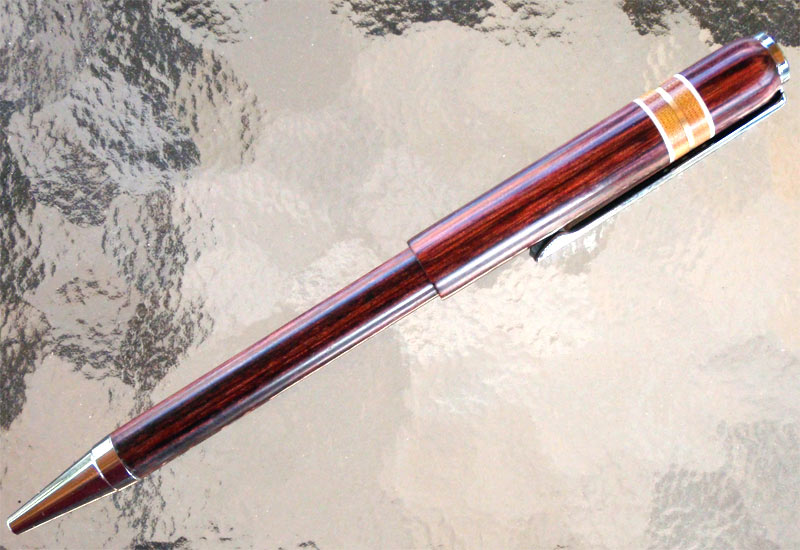

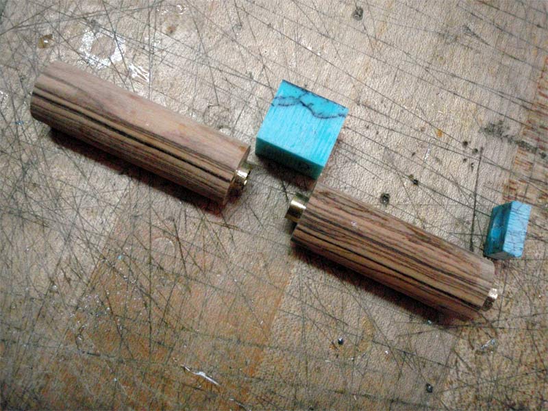

Now you can own that style by making your own custom center bands and adding an accent band to the top.
The possibility's are limited only by your imagination.
It is really not that hard.
Here is a photo of how I do most of my slimline center bands.
Glue the center band only to the top or bottom blank ... not both.
You should get it from the photo but if you need further clarification just call or PM me and I will be glad to help you.
After the center band and ring is glued on turn the pen as normal.

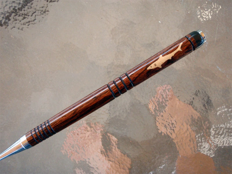

Score in some small rings and color them in with a sharpie before you sand and finish the pen.
See the shark pen photo as an example for the rings.

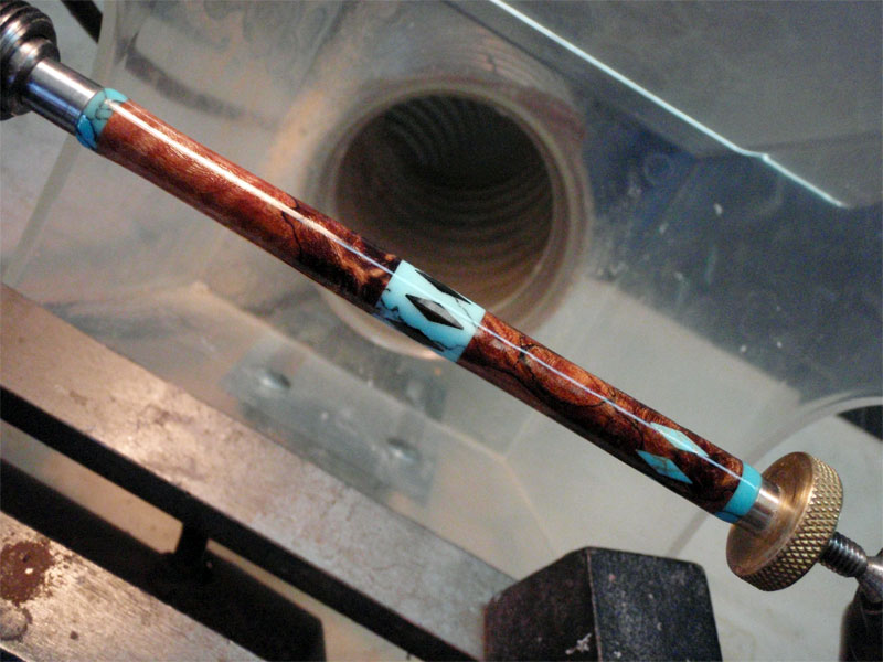

The pen on the lathe is an example of how the pen is mounted on the mandrel for sanding and finishing.

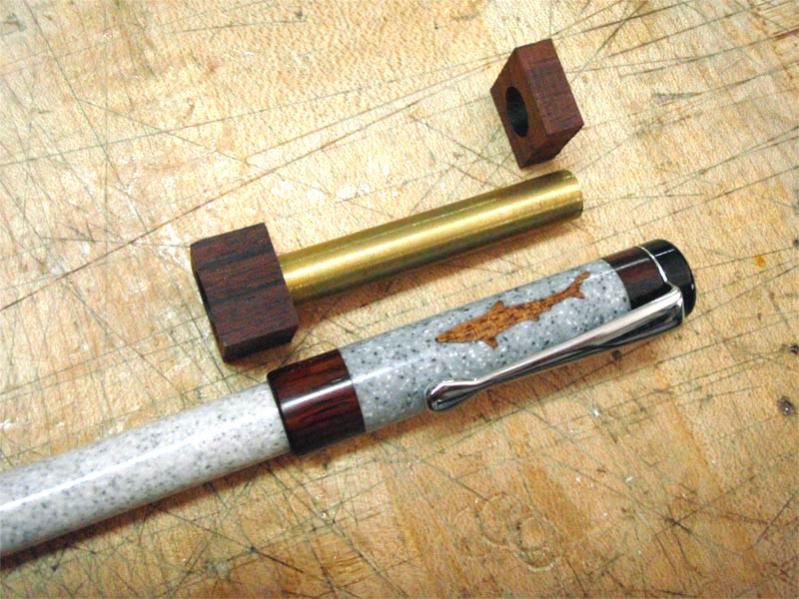

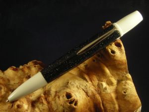

Another example ...
I make these up for the American Classic style pen so when inspiration strikes I can rough up the cap blank before my Muse gets off duty.
The photo shows it all.

Wow, nice willee. I have never been a slimline fan. Made my first 3 pens as slimlines and haven't made one since. However, your shark slimline in the dark wood with the rings is awesome, very nice pen. I might have to try that.
Willee
Jul 19, 2007
365
Corpus CHristi Texas

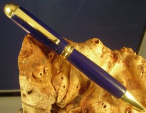

Peter, a slimline pen is what you make of it.
Think outside the box and try something different.
You will be surprised as to how many different looks you can get from that one humble kit.
On this one I just cut the top blank a bit longer and fatter, then drilled out the center band area so the bottom barrel would fit up into it.
I did use the original kit ring as a spacer to lengthen the pen but it is up under the cap where you can not see it.
