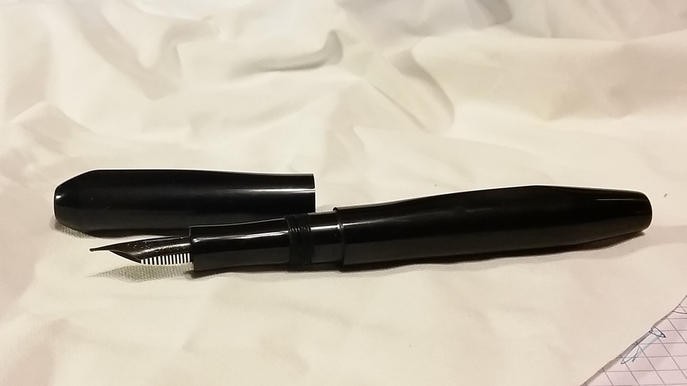

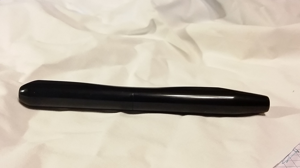

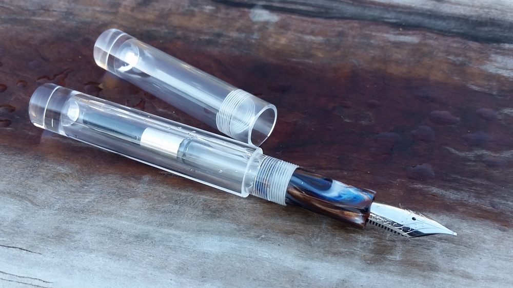

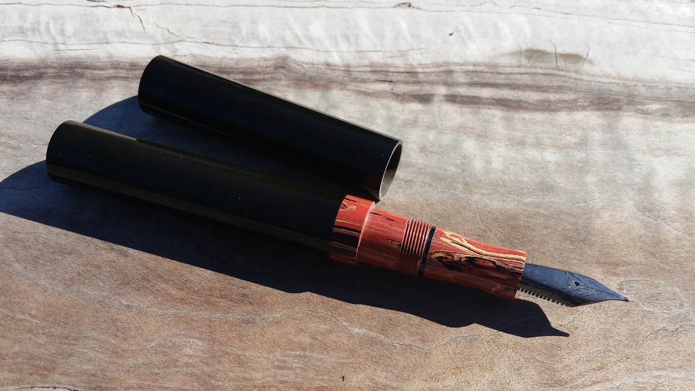

Introducing a new model I'm calling the Breaker. It's mostly hand sculpted with the lathe off. Lots of work and hand finishing going into this one. I have so much fun making it. :)

Great work Shawn. Do you mind telling us more about how you hand sculpt your new Breaker pen? Is it mostly with sand paper or do you have some special tools?

Okay, Shawn, I give up. I usually try to pick a favorite, but I can't narrow it down among several of these, I really like the non-standard shapes AND the peek-a-boo hint of color with the beautiful sections. The transparent work just blows my mind - the finish, inside and out, must have taken many hours.
Congrats on the whole collection!:)

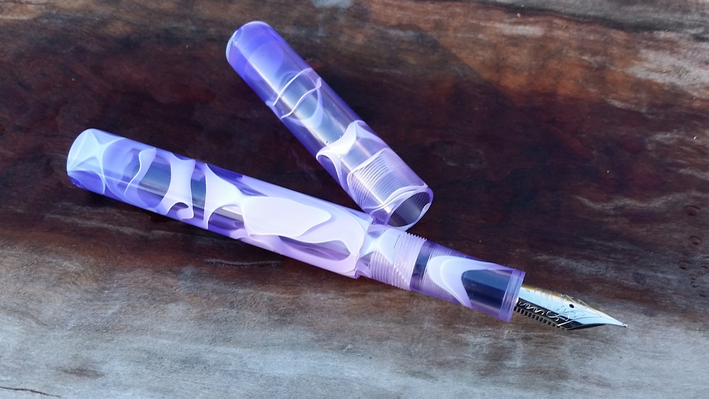

BTW, in the group of pictures 5, 6, 7, and 8, how many distinct pens are there ? . At least 3, I think; maybe 4 ?

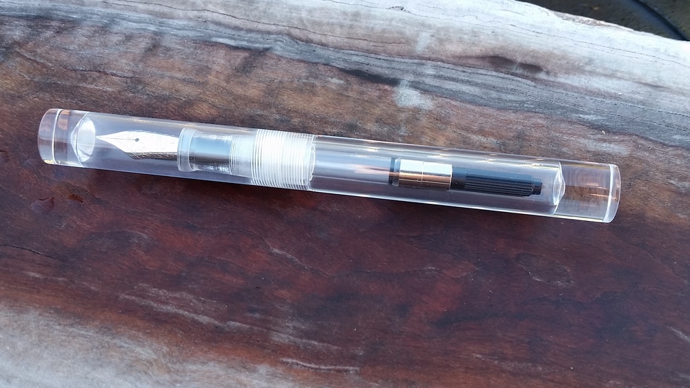

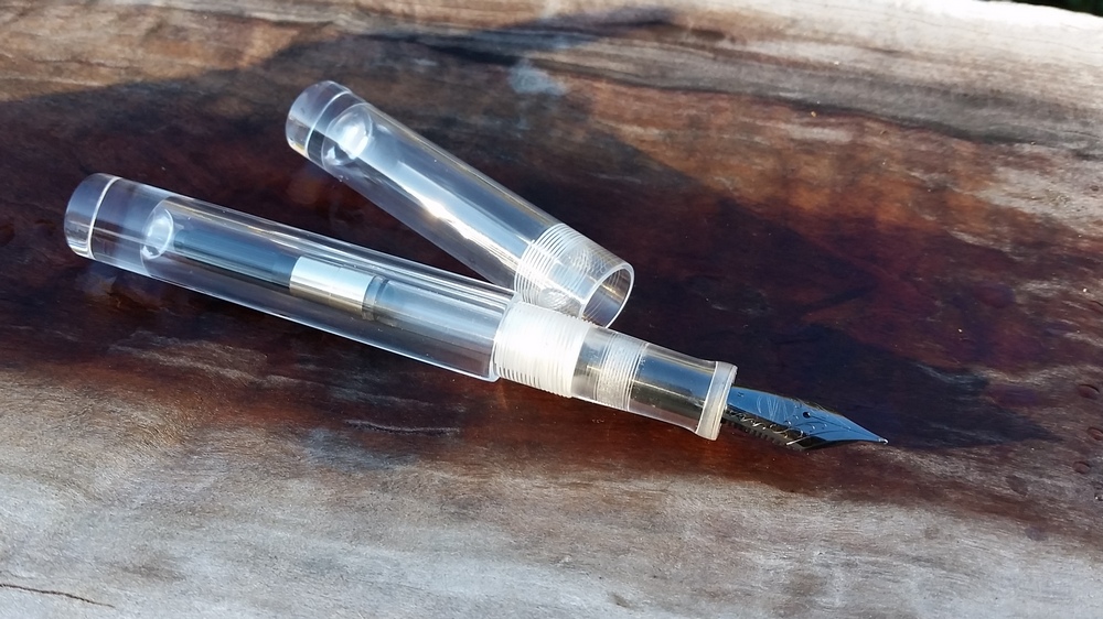

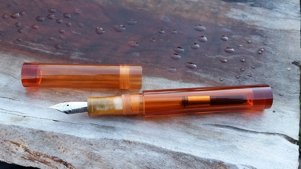

Wow, there is quite a bit of skill on display here! How do you finish and polish the insides of the barrels?
I use a split mandrel with sandpaper in it. I hold the mandrel in the chuck and go through a bunch of grits, then polishing compound with a rag in the mandrel.
I use a file for the most part. Not as aggressive as a rasp, but a little more aggressive than your average bastard file. Then lots and lots of sandpaper.
Thanks! Yes, lots and lots of hours. :)

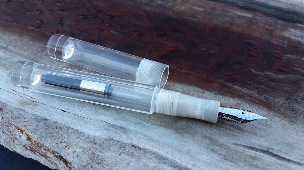

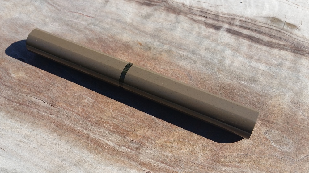

Astounding work !!! . I have returned to look at these several times.
There are 11 separate pens in all of those photos.
