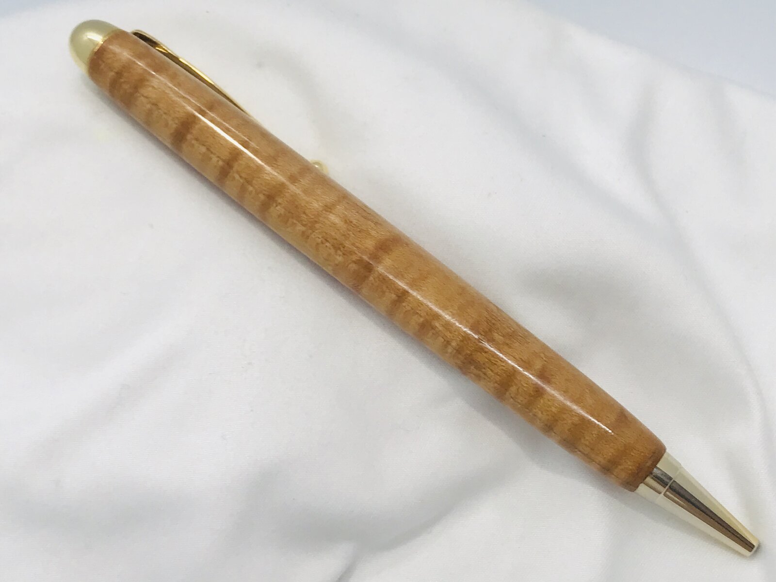

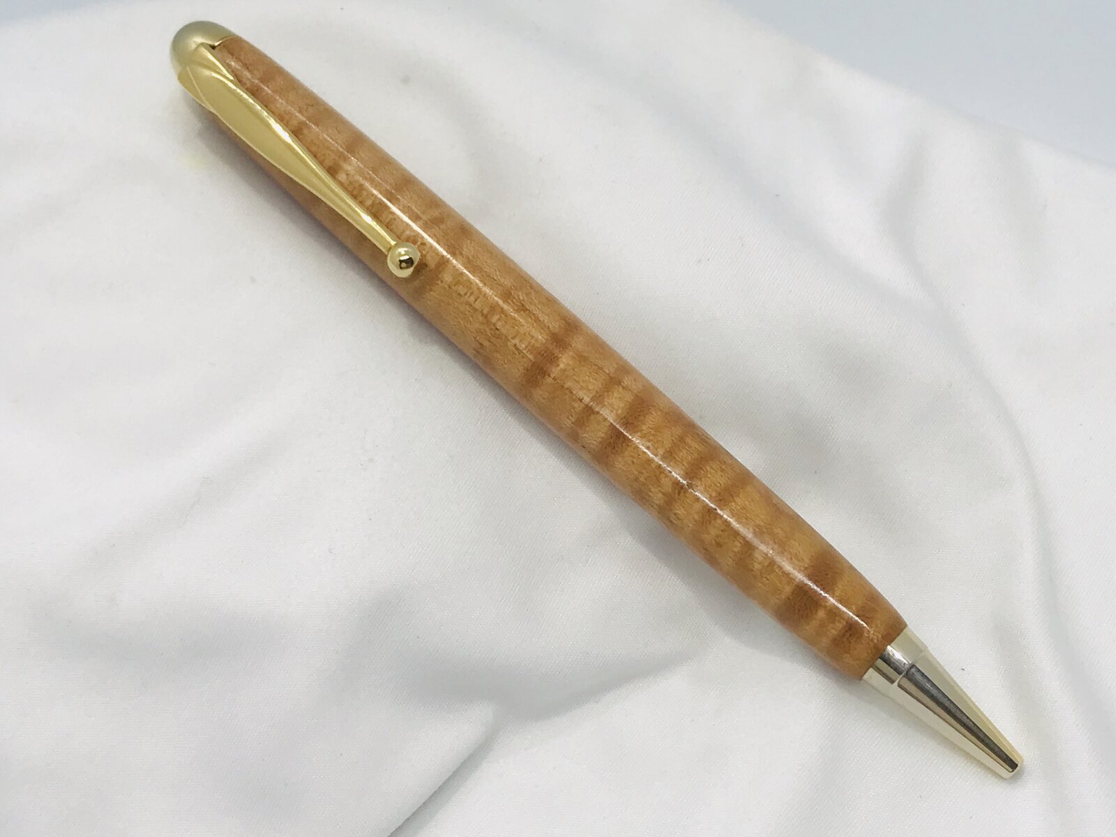

I decided to try my hand at a One Piece Twist Pen. Attached are a few photos of the result. Biggest issue was boring thru the ~4.25" blank. Lots of issues there, but worked thru them I think. I have ordered a longer 7mm Parabolic Flute Pen Makers Drill Bit which will only partially solve my problem. The throw on my lathe tail stock quill is only 2 1/4" with the MT2 on the Jacobs Chuck taking up 1" of that. My drill press is likewise limited to a 2 1/4". I'll get 'er done, one way or atother.

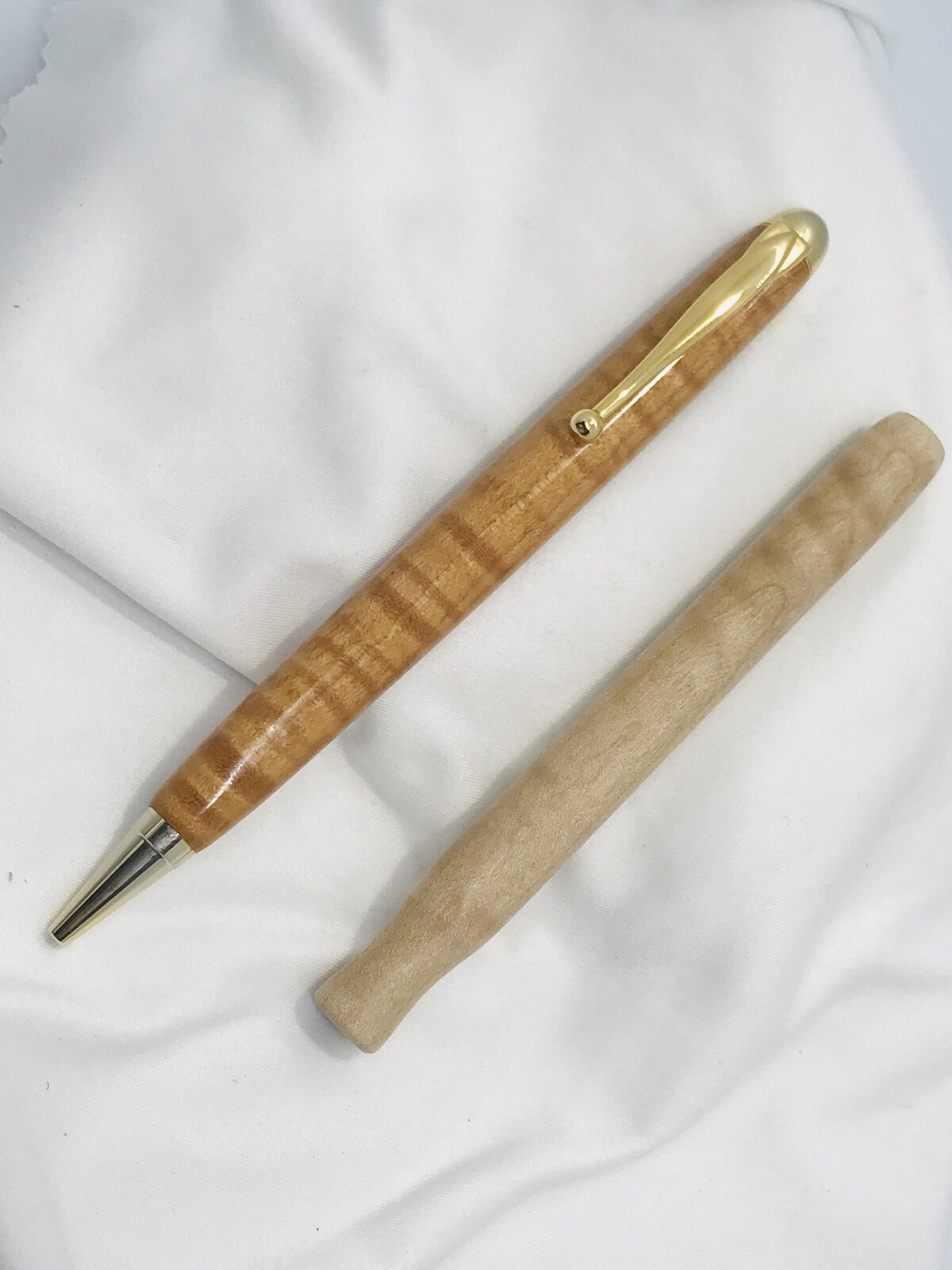

The blank is from a stash of figured maple I've had for some number of years. Pen was partially wet sanded (MM grits) using Mahoney's Utility Finish - 320 thru 800 were dry sanded. After final MM, I put on 3 coats of Pens Plus. The Mahoney's and the Pens Plus slightly darkened the timber. 3rd pic is my second attempt at a 1 piece which is yet to be finished. This shows how the choice of finish darkened the timber. As always all comments, especially those helping me improve are welcomed.

Nice job! I have been doing one piece pens for about 8 years. Mostly I use SlimLine and European kits. I got the longer bit and it made all the difference.

I used a StreamLine Round Top for the completed one. The second one will have the flat end cap from a StreamLine FlatTop. Combined, I have over 65 of these kits - gotta use them somehow. At shows, they are different from the run of the mill, so maybe they'll sell.

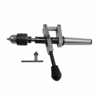

Ive not seen one with a 1/2" chuck but 3/8 is pretty common. They're generally used for high speed drilling with small drills into metal but no reason why they shouldn't be used for our purpose. No , as yet I haven't got one as it's on my to make list but several acquaintances do have them and are impressed with accuracy .You can buy the attachment WITHOUT a chuck , just with the arbor and attach you're own chuck of whatever size . Indian sourced ones offering this were, until recently , fairly commonly listed.
Hang fire and as this covid situation resolves they will no doubt come back.
JT
interesting. Never seen these. Thanks.
