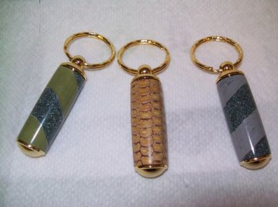

I also acquired a large supply of corian. They have been selling well for me as stylus pens.
I have been making the "hidden pill compartment" key ring using different colors of corian. The hide the glue line, I glue a piece of aluminum coke can between the corian. So far, that's been working very well. Just med CA and clamp. Drill the hole slowly with a sharp drill bit to avoid the segments separating.

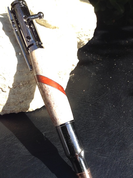

Welcome Denise! Pen turning is an amazing hobby that allows for a ton of creativity. Here's a pic on one of my Deer Antler pens where I used some thin Aluminum around some Padauk for accent. On your Corian - perhaps this might work. Good luck and welcome to IAP!

These are BEAUTIFUL and kind of what I had in mind with mixing and matching the Corian. THANKS for the inspiration!!! I have some of the hidden compartment key rings on order and are waiting for them to arrive. :smile:

WOW that is beautiful and so rich looking. How does the antler turn. Is it easy or hard? Is there any special prep work to the antler? May have to go out on a hike when the snow clears and find a piece of antler.
