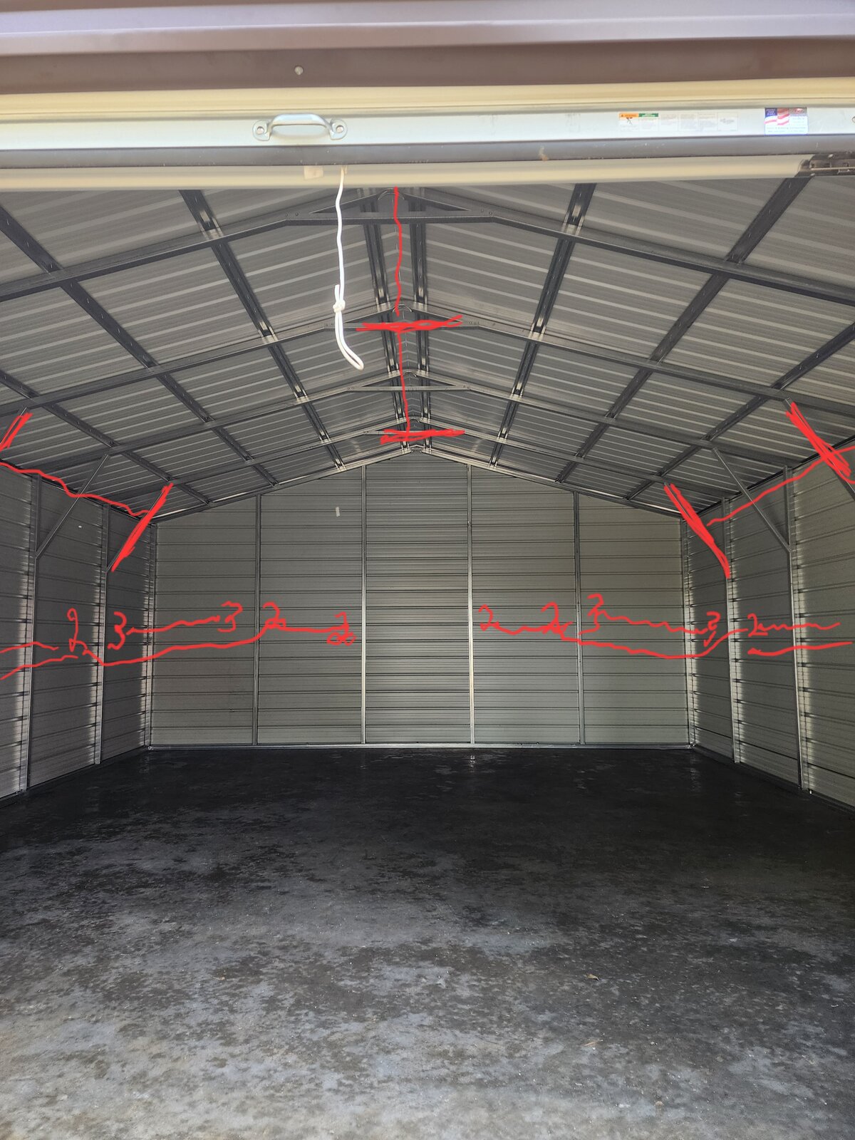

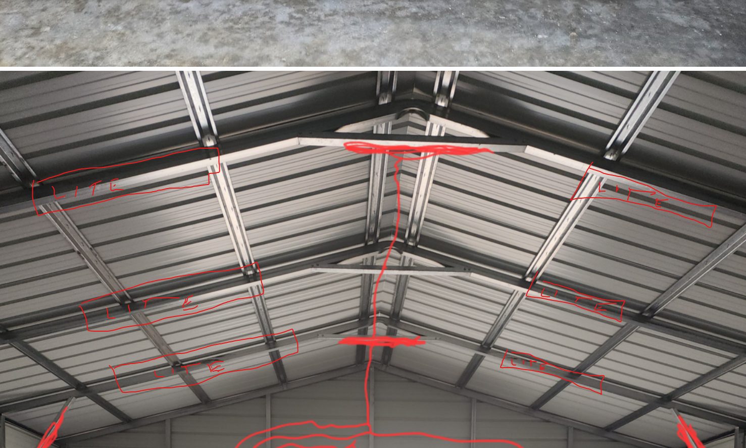

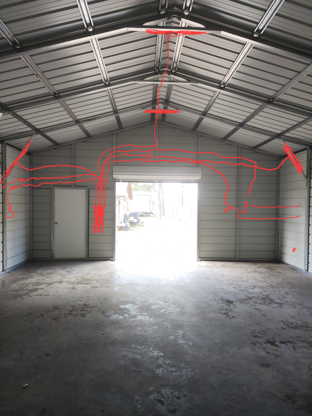

Ok, so the structure is not what I envisioned it would be. In order for me to eventally put walls over wiring and insulation I will have to run my electrical in the siding grooves around the building. I know the pictures are a little crude but here is my plan. I will have my panel between the walkin door and rollup door. I will have to drill holes in the tubing above it to be able to take romex around the sides of the shop. I will be putting a 20amp and 30amp on each side tubing.
1. I will run 3 circuits for lights. The long red lines on the ceiling and sides are where lights are going. 3 lights down the center - 1 circuit, and 3 lights angled at the sides on each side with separate circuits.
2. Run one row of 20amp outlets on each side of the shop. Each row is separate circuit.
3. Run one row of 30amp outlets on each side of shop. Each row is separate circuit.
I'll have to figure out 220v last.
Also, reason to run the 3 light rows on separate circuits is to only use the ones I need.
Anyone have any better ideas?
They makes these things that are called switches :) Just can not see the need for 3 lighting circuits in a little area like that. 60 amp service in there will get eaten real quick when you split all those outlets. No room for add ons later. Just saying. Not what I would do.
Lol John, That's why I'm looking for ideas. I guess the newer led lights would probably run off one 20 amp circuit? That will be 9 lights I'm gonna install. The braces are 4' but thinking 36" lights are probably all I need for that many. I like the idea of the side lights being on the angled brackets so I don't shadow the center ceiling lights.

If my entire 3500 sqft house lighting load plus other essential loads will run on a single 20a breaker, listen to John. You could be over designing things.

My thought is you are more in need of a working layout plan than one of electrical at this point. To me I am thinking 6 8foot lights running east to west. One on each slope of roof. (3 rows ) More than enough light. With that metal supports you could use a number of fasteners including adding some unistrut to spread the lights more evenly. I would not put lights on those angle brackets and keep the lights as high as you can. Not sure what you are planning for ceiling and walls but you could just mount lights to whatever you put on ceiling. You need to have a plan for all your tools and tables because you may find you want more outlets on one wall than you need on another. You want to try to avoid extension chords to tools if possible. I suggest either an outside outlet or one close to the door so that if you work outside it is easy to grab power. As mentioned an outdoor light of some sort with motion detection so if you walk out or work late and it get dark you want lights. I would have a batterybackup emergency light mounted somewhere to get out safely in case of power failure. If you find you need more lights at certain work stations they make all sorts of add ons that can be hardwired or plugged in. But work on general lighting first. Without physically having working dimensions in front of you it is hard to visualize things. That is why alot of this will depend on your thoughts.

Don't need outdoor lighting. Well my last shop had separate circuits for 3 sets of lights. They were fluorescent lights. I just looked up amp usage for different size led lights. I never realized they used soo little amps. Ya, I think I'll tie them into one circuit just run the 3 runs off light switches.
My thought is you are more in need of a working layout plan than one of electrical at this point. To me I am thinking 6 8foot lights running east to west. With that metal supports you could use a number of fasteners including adding some unistrut to spread the lights more evenly. I would not put lights on those angle brackets and keep the lights as high as you can. Not sure what you are planning for ceiling and walls but you could just mount lights to whatever you put on ceiling. You need to have a plan for all your tools and tables because you may find you want more outlets on one wall than you need on another. You want to try to avoid extension chords to tools if possible. I suggest either an outside outlet or one close to the door so that if you work outside it is easy to grab power. As mentioned an outdoor light of some sort with motion detection so if you walk out or work late and it get dark you want lights. I would have a batterybackup emergency light mounted somewhere to get out safely in case of power failure. If you find you need more lights at certain work stations they make all sorts of add ons that can be hardwired or plugged in. But work on general lighting first.

Last larger building I did new the math worked out to 16 lights on one 15 amp circuit using 16 gauge wire. I did not use that many but the amp draw on lighting load is tiny these days.

Do not bring the lights down at all. Mount to the bracing that is there. Lights are up to ceiling. I drew on your drawing where I think they would work well, but you could always move them to inside those main supports. Even spacing if possible. See you say you fixed on certain amount of outlets on each wall. But if you have a workbench against the wall, maybe you want an outlet box on both ends of the table instead of the middle. I ran plugmold and makes for easier access to outlets. I did this on fixed tables and also my movable one
I seen your locations John. That looks good also. The number of lights may come down to price also. I'm not sure where the placement of any of my tools are going to be at this point so just wanting to make sure lighting will not be an issue anywhere in the shop. I also have a couple 10 outlet strips that I keep for the shop. I also have a few 6 outlet strips for under shelving so I can plug overhead if need to.

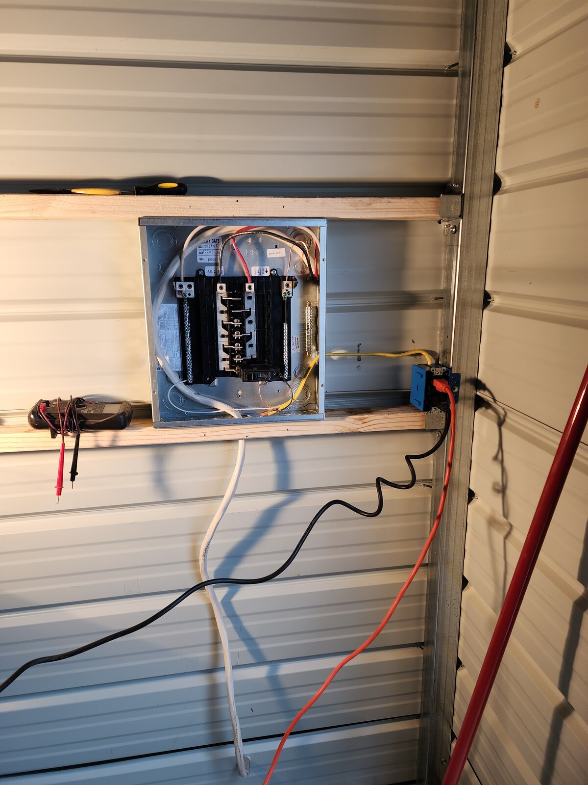

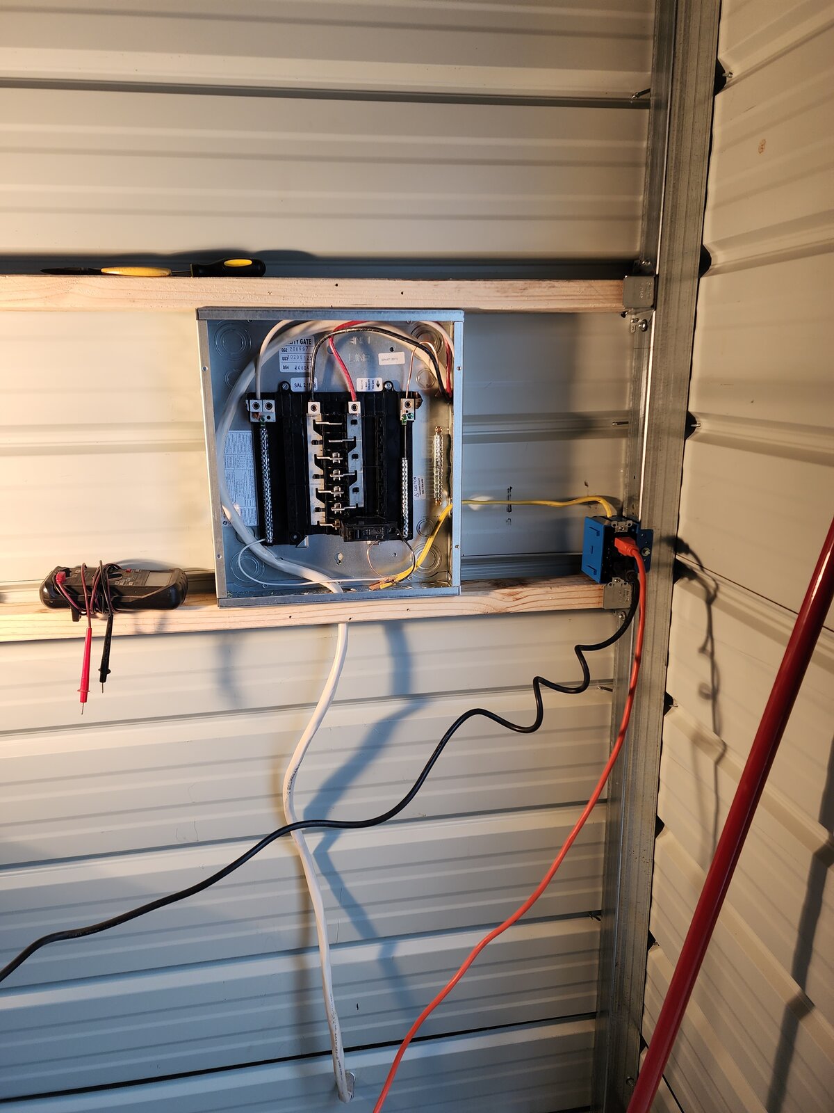

So I just finished burying my service from the house to the shop. Went ahead and threw a cold water line in my trench also just in case I can put in a hand washing sink. Lol Put in one outlet so I can have lighting for the rest of the work. Found out my old GE breakers that I had didn't fit the new panel so gonna have to get a 50amp main, couple 30's and a couple more 20's. It's a start anyway. Lol
OH boy. You need to wire this as if you were going to sell the house and the panel goes with the house. It would need to pass code if selling. I think you should contact Jeff and talk to him about your install. He seemed up on all codes and is knowledgeable. I do not want to get into it but a few quick things. Where is the Main? Always use a connector when entering a panel. Do not run all that romex insulation within the panel. Cut it at the connector when you enter in panel so that you have the wires only in the panel. Allows for more room and neater. Use proper connectors for that type wire. You have the ground wire in the wrong place. It should be on the ground bar that is attached to the box. Jeff will explain to you how to wire your ground in. (New Code) The 2 terminal strips are for neutral wires. Without being able to see the inner working of the panel the 2 lugs on the top of left bar are so you can put a jumper to the other strip on the right if you are going to use it. What normally happens is what wires are landed on the left side breakers keeps the neutrals on same side. This goes for right side also. Makes for a neater job and easier to follow if need be. Always good to leave extra wire in case you need to move from one breaker to another. Good luck. One other thing are you plan on covering the walls and the outlet boxes not exposed? If not you need to use proper boxes.
